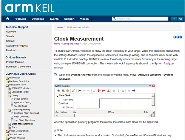

Debugging with System Analyzer in Cortex M0
As again; the clock measurement feature works only for Arm Cortex-M3, Cortex-M4, and Cortex-M7 devices and not for Cortex M0.
Fig: No clock Measurement can be seen here
Fig: Again Not supported for Cortex M0 in System Analyzer
