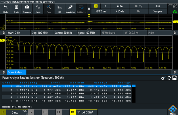

Spectrum analysis of the Output voltage
The settings to measure are as below. The Vin = 12V and Vout = 0.8V of the DC/DC TPSM84A21 Power Module. The frequency measured of the output signal is as measured above is 2MHz
Fig: Settings for spectrum analysis
Fig: The spectrum output for Vout = 0.8V
Fig: Detailed look into the measured data
The minimum horizontal measurement setting for RTM 3004 is 8MHz hence the spectrum behavior immediately after the switching of the device cannot be analyzed here as it is around 2MHz.

    I don't know much about spectrum analysers (never having used one), but don't you need to set a RBW of much lower than 4MHz to pick out a 4MHz fundamental and its harmonics sensibly? The RBW defines the resolution, doesn't it?
