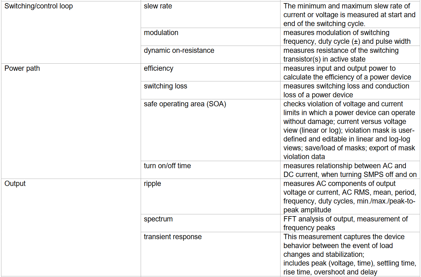

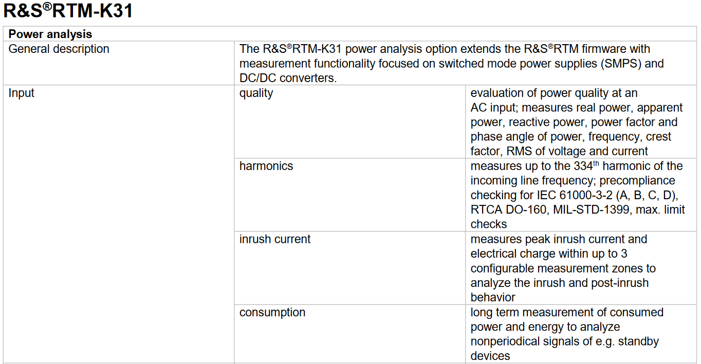

The R&S RTM K31 Power Analysis bundle offers different options to measure input and output of (Switched Mode Power Supplies) SMPS and DC/DC Converters. The TPSM84A21 Power Module is a high current DC/DC converter. The power analysis of the DC/DC converter is presented below.
Fig: R&S RTM K31 Power Analysis bundle offers

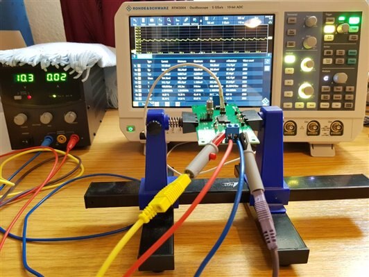

Setup of the TPSM84A21 Power Module
Fig: Test setup for the Power Measurements
Measurements with the TPSM84A21 Power Module

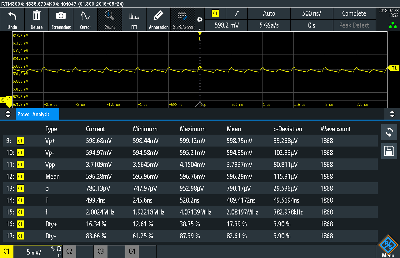

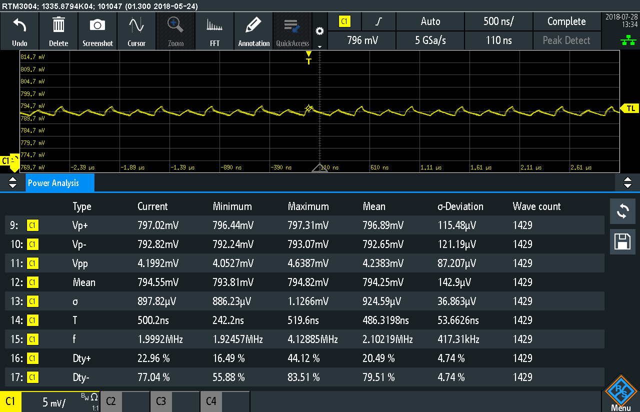

The below measurements were done using the automated power analysis tool in the RTM 3004 with the DC/DC TPSM84A21 Power Module.

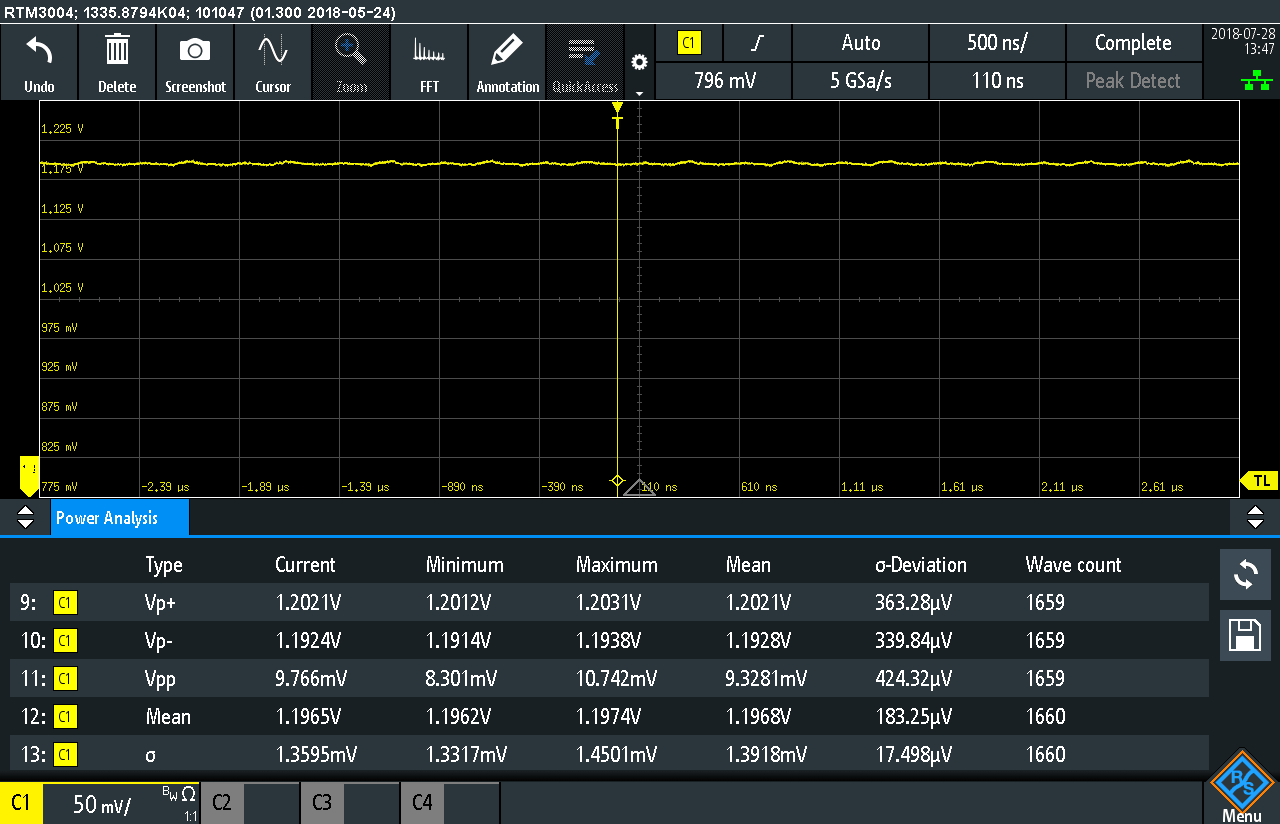

The aim is only to present how this automated button of power noise ripple works and the below mentioned tests were done with no load in the DC/DC converter output.
Fig: Power Analysis of the 0.6V output of the DC/DC TPSM84A21 Power Module
Fig: Power Analysis of the 0.8V output of the DC/DC TPSM84A21 Power Module
Fig: Power Analysis of the 1V output of the DC/DC TPSM84A21 Power Module
Fig: Power Analysis of the 1.2V output of the DC/DC Converter Module
Fig: Power Analysis of the DC/DC Converter

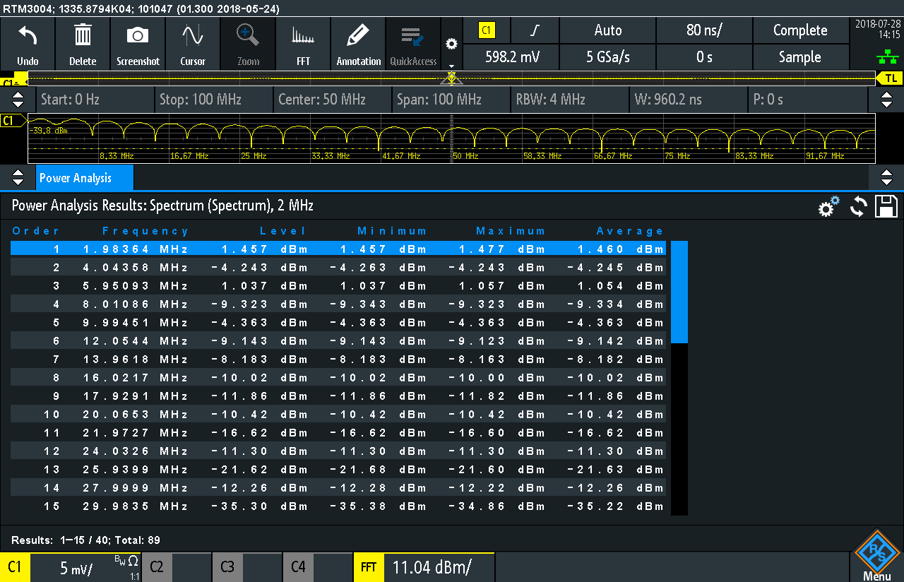

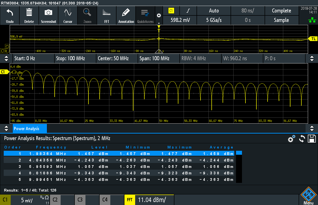

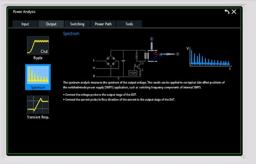

Spectrum analysis of the Output voltage

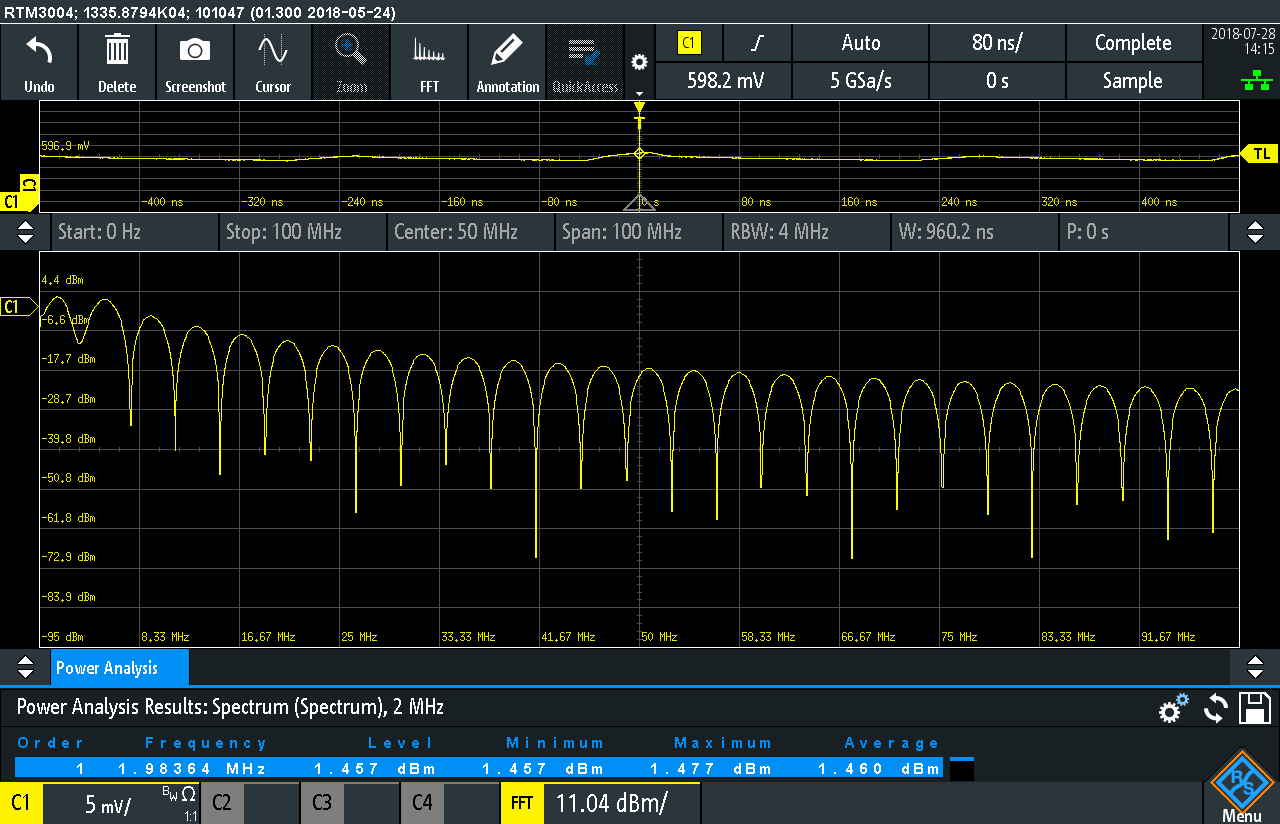

The settings to measure are as below. The Vin = 12V and Vout = 0.8V of the DC/DC TPSM84A21 Power Module. The frequency measured of the output signal is as measured above is 2MHz
Fig: Settings for spectrum analysis
Fig: The spectrum output for Vout = 0.8V
Fig: Detailed look into the measured data
The minimum horizontal measurement setting for RTM 3004 is 8MHz hence the spectrum behavior immediately after the switching of the device cannot be analyzed here as it is around 2MHz.

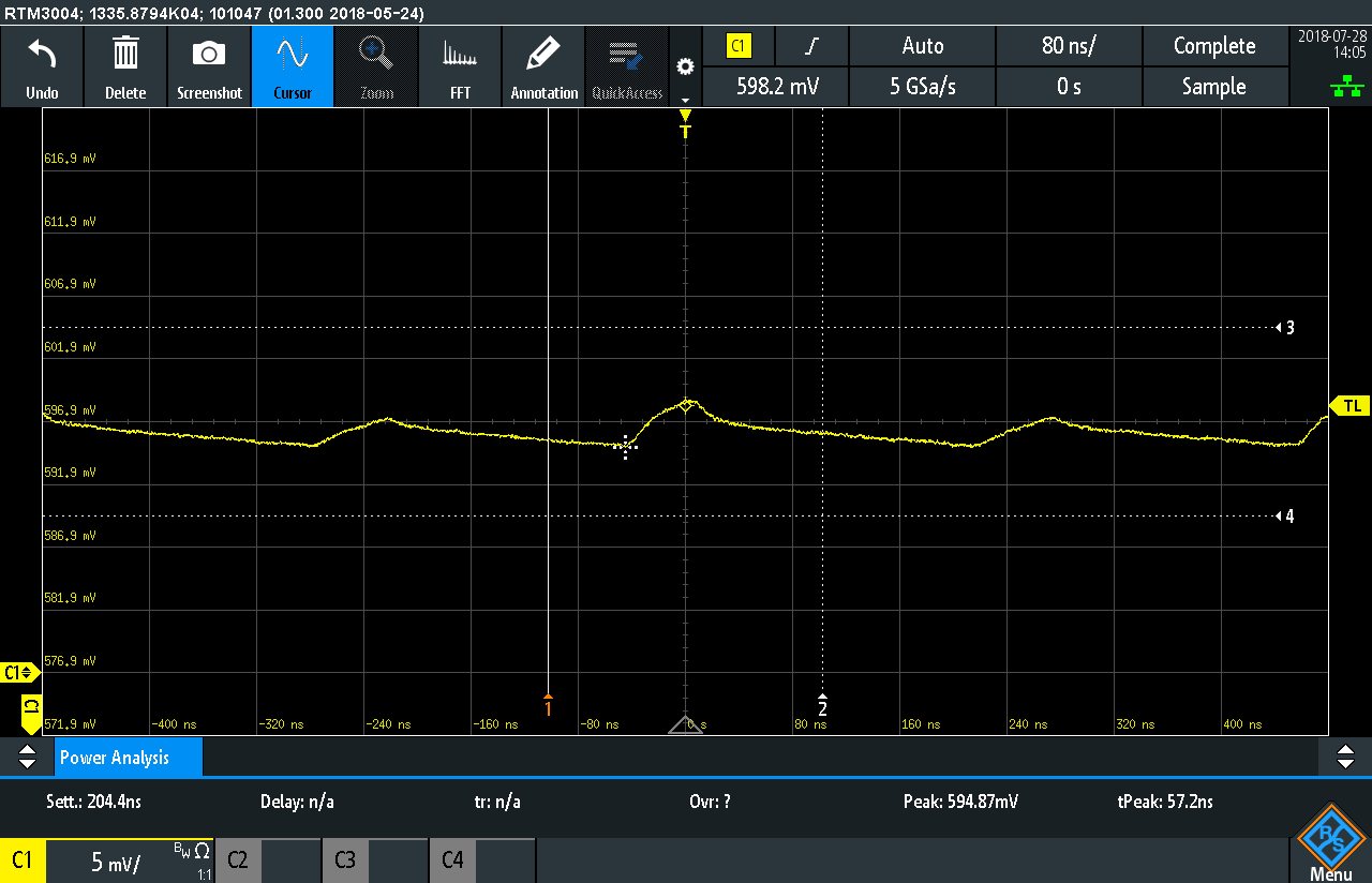

Transient Analysis of the Output voltage
Fig: Measuring the transient response on the output signal for Vout = 0.6V

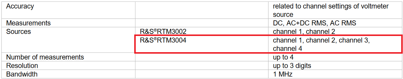

Measuring with Digital Voltmeter in RTM 3004
Fig: DVM features of RTM 3004
Below, the DVM can be seen live in action and measuring the input signal voltage of the DC/DC TPSM84A21 Power Module.

    hi Jon jc2048 wrote: With the transient test, what was the transient that you were measuring? Did you have a switched load on the output? The results look much too good to me (although a 4MHz converter…

    With the transient test, what was the transient that you were measuring? Did you have a switched load on the output? The results look much too good to me (although a 4MHz converter is going to be fast, you wouldn't expect the control loop to recover things that quickly - a rough 'rule of thumb' is that the control loop bandwidth might be something like a tenth to a twentieth of the switching frequency). Or were you just showing us how the measurement might work by simply letting it measure the rise time of the ripple?
    To answer the last question, yes the values are too good to be true indeed and that cannot be. As in my last roadtest with this DC DC Converter module I have power ripple in mV range so they cannot go down to uV range just because the scope changed. I went back and checked my test setup again and also my last road-test as well.
    And yes my aim was only to show how this automated button of power noise ripple works but I should mention it clearly in my blog that this test was done at no load which is also not the best idea. Thanks for pointing that out.
    And I will re-test the DC DC board with some loads this week as I am also curious to see if I will get any better results than my Rigol scope and what is the difference in the measurement with both the scopes.

    Hi Jon,
    jc2048  wrote:
    A couple of questions for you.

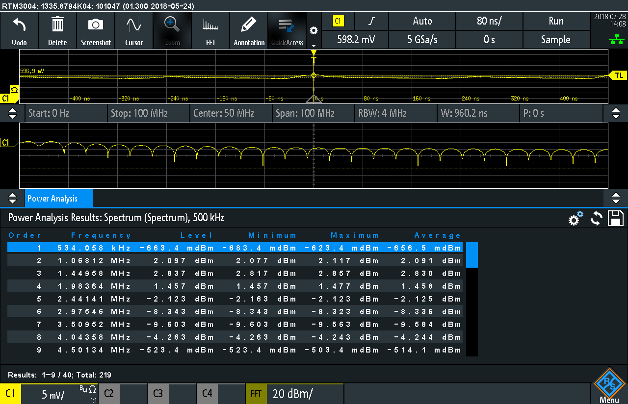

    I don't know much about spectrum analysers (never having used one), but don't you need to set a RBW of much lower than 4MHz to pick out a 4MHz fundamental and its harmonics sensibly? The RBW defines the resolution, doesn't it?
    yes indeed; hence I have mentioned it already in the blog below the spectrum analyzer measurements that the scope horizontal settings cannot be set below 8MHz on the minimum side RBW. I would have also liked it better if I could goto at-least 1 MHz on the lower side but thats not possible here.
    Reference in this blog:
    When seen at the power analysis spectrum values measured this can be set to lower frequencies. I have the results were I set it to 500KHz and 1MHz as well and did measurements but I did not publish it here but may be I should publish it as well as you look interested to see the values.
    I will publish it.
