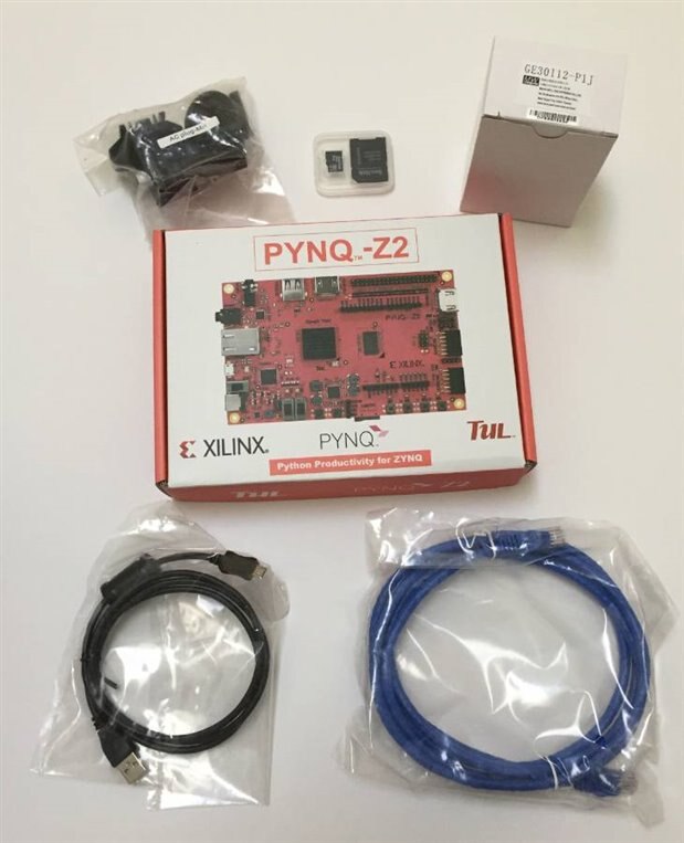

Just received the PYNQ-Z2 Dev Kit for the roadtest.  Thanks danzima for the quick shipment.
The kit contained everything needed to start immediately.
  • PYNQ-Z2 board
  • 12V, 2.5A Power supply with barrel jack and US and European plug adapters.
  • Pre-flashed 16GB microSD card
  • MicroUSB to USB cable
  • Ethernet cable

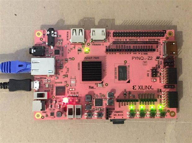

Because the SD card already contained the required image, I just had to connect everything and it booted up immediately.

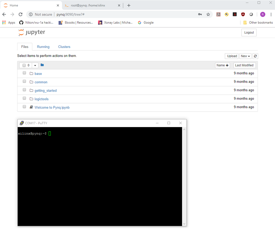

From the host PC (I'm running Win10), you just need to point your browser to the URL pynq:9090 to access the Jupyter dashboard.  They mention that the IE browser does not work, but I use Chrome and that works fine.
Since I have the USB cable connected to the PC, I can also open a serial connection - I'm using Putty (I overlaid the Putty window on top the browser window for the screenshot).

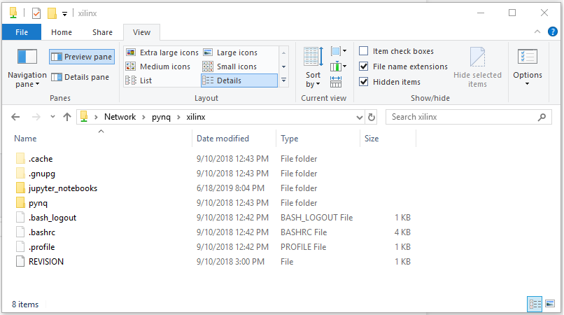

Samba is also running, so you can access the file system at network address \\pynq\xilinx.
