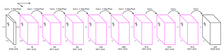

The network topology is shown below.  The pink colored layers have been quantized with 1 bit for weights and 3 bit for activations, and will be executed in the HW accelerator, while the other layers are executed in python.

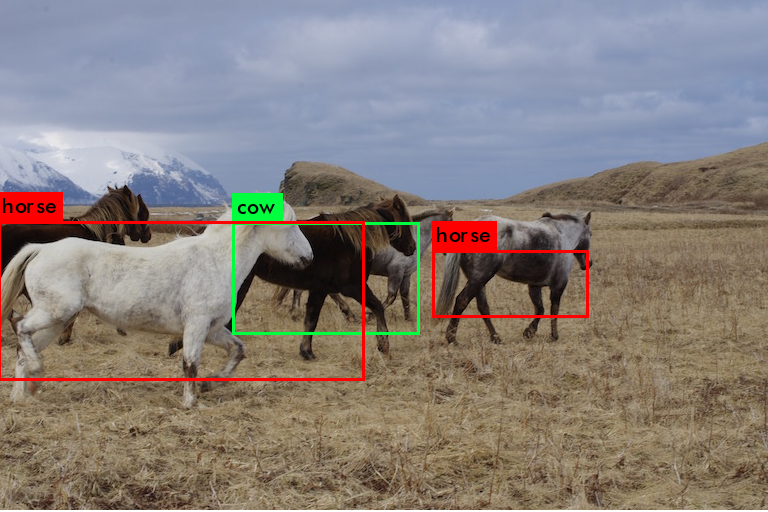

Sample image (horses)
The first image that I going to use is a provided sample image of horses (773 x 512 pixels)
Execution time:
  • First layer SW implementation took 594523 microseconds
  • HW implementation took 593735 microseconds
  • Last layer SW implementation took 68420 microseconds
Classification:
class: cow probability: 84%
class: horse probability: 74%
class: horse probability: 68%
Object detection bounding boxes:
The example shows the issues that occur with multiple overlapping objects.

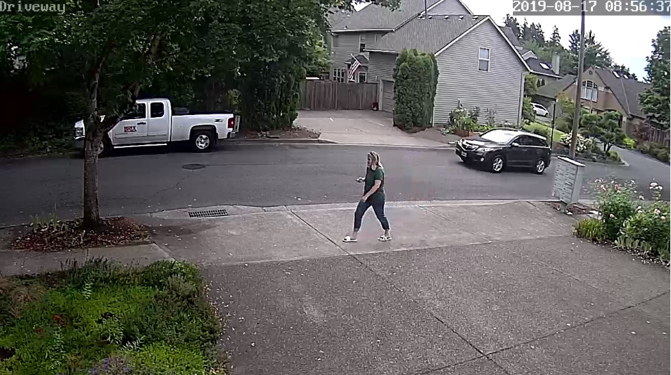

IP camera images
The application that I would like to use neural networks for is object identification in video streams from surveillance cameras.  As an example, I have an PTZ IP camera at the front of my house that is primarily used to alert me to deliveries (mail, Amazon, UPS, etc).  It is normally pointed at the driveway and mailbox, but the pan/tilt capability allows me to look up and down the street and also at my front door (270 degrees of coverage).  Currently, image motion detection and PIR sensing tell me when something is detected but I need to look at the camera video to determine if it is something of interest.  And needless to say, there are a lot of false detections.  I have 2 video sources that I'd like to analyze, the live fed from the camera and also stored video from a network video recorder (NVR).  I have multiple cameras, but I think it would be okay to require that each camera have dedicated processing hardware.
The PYNQ notebook examples that I've found either use the HDMI input or a webcam as a streaming video source.  For my application I need the ability to process an RTSP (Real Time Streaming Protocol) stream over ethernet.  I had hoped that I could just use the VideoCapture function in OpenCV, but I can't seem to get that to work.  I'm sure that I'll be able to get something to work, but for the purposes of this roadtest I'm just going to use static images from the camera (actually from the NVR).  I currently stream 2 resolutions from this particular camera (1280x720 and 640x480).  I'd like to use the lower resolution stream for processing if it doesn't degrade the accuracy too much.  I'm going to test that with the image captures from the NVR (the lower resolution captures from the NVR are actually only 320x176 - to allow for faster searching).  It turns out that because the detection grid is a fixed ratio to the image that the large and small images have about the same execution time.

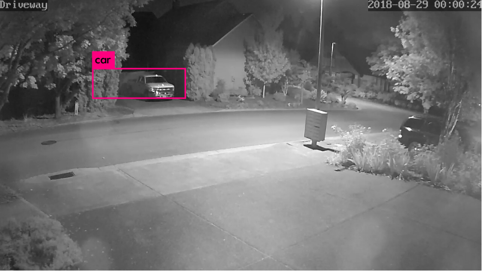

Night image (1280x720)
class: car probability: 30%
The car to the right is not detected.

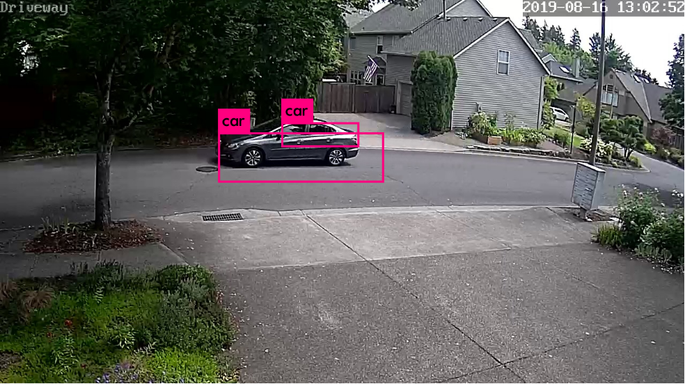

Day image (1280x720)
class: car probability: 86%
class: car probability: 34%
Multiple bounding boxes for the same image

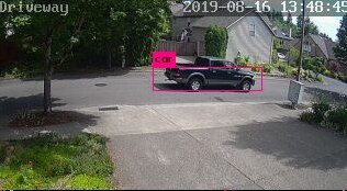

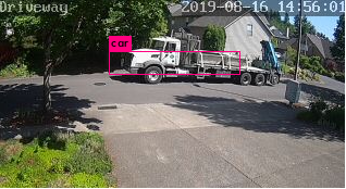

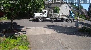

Truck image (320x176)
class: car probability: 79%    -- no separate class for truck

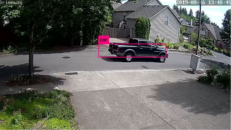

Truck image (1280x720)
class: car probability: 96%  -- improved classification with larger image size (better resolution?)

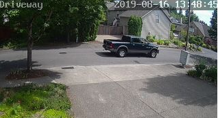

Different truck (320x176)
class: car probability: 63%

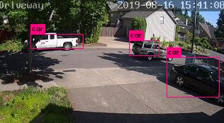

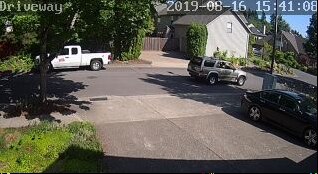

Multiple cars (320x176)
class: car probability: 60%
class: car probability: 47%
class: car probability: 33%
did okay with the shadows

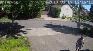

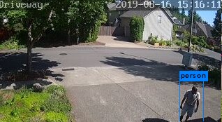

Me (320x176)
class: person probability: 42%

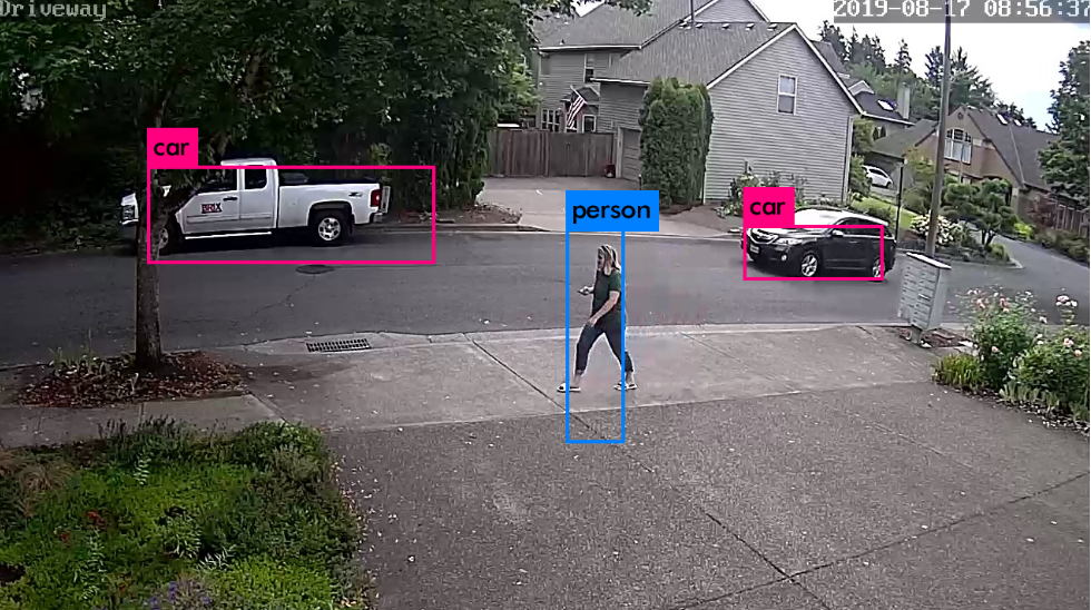

Multiple objects (1280x720)
class: car probability: 75%
class: person probability: 51%
Seems to have a harder time with people

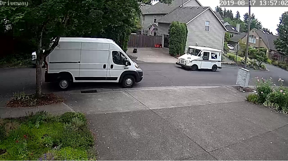

Amazon and Mail trucks (1280x720)
class: car probability: 99%
class: car probability: 35%

    Hi Gene, The classifier was trained with the PASCAL Visual Object Classes which only has the following vehicle classes: airplane, bicycle, boat, bus, car, motorbike, train. I also thought it was odd at…

    ralphjy over 7 years ago in reply to genebren
    Hi Gene,
    I also thought it was odd at first that it couldn't differentiate a truck.  Of course, I want to differentiate the UPS truck vs Amazon vs the mail truck.  I'm thinking because I don't have such a general purpose case that maybe I can figure out how to train with a small subset of vehicles.
