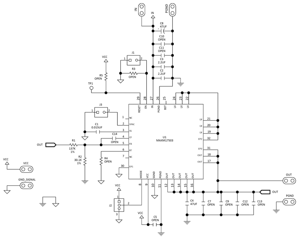

Maxim Integrated MAXM17503
The Maxim Integrated MAXM17503 is synchronous step-down DC-DC power module. It operates at input voltages of 4.5 V to 60 V, can deliver up to 2.5 A and can reach efficiencies higher than 90%. The module can be configured to operate in 3 modes: pulse-width modulation (PWM), pulse-frequency modulation (PFM) and discontinuous  conduction mode (DCM).
The PWM mode has low efficiency at light currents, but switches at a constant frequency. This is useful in applications sensitive to switching frequency changes.
The PFM mode is efficient at very light loads, but at the cost of a lower quality of the output. It also does not keep the switching frequency constant.
The DCM mode features constant frequency switching and provides a light load efficiency in-between the PWM and PFM mode.

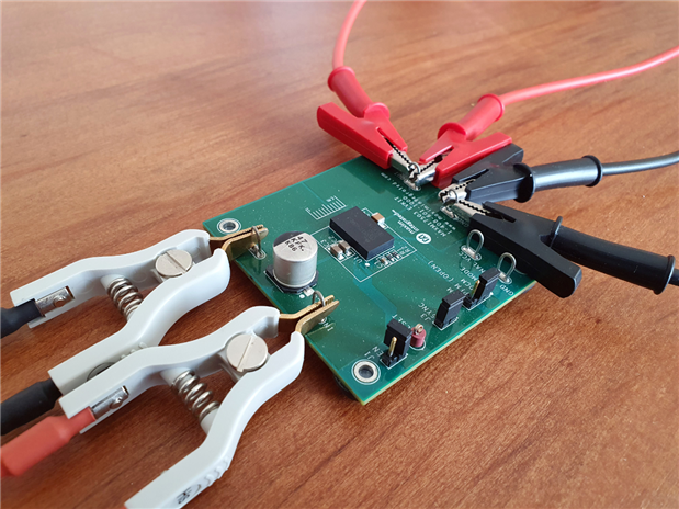

To evaluate the MAXM17503 I used the MAXM17503EVKIT evaluation kit, which is a kit that configured to operate at a switching frequency of 500 kHz and to produce a 5 V output. The kit provides configuration jumpers and makes it possible to test the IC on PWM, PFM and DCM operation modes (J2).

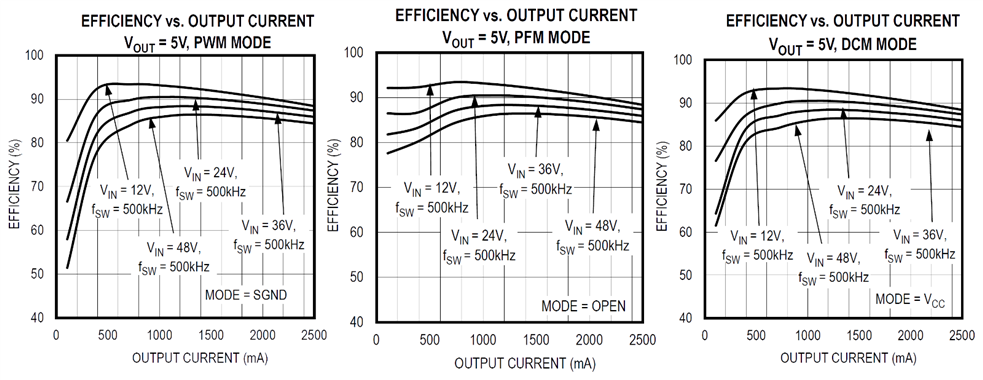

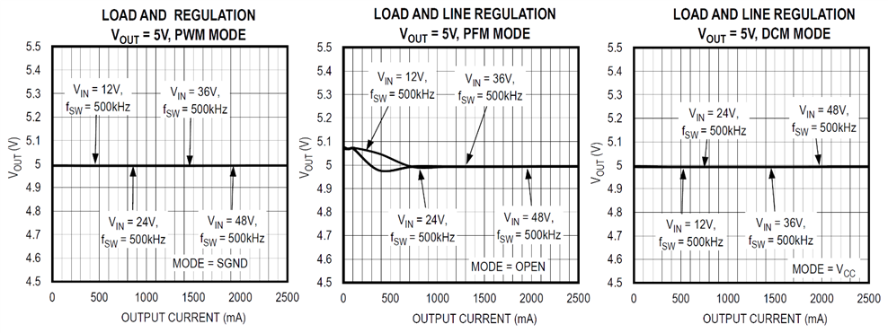

The evaluation kit datasheet provides efficiency and Vout plots for different Vin, Iout and modes of operation.
Even though the datasheet plots show the efficiency and Vout at different conditions, they still have some shortcomings:
  • The Iout scale is linear, so it is hard to visualize what occurs at very low currents.
  • The efficiency at Iout < ~100 mA is not plotted.
  • It is not clear what happens at Vin values not shown in the plots (i.e., <12 V or >48 V).
  • The poorly selected Vout scale makes it impossible to compare the effect of Vin in the PWM and DCM modes. These plots also do not show if there are any differences between these two modes.

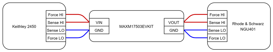

The efficiency and voltage output of the device can be easily measured with a power supply and an electronic load, but this approach does not provide much current dynamic range. By adding more instruments and complexity it is possible to overcome these limitations, but probably the easiest way is with a pair of SMUs.
To make the measurements I will use the Rhode & Schwarz NGU401 and a Keithley 2450. The 2 SMUs have different current and voltage limits, so its important to check that to decide which one should source and which one should sink.
The voltage limits are ±20 V (⩽ 3A) for the NGU401 and ±200 V (⩽ 0.1 A) for the 2450. While the current limits are ±8 A (⩽ 6 V) for the NGU401 and ±1 A (⩽ 20 V) for the 2450.
Considering that the MAXM1703EVKIT can source up to 2.5 A, it made sense to use the NGU401 as a sink and the 2450 as a source.
To get accurate measurements at high currents, the device was connected using 4-wire connections at the input and output.

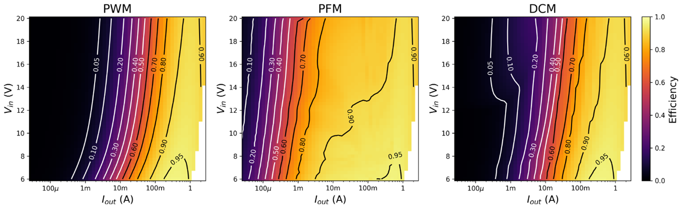

The electrical efficiency is defined as:
Where η is the efficiency, Pin the supplied electrical power and Pout the output electrical power.
Let’s take a look at the efficiency plots:
As expected, the PFM mode has the highest efficiency, followed by the DCM and PWM mode. At Vin close to 6 V, the DCM efficiency is almost identical to the PWM mode efficiency, but as Vin rises the efficiency difference between the two modes increases. The efficiency of the PFM mode on the other hand tends to be much higher for almost any Vin, Iout point.
Not all regions could be probed, the regions in white could not be sourced because they require Iin > 1 A.

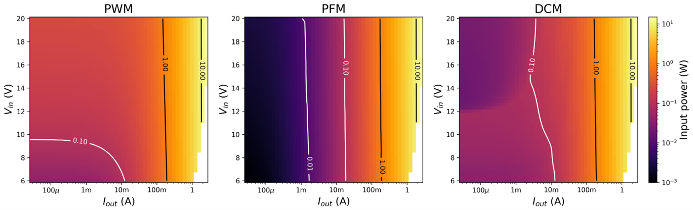

One limitation of the efficiency plot is that it does not show if at some point Pin stops decreasing as Iout decreases. To get a better picture on what happens at very low currents I plotted the Pin.
For all operation modes Pin tended to reach a minimum as Iout decreased. This minimum was reached at ~5 mA in the PWM, at ~200 µA in the DCM and at ~75 µA in the PFM mode. The minimum reached was also not identical for every mode, for the PWM Pin was in the order of 10s and 100s of mW, for the DCM in the order of 10s of mW, and for the PFM mode in the order of just a few mW.

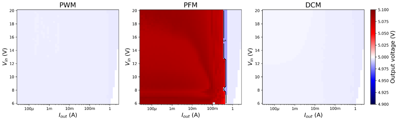

Finally, let’s take a look at Vout:
For the PWM and DCM mode the Vout deviation was minimal, while for the PFM mode it varied up to ~100 mV.
