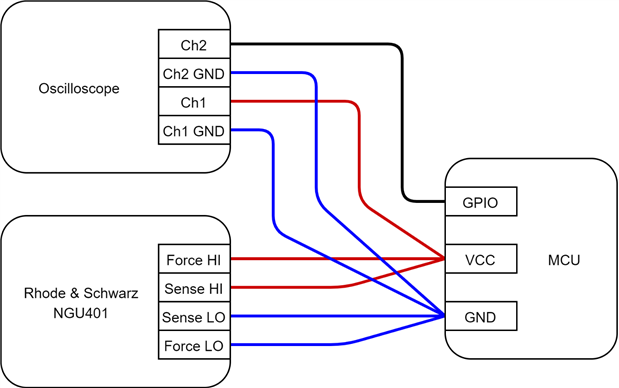

To do so I wrote a small ESP32 program that repeatedly switched between these operation modes. To mark the beginning and end of the execution of each operation mode, I generated 50 ms GPIO pulses. Even though the SMU provides digital I/O ports, I found that I would not be able to use them to "mark" the operation mode switches (i.e., for instance a digital I/O input pin can trigger and initiate fast logging, but it can not stop it after). To solve this I used an oscilloscope as a GPIO pulse and input power logger.

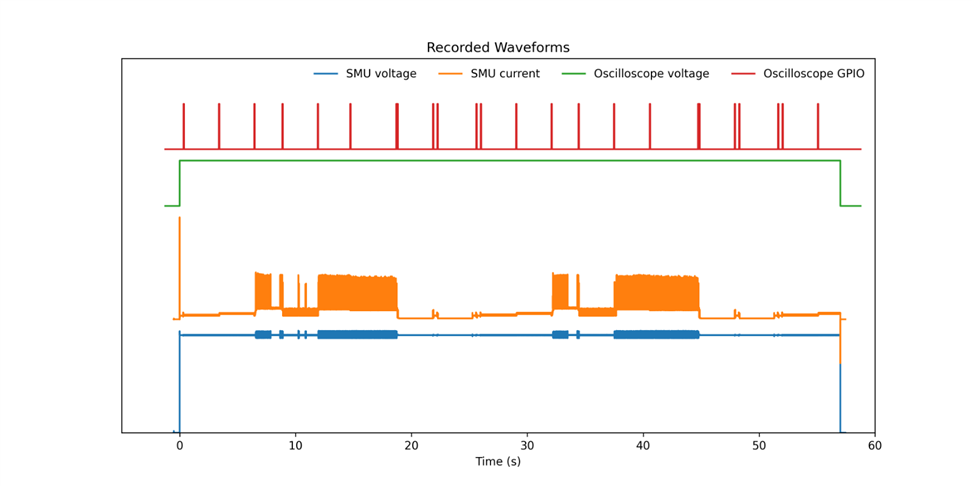

Switching through all operation modes takes ~30 s, so I set the SMU to power the de ESP32 with a signal that supplied 0 V for 0.5 s, followed by 5V for 57 s an finally 0 V for 0.5 s. The power signal was captured with the channel 1 of the oscilloscope, while the GPIO signal was captured with the channel 2. The SMU was set to log at 500 ksps while the oscilloscope was set at 100 ksps (6,000,000 points for 60 s).
Measurements
The recording of VCC with both instrument allowed me to synchronize the GPIO waveform to the SMU waveforms.
The waveforms show that the MCU cycled through all the operation modes twice. Both cycles look very similar, except during the WIFI operation modes. To make measurements I arbitrarily selected the first cycle.

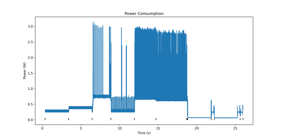

I measured the duration of the phases, average current, charge consumption, average power and energy consumption. I made all measurements between GPIO falling and rising edges, except for the sleeping operation modes that had a delay. For those I arbitrarily evaluated one second in the middle of the sleep (to avoid measuring the overhead caused entering or leaving a sleep mode).

Let's use the Idle operation mode as the basal power usage and evaluate how the different operation modes increase or decrease the power usage.
Idle          : 250.3 mW
Computation   : 359.2 mW  (+44%)
WiFi Idle     : 297.9 mW  (+19%)
WiFi Download : 832.5 mW (+233%)
WiFi Upload   : 827.5 mW (+231%)
Light-sleep   :  66.2 mW  (-74%)
Deep-sleep    :  60.5 mW  (-76%)
Now I can roughly estimate how to program the MCU to keep energy consumption low, but to get a more accurate estimation of when I should stay connected to the WiFi or enter a sleep mode, I need to evaluate the overhead of entering into those operation modes.
Let's answer the question: For what amount of idling time is it better to disconnect in contrast to staying connected?
Above 37.7 s disconnecting from the WiFi to later reconnect when data needs to be transferred will reduce power consumption.
Another way to optimize consumption is by reducing the data traffic (which also would allow the MCU to stay disconnected for a longer period of time). The measured time and energy required to upload 1 MB makes it possible to estimate the requirements for different  amounts of traffic. For instance the requirements to upload and download 1 GB are:
Download 1 GB : 2754 s (45.9 m), 2.293 kJ
Upload 1 GB   : 3920 s (65.3 m), 3.244 kJ
Let's evaluate the sleeping modes. When should the MCU just idle, and when should it enter light- or deep-sleep?
For idling times longer than 10 ms, entering light-sleep will save energy, while for idling times longer than 14.4 s, energy consumption can be reduced even further by entering deep-sleep.

    I love the application you have chosen for RoadTesting the NGU401. The questions I have are not directed at your methodology but rather the performance of the SMU. In the first plot "Recorded Waveforms…
  • neuromodulator
    neuromodulator over 5 years ago in reply to scottiebabe +1
    Thank you Scott. Yes, it was also observed in the scope, but since the scope voltage capture was used just to synch the waveforms, I "binarized" it. Here is a quickly generated image where both waveforms…

    I have never tried to power a mostly digital system from an SMU, so, I find the results quite interesting. Thank you for providing an enlarged plot of the supply transients.
  • neuromodulator
    Thank you Scott.
    Yes, it was also observed in the scope, but since the scope voltage capture was used just to synch the waveforms, I "binarized" it. Here is a quickly generated image where both waveforms are plotted next to each other:
    And here you can see the size:
    The instrument provides a couple of options to control its regulation capabilities, I will do some tests and publish the results in an update.
