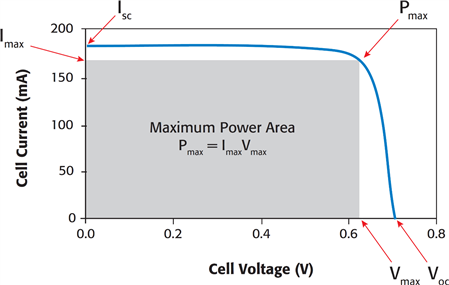

Solar or photovoltaic cells are devices that convert light energy into electric energy through the photovoltaic effect. Optimizing power conversion from solar cells is not trivial because of the shape of the I/V curve:
Parameters that define the I/V curve of a solar cell for a defined light condition are the short circuit current (Isc), the open circuit voltage (Voc) and the maximum power (Pmax), which is the power at Vmax voltage and Imax current.

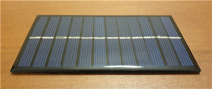

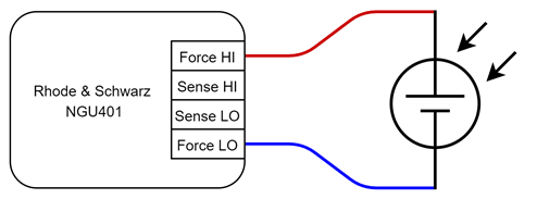

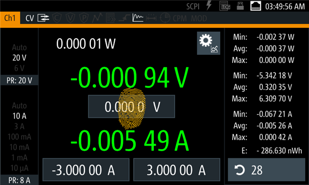

I connected a small 6 V solar panel to the instrument to compare how these parameters can be measured through different workflows.
Front panel

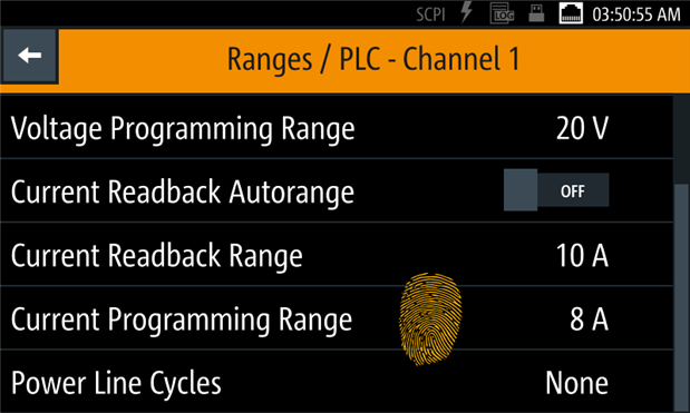

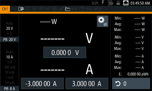

Since the instrument keeps the last used settings, I will start with a setting that is more or less standard:
  • Voltage priority mode
  • Current limits: ±3 A
  • Programmable voltage: 20V
  • Readback voltage: 20V
  • Programmable current: 8A
  • Readback current: 10 A

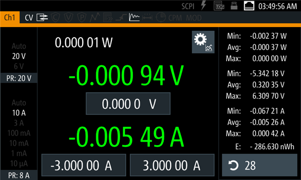

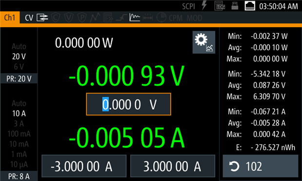

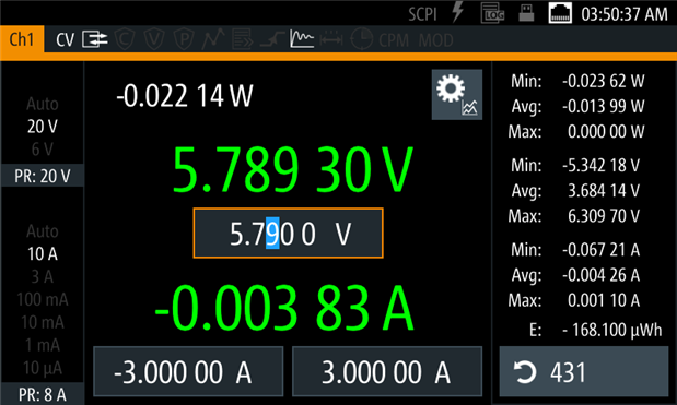

The display with these settings looks like this:
To measure the Isc it is as simple as pressing the output button. The SMU sinks at 0 V and the the current value (5.49 mA) indicates the Isc.

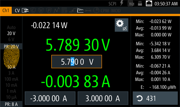

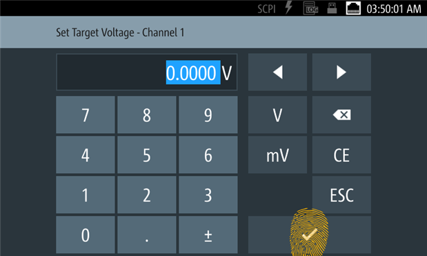

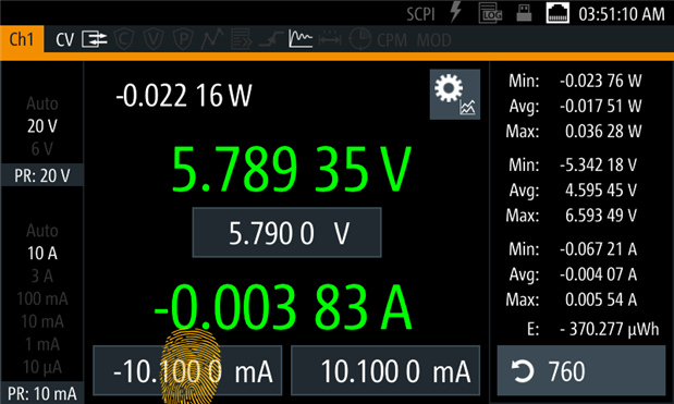

To find the Vmax, Imax and Pmax, I pressed the voltage setting, and then the rotary knob to enter the voltage value.
Instead of entering a value, I pressed the rotary knob again and then used it to set each of the voltage digits. Rotating the knob changes the selected digit, while pressing it switches the selected digit to the next one. While doing this I kept an eye on the power indicator to make sure it increased until I reach its maximum value (Pmax). There, Pmax was 22.14 mW, Vmax was 5.78930 V and an Imax was 3.83 mA.

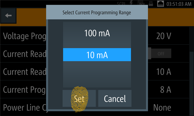

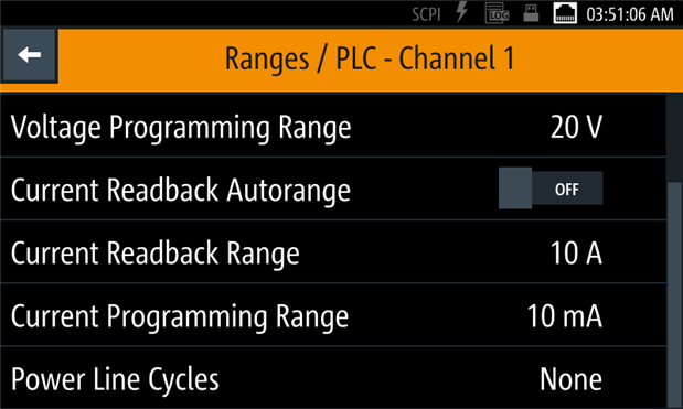

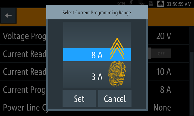

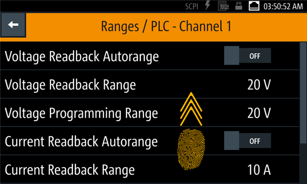

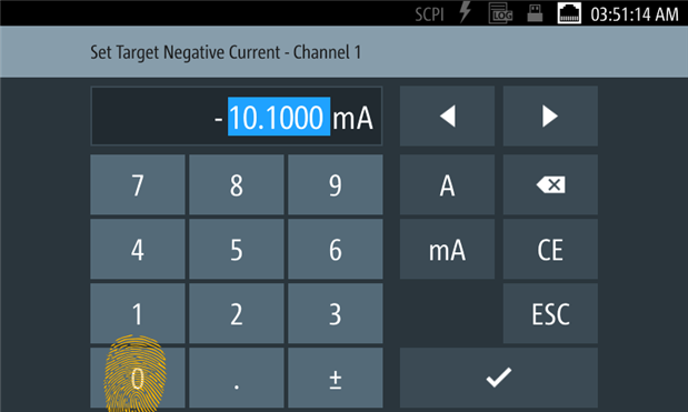

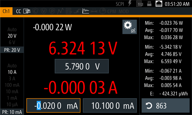

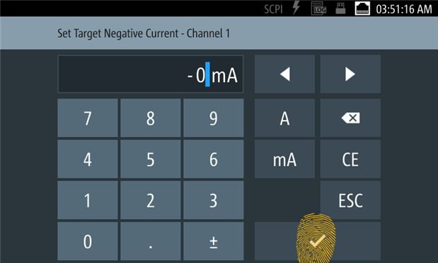

I could have measured Voc in an analog way by changing the voltage until the current reaches 0 A. That would have been probably the fastest way, but the current limit settings can also be used to find Voc. To do so, I pressed over the range settings, then I selected the programming current range to 10 mA, pressed the home button, and finally set the negative limit to 0, which the instruments sets automatically to -20uA (the minimum). The numbers then turned red as the SMU switched to constant voltage mode. The voltage output of 6.32423 V is the Voc.
Setting the programmed current to 10 mA could be omitted, but this would reduce the accuracy of the results. Setting the proper range could also have improved the measurement of Isc, Vmax, Imax and Pmax, but the impact there was much lower, so to keep things simple I did not bother doing that.

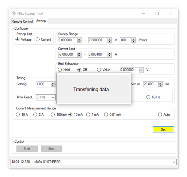

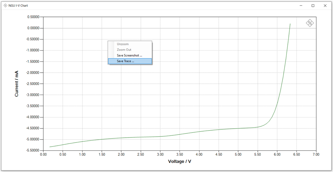

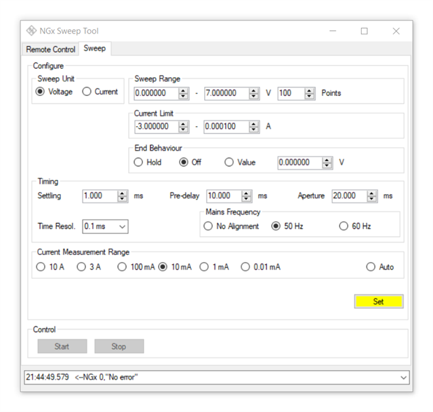

A faster way to perform a quick measurement is with the Rhode & Schwarz's NGx sweep tool.
To use it I load it, and then I set the sweep parameters. I set a voltage sweep from 0 V to 7 V with 100 points (or steps), and the current limits from -3 A to 0.1 mA. The end behavior was set to off so that once the sweep is complete the SMU just cuts the output off. The pre-delay adds time for the control loop to stabilize before the aperture begins; I set it to 10 ms. The settling time adds time after the end of the aperture before the next step occurs; I set it to 1 ms. The aperture is the time where measurements take place; I set it to 20 ms. The time resolution, which is the inverse of the sampling rate, was set to 0.1 ms (10 ksps). Mains frequency was also properly set to reduce mains noise. Finally I set the current measurement range to 10 mA.
Then I pressed the Set button, and the tool uploaded the AFG function to the SMU.

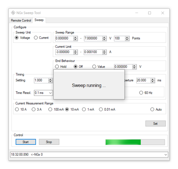

Pressing "Start" initiated the sweep and showed the progress on a green bar.
As soon as the sweep finished, an I/V chart window appeared, and was able to explore the I/V curve.
Surprisingly the 0 V point was missing (the tool appears to miss the first value of the sweeps), to get that value I could rerun the sweep starting with a negative voltage, or just roughly estimate Isc from the plot (~5.4 mA). The graph can be zoomed in to find the Voc, but I consider the graph view more useful to get a rough estimate (i.e, I found its navigation not that simple), so here Voc appeared to be ~6.3 V.
From the graph view it is not possible to find Pmax, so I saved the trace points into a text file.

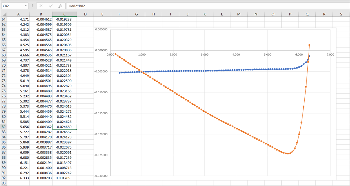

Then I opened it with Excel, computed the power, and plotted the current and power (just as a data sanity check).
Here we can see that Pmax = ~24.7 mW, Vmax = ~5.66 V, and Imax = ~4.36 mA.
