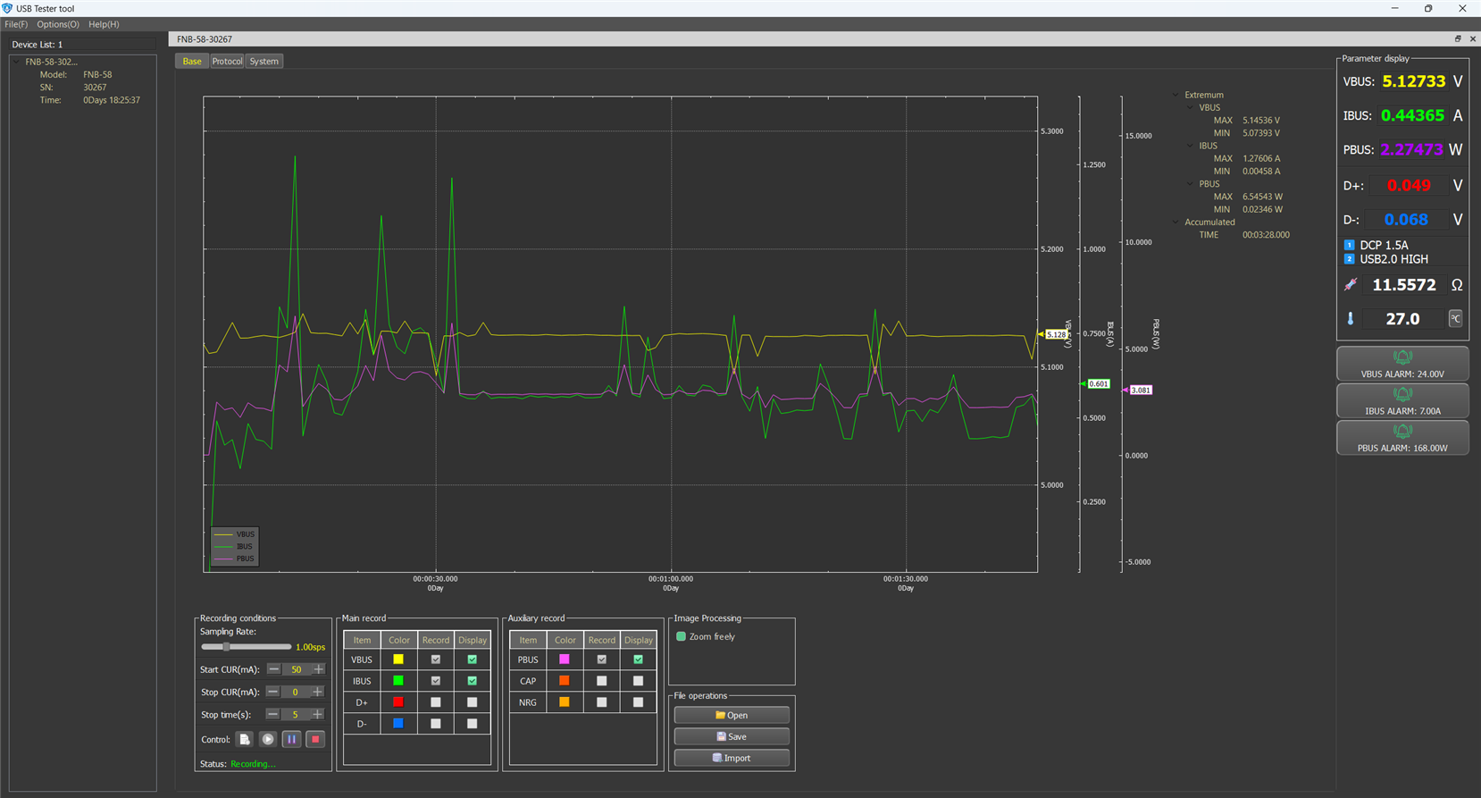

A few years ago scottiebabe  posted about the FNIRSI FNB58 USB Power Meter.  I had a "I've got to get me one of those" moments and I bought one.  I have to admit that I mostly use it standalone for doing measurements, but I have done some logging and visualization using the USB Tester Tool app on my Windows PC.  I use the USB interface to the FNB58 rather the BLE interface.
I took a quick look at the CM5 kit running Frigate streaming 1 camera to the web interface with no detection.  This is from startup, so there are some large current spikes initially but it settles down to an average around 3W.

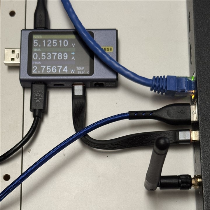

Here is the FNB58 connection setup that I'm going to use:
  • Power input - USB-C lower left from RPi 27W power adapter
  • Power output - USB-C lower right - 5 inch 240W (5A) USB-C cable to CM5 IO power input
  • Data/meter power - Micro USB upper left - connected to the CM5 IO lower USB3 port
I made sure that I used a short cable rated for 5A after the meter to minimize the voltage drop after the measurement.  I am going to use the CM5 to interface to the FNB58 so that I can capture the power measurements directly.  We'll be able to measure the drop from the RPi adapter cable at the meter.  You can see that the voltage is being sourced at higher than 5V to allow for the drop at 5A.

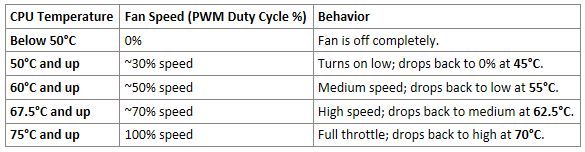

The RPi5 and CM5 share the same thermal and fan management setup using the RP1 I/O controller chip.
The default temperature thresholds are as follows with a default hysteresis of 5C:
I have some concern about the airflow in the CM5 IO case and whether I may need to adjust the fan profile to compensate for thermal lag and also for possible cooling issues downstream at the M.2 slot where the Hailo-8L will be plugged in.
The fan profile can be modified by adding device tree parameter settings in the /boot/fimware/config.txt file.  The syntax is as follows:

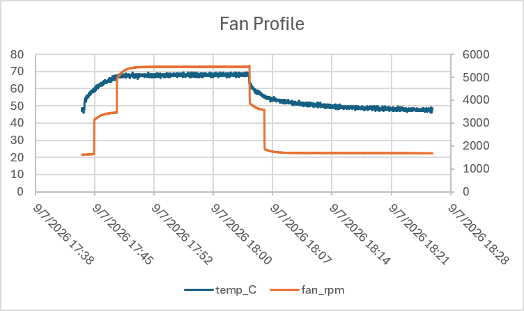

Fan Thermal Profile Test
As a quick test of the fan profile and the thermal logger, I am using a standard Linux hardware stress test, stress-ng, to increase the CM5 CPU temperature and watch the fan response.
I am going to run the thermal logger for about 40 minutes.  I will run stress-ng for 20 minutes.  That should allow us to see the thermal ramp up  and down and the fan response.
stress-ng --cpu 4 --cpu-method matrixprod --timeout 1200s --metrics-brief
  • 4 CPU workers
  • matrixprod workload
  • 1,200 seconds = 20 minutes
Here is the logger file:
