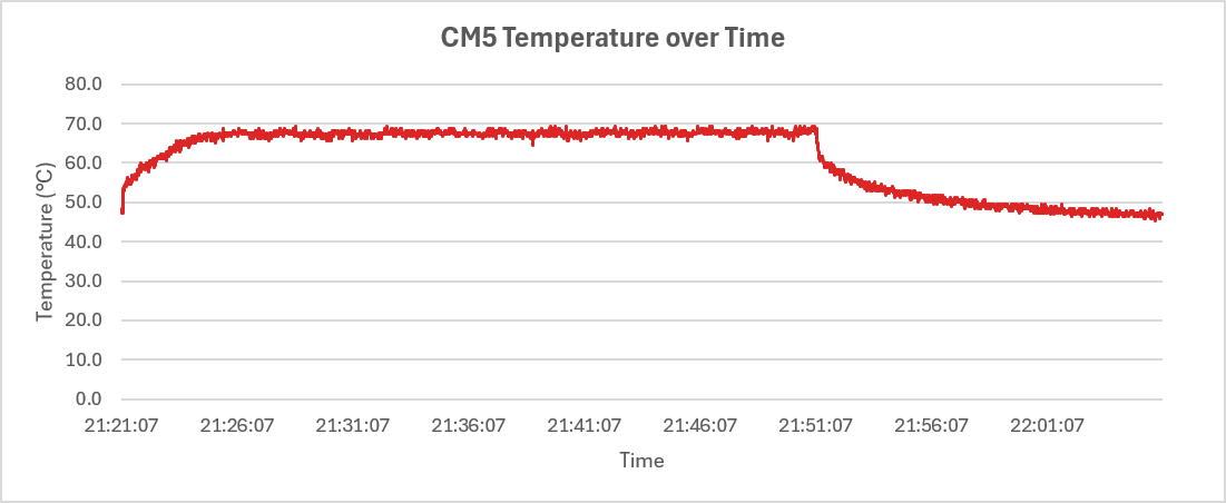

Thermal Tests continued
I had forgotten to mention in my previous post that after the roadtest benchmarking is complete that I still want to monitor thermal and power parameters on the Frigate NVR.  To that end, I'm going to create MQTT sensor entities for those parameters so that I can monitor them in Home Assistant and also display them on a Node-Red dashboard.
I installed the Mosquitto MQTT client on the CM5 and added a crontab entry to publish the CM5 CPU Temperature once a minute
.The crontab syntax is:
* * * * * mosquitto_pub -h localhost -t "mytopic" -m "my_message"
mytopic is cm5/hardware/cpu_temp
my_message is $(( $(cat /sys/class/thermal/thermal_zone0/temp) / 1000 ))

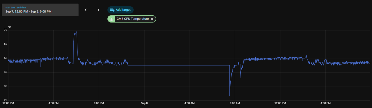

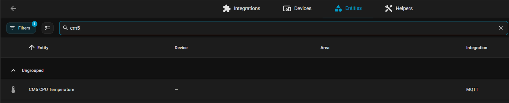

Over on my RPi CM4 which is running Home Assistant, I added an mqtt sensor entity in my configuration.yaml
mqtt:
 sensor:
 - name: "CM5 CPU Temperature"
   state_topic: "cm5/hardware/cpu_temp"
   unit_of_measurement: "°C"
   device_class: temperature
   state_class: measurement
And I can then view the sensor data directly by name.
The plot is showing the temperature over a couple of days.  In the first third of the plot, Frigate is running initially with a single camera.  Then I stop Frigate and run the stress test (the large spike).  Then the system is just idling.  The flat line is a period when the system was turned off (it retains the last received value).  Then system turns on, Frigate runs single camera then back to idle.
Sensor entities are pretty useful to examine data timelines independently from a dashboard, so I'll create them for parameters that I want to watch, but I'll also create a Node-Red dashboard for real-time monitoring.

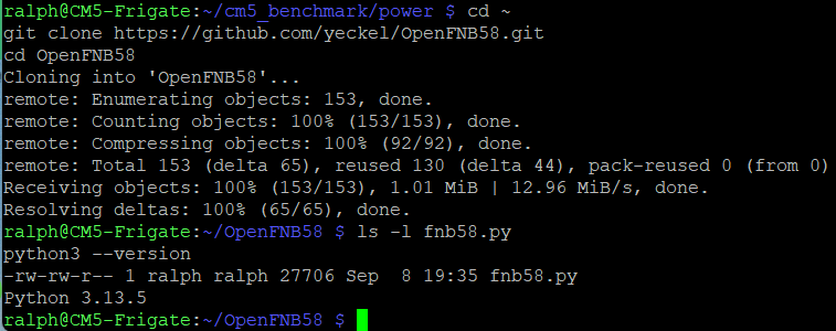

To do the power logging using the FNIRSI FNB58 I am going to use OpenFNB58 which is an open-source logger written by Libor Tomsik.  In particular I am going to use the Python CLI reader fnb58.py.  .This reader can interact with the FNB58 using USB HID or Bluetooth LE, but I'm going to use USB for speed and reliability.  The FNB58 is quite a capable tool, it can sample at 100Hz which might be good for looking at quick events but I don't expect to run faster than 1 Hz.

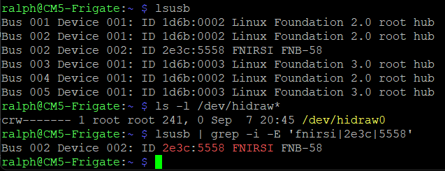

First thing to do is to verify that Linux can see the FNB58 when you plug it in.
Everything looks good, so any required drivers are already available.
Clone the OpenFNB58 repo from github.
All FNB58 programs will be run from this directory to insure we have the correct path to required files.
Quick test of fnb58.py to verify it is operating okay with a single measurement test.
For reference here is the fnb58.py file from the repo:

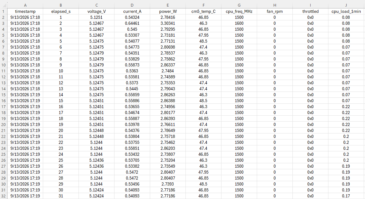

Here is the CSV file that is created:

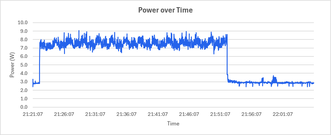

As a final check I ran another stress test, this time including memory stress and running for 30 minutes (logger runs for 45).
.image
The data plots from the CSV file.
At this point I'm ready to start trying different performance benchmarks.
