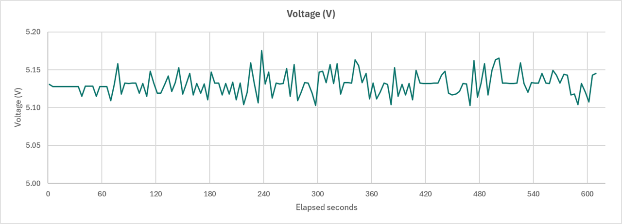

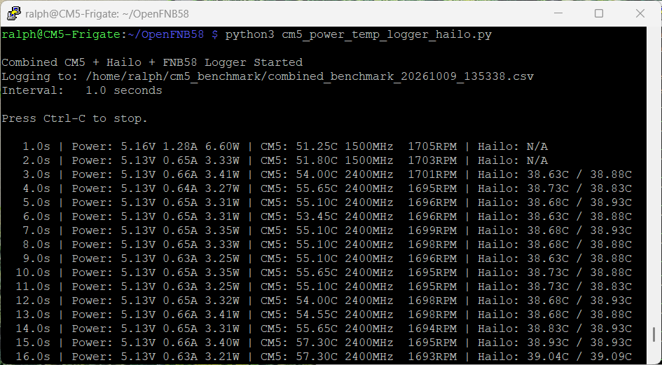

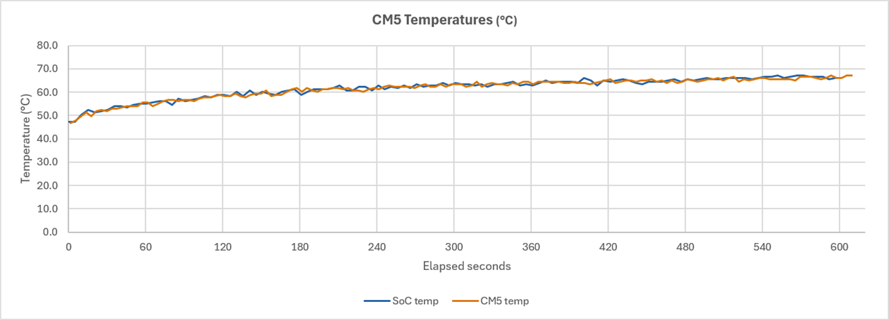

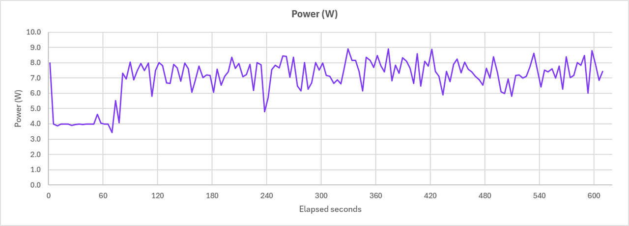

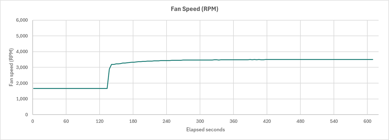

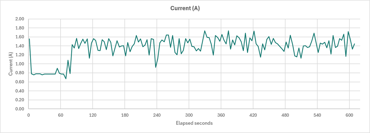

And the logger output:
You'll notice that for the first couple of seconds that the Hailo temperatures are not available.  That's because I had started the logger before Frigate had finished starting.
Comparison Data for Different modes
 A quick jump up:

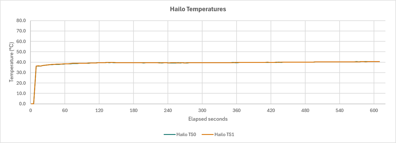

  • The Hailo-8L temperature isn't an issue in this configuration, even without a heatsink. Temperatures are around 40 C.

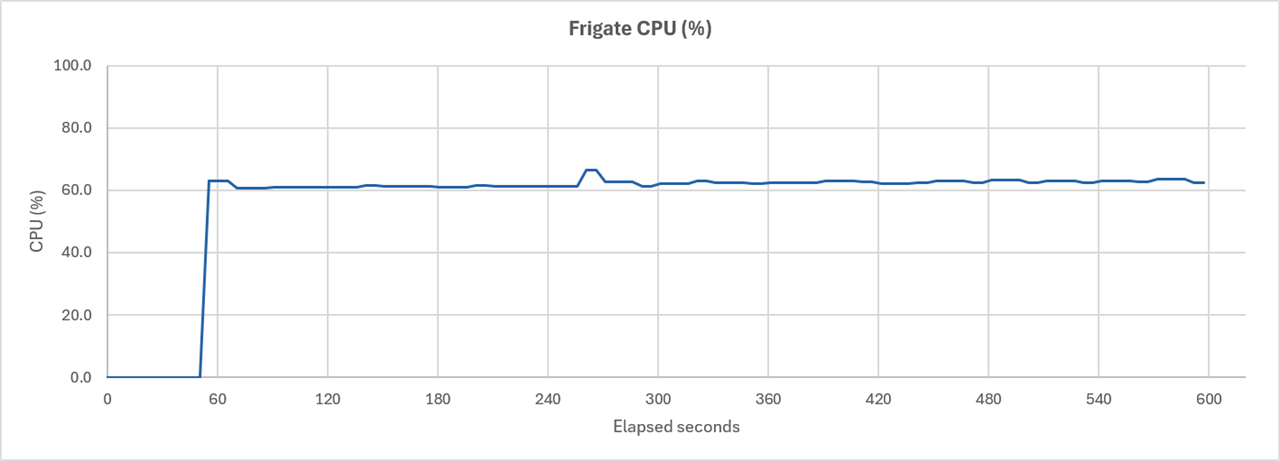

  • The CM5 temperatures are also reduced due to offloading of inference to the Hailo.  The active cooler fan stays in the second operating zone (3500 rpm).

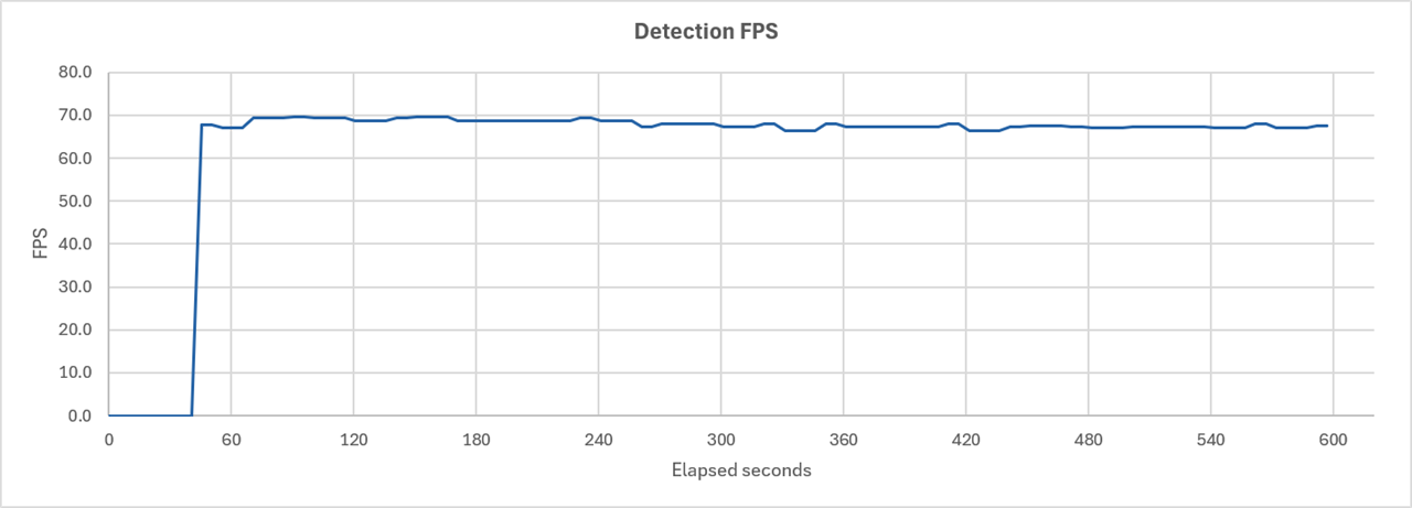

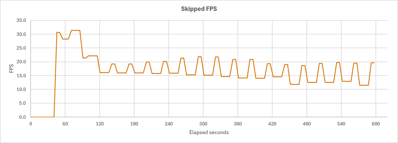

  • Detection_FPS (inference) is able to scale as cameras are added.  The CPU detection limited it to 15 FPS.
  • Skipped_FPS only becomes an issue with 8 cameras.

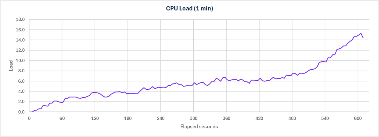

  • There is some anomalous behavior with the CPU_Load (1 minute average) numbers from Linux.  I'll need to rerun some of the tests to see if I can get repeatability.  It might be caused by the asynchronous camera processing and inference threads and the other processes running on the CM5.  In the 8 camera test, the load numbers increase rapidly about 8 minutes into the run.  If that is real, that mode may not be usable.
