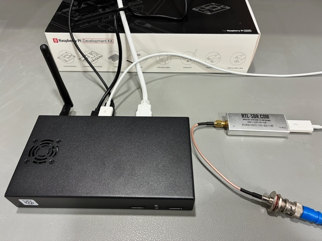

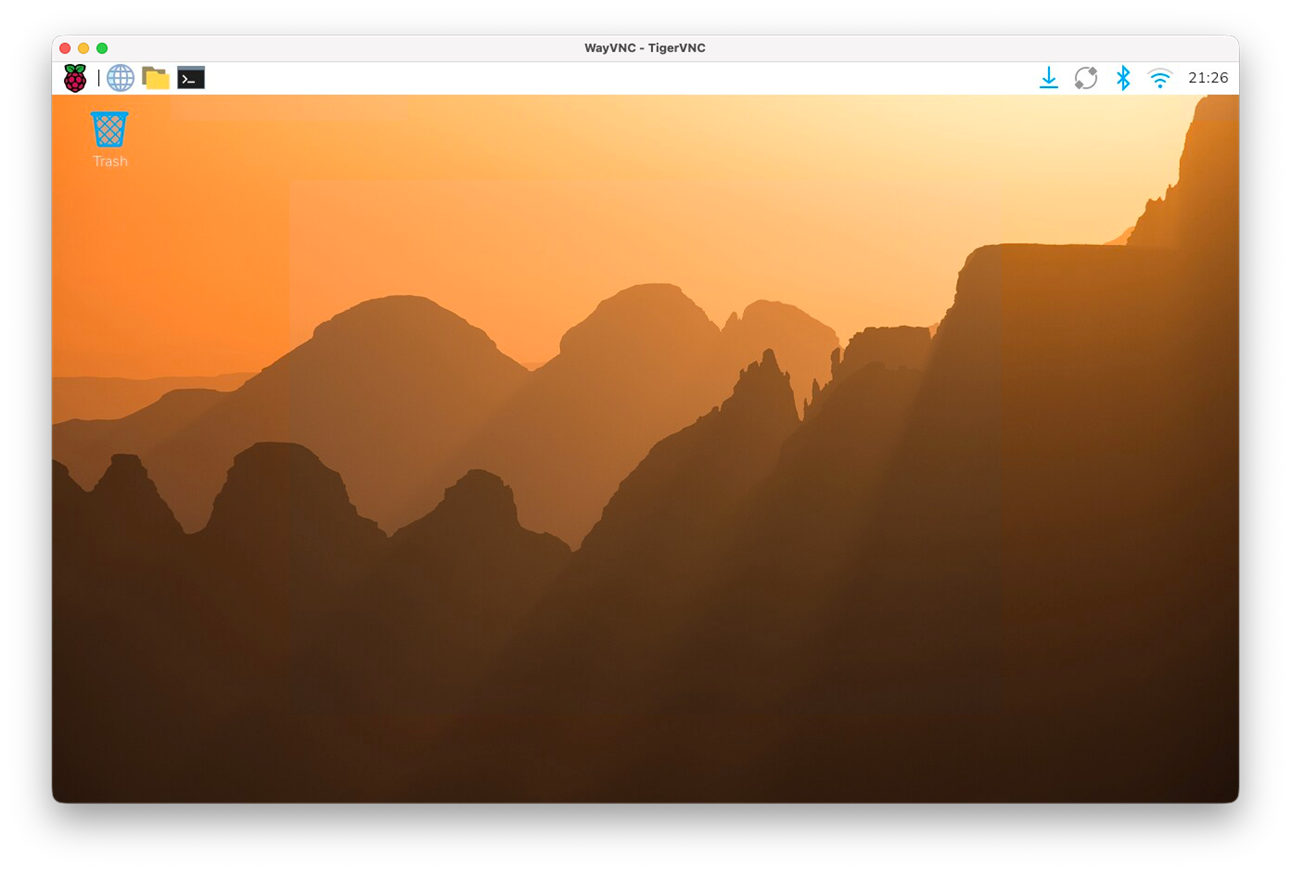

Now that Linux is installed, it's time for the first boot. I'm using a Joy-IT RB-LCD10 touchscreen monitor with a resolution of 1280 × 800 pixels. During startup, the system asks for several configuration parameters, including the language and regional settings, keyboard layout, and Wi-Fi credentials.
Initially, I had some trouble connecting to Wi-Fi because of a weak signal. I hadn't realised that the Raspberry Pi was using the internal PCB antenna rather than the external antenna connected through the U.FL connector. This can be changed by adding dtparam=ant2 to the /boot/firmware/config.txt file.
After making this change and rebooting, the system completed the startup process in an impressive less than 18 seconds. This is significantly faster than I have experienced with any of my other Raspberry Pi systems, even with a headless installation.

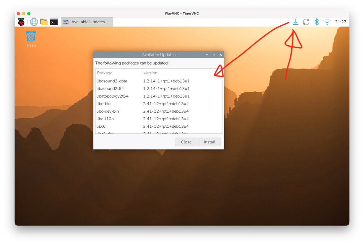

Software updates
In the upper right corner of the screen we encounter a icon showing a arow pointiung down, this means updates are available. You will see this quite often when using the Raspberry Pi. After clicking the icon, a window pops up showing the new available software versions.

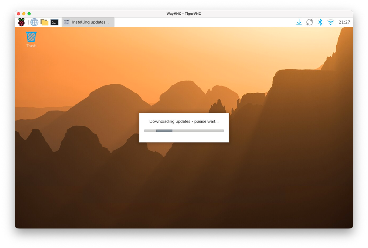

After pressing instal the software is dowloaded
And installed.

Finally, I listened to the local broadcast news station on the FM band using rtl_fm. Since the IO board has no separate audio output and my HDMI display does not provide one either, I used a Bluetooth speaker. The raw audio output from rtl_fm was piped directly to pw-play. The parameters, particularly the sample rate and audio format, required some tweaking, but in the end the setup worked quite well.
me@raspberrypi:~ $ rtl_fm -f 98.9e6 -M wbfm -s 154000 -r 48000 - | pw-play -a --format=s16 --rate=48000 --channels=1 -
Found 1 device(s):
  0:  Realtek, RTL2838UHIDIR, SN: 00000001
Using device 0: Generic RTL2832U OEM
Found Rafael Micro R820T tuner
Tuner gain set to automatic.
Tuned to 99185500 Hz.
Oversampling input by: 7x.
Oversampling output by: 1x.
Buffer size: 7.60ms
Exact sample rate is: 1078000.010281 Hz
Sampling at 1078000 S/s.
Output at 154000 Hz.
^CSignal caught, exiting!
User cancel, exiting...
me@raspberrypi:~ $
Bottom line
The CM5 proved more than capable of handling the RTL-SDR, from building and installing the latest drivers to receiving an FM broadcast and playing the demodulated audio through a Bluetooth speaker. The lack of a dedicated audio output on both the IO board and the display required a slightly different approach, but using rtl_fm together with pw-play provided a simple and effective solution. Overall, this was a good first demonstration of the CM5 as a compact SDR platform, and it leaves plenty of scope for further testing with more advanced SDR hardware and software.
