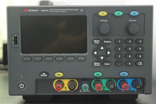

Let’s start with the appearance and the front panel of the supply. It has a nice and big colourful LCD, 2 separate control knobs for
voltage and current adjustment, a keypad to enter the desired values of the voltage and current,
colour coded push buttons for each channel along with colour coded outputs (yellow, green and blue) and
few other push buttons for quick actions like tracking and print screen, meter view etc.
It also has a USB port for data logging and screen shot purposes. Overall the build quality is really good.
The three outputs are independent of each other, output 1 gives 6V, 5A and other two outputs give 25V, 1 A each.
Each output is colour coded and hence is easy to distinguish between different outputs. Each output has a independent
colour coded buttons to switch on/off and a master switch for all outputs.
The unit powered on and the LCD showing the outputs which are colour coded
