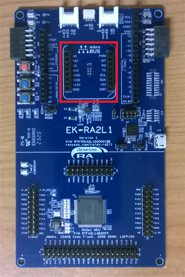

At the beginning I likely to describe what we can find on evaluated board. Whole board looks as follows:

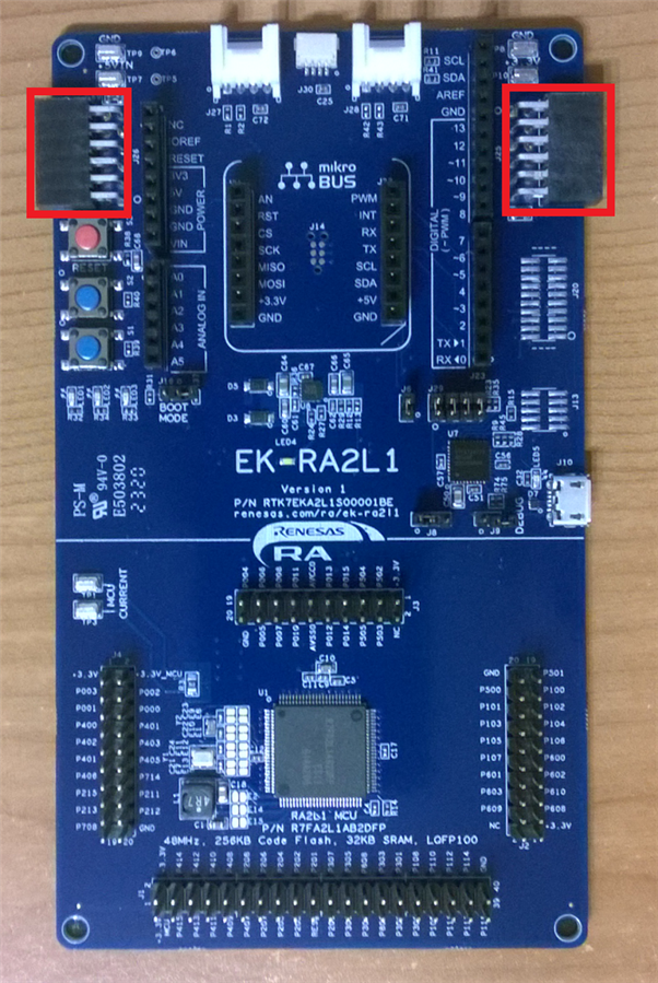

Except chips there are 8 interesting connectors. There are Arduino Uno compatible connector:

There are MicroBus connector for connecting expansion boards in this form factor:

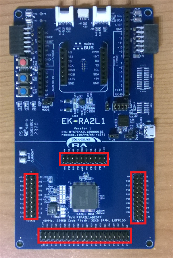

And finally, there are 4 standard 2.54mm connector exposing all the MCU GPIOs:

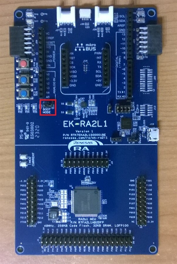

First jumper is designed to select boot mode. Main MCU has integrated bootloader and using this jumper you can try this feature on your evaluation board (for example, testing this procedure before going on production). Jumper is 2 pin and by default opened but it is bundled in package. Jumper is connected in a way that one pin is used for holding them and second pin of jumper fly in air (is unconnected). Jumper is highlighted on following image:

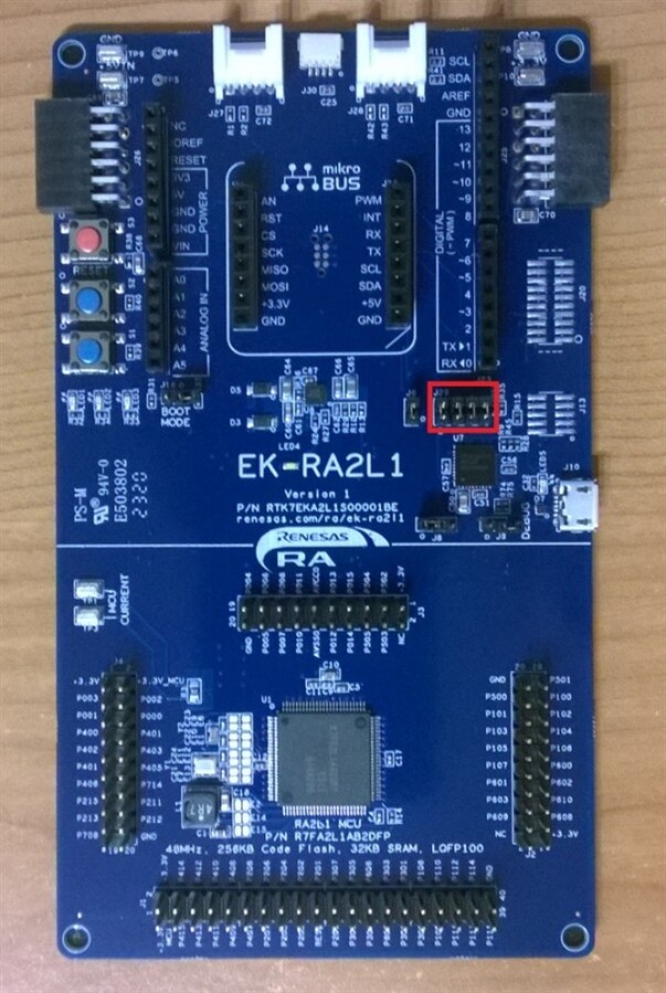

There are 4x2 pin jumpers used for disconnecting SWD (and on some kits possibly connect JTAG wires also) wires from main MCU. Only two pairs of signals are used on this kit. Jumpers are highlighted on following image:

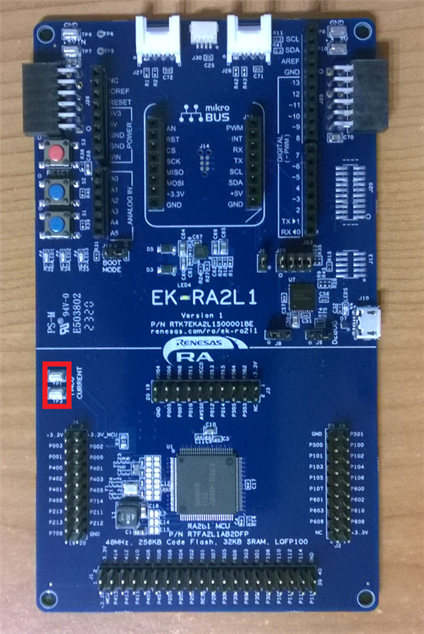

Last interesting feature which I want to mention is onboard small value accurate resistor which can be used for connecting current sense amplifier (or oscilloscope doing the same thing). Vendors usually provide just a jumper for connecting amperemeter but because of low consumption and high clock frequency used in modern MCU using amperemeter is less interesting in these days and current sense amplifiers may be a better choice, so this feature is welcome, I think. Probes for connecting external current sense amplifier to onboard shunt resistors are highlighted on following image:

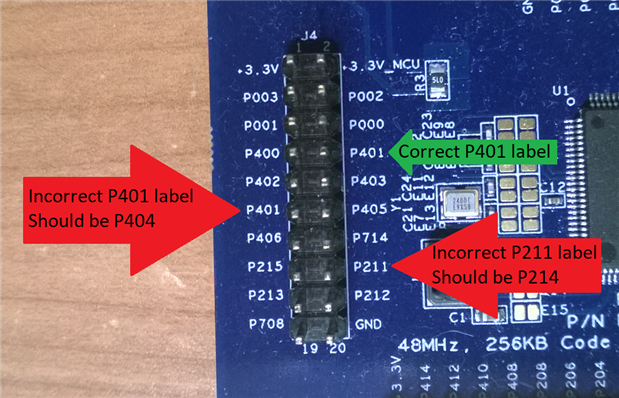

Pinout is pretty fine, but there are some issues which I consider as a bad design. In bottom area of board all GPIOs of MCU are exposed including pins which are connected to some ports on connecters in upper area. This is fine. I utilized these bottom pins for connecting logic analyser to peripherals connected to the upper parts and I liked it very much. Technically this is done well but there two wrong pin labels. I will describe in following section. But there are one another significant issue. The issue is with multiplexing signals between connectors. It is done very extensively on this board. In some cases, it is justifiable. It is for example case of I2C signals. I2C signals are multiplexed between one groove and qwiic and one PMOD, but due to nature of I2C bus this is not the issue. Also note that both PMODs have their own I2C bus and similarly both GROVE connector is connected to non-shared bus so you can connect 2 devices with the same address to them and utilize them at the same time. Biggest multiplexing issue, I consider on SPI bus and especially on Slave Select wire. SPI signals including SS are multiplexed to the one PMOD, Arduino connector and MicroE connector at the same time so you cannot use multiple (even different) SPI devices at the same time connected to these connectors. Sharing bus signals is not a problem but sharing SS signal is. If you want to use multiple SPI devices at the same time in these connectors you must yourself ensure that you do connect some other GPIO to SS pin on your sensor/board. I think selection of pins used for SS on SPI bus was wrong and designers in Renesas can select (even generic without SPI SS support) different GPIOs per connector with SPI exposed next time.
Onboard labels

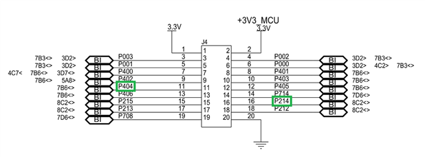

As I have described in previous section there are bugs in pin labels. I found two bugs which can make very hard time when troubleshooting issues caused by them and especially when you do not know about them.
The first bug is that there are two pins labelled as P401 but one of them should be P404. The second wrong label is P211 (in fact P211 does not exists on RA2L1 MCU at all) which should be P214 instead. Both bugs are highlighted on following image:
Note that schematic has correct pins assigned as shown on following image. Bug was probably introduced by engineers in the process of designing PCB by manual silkscreen label placing.
Except these two bugs pin labels are correct and very useful. There are plenty of other labels including very smart description of MCU parameters, board name, MCU name, product code, revision number, Arduino signals are labelled well and so on. I lack some labels describing purpose of test points, but this is minor issue. My last note in this section is that some labels on bottom side of board are placed over vias. Some affected letters look little bit deformed, but this also is not a significant issue and even affected letters are still easy to read.

    Update 2021-12-03:
    Upon my support ticket at Renesas website, Renesas published updated errata for EK-RA2L1 mentioning wrong pin labels with additional details like range of serial numbers of affected boards and note that issue was resolved in next revisions, so most probably if you buy board now, you will receive board with correct labels.
