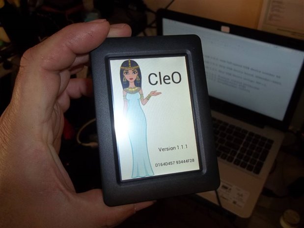

Using this video (https://www.youtube.com/watch?v=mAKZJbUlQ4s) as a guide I plugged the Cleo in, viewed the splash screen to verify that it worked. I perfered the YouTube video because I wasn't able to pause/play the one on FTDI's website, but maybe that is just bad HTML5 support in linux browsers.
Here is the dmesg output for the CleO on linux:

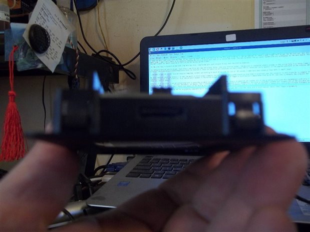

I like the bezel that comes with the CleO. It has mounting clips and is also mounted to the Cleo with screw so it can be removed. It takes a good finger nail to get the SD card out, but this is probably a good thing. I don’t worry about it accidentally popping out since it seats such that it is inside the bezel. The USB connector and all other connections are orthogonal to the main board. This seems like the best layout for remote mounting of the CleO so the wiring can be hidden.
The Nero was easy to connect to the CleO. The Nero has nice, long header pins and installs firmly into the CleO as expected.

Otherwise I am impressed. I was up and working with it yesterday in about an hour’s time. The CleO library is powerful yet simple. All of the graphics primitives are implemented with only 7 commands – String, Bitmap, Line, Points,  Circles, Rectangle, and Needle. The 7 commands have roughly 7 sub commands to set parameters, but also an Extended command that accepts all of the possible parameters. It became clear in a short time that I could save memory on the NerO by writing a script that reads these parameters from a file on the SD card and it would only need a switch/case statement with 7 cases.
