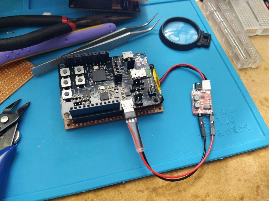

What I do have in quantity however, are those cheap single-sided 5x7cm protoboards. Fortunately, the pins of the eval kit are on a standard 0.1in spacing and I was easily able to make a base and a shield using some female headers and some long pin male headers, respectively. This seems to be how the evaluation kit was designed for when prototyping connectivity with sensors and other supporting peripherals.
Here's my attempt at trying out a baseboard, and a "shield" for the PAN1780 eval kit. While I took the pictures like this, I'll probably turn the boards around so as not overlap the "keep out" area of the module's chip antenna.
And here's one of the ideas I have with the bottom baseboard; aside from adding components directly connected to the gpio, it can also become a holder for a battery, making the whole kit portable.
I do feel that there was a missed opportunity here with regard to support for commercially available, pre-packaged add-ons. There are many available sensors prepackaged for the Arduino Uno R3 form factor, and if the Arduino form factor is a no-go due to the unconventional 0.05in spacing on one of the gpio rows, there is the Arduino MKR pin layout, or the Adafruit Featherwing pin layout (both of which have a considerable following).
Either of these two layouts have support for a large number of sensors and peripherals in their ecosystem, and have the advantage of being already widely and commercially available for an even quicker prototyping. That said, it's not that much of a big deal since, as I've shown, it's not that difficult to add your own baseboards or shields.
