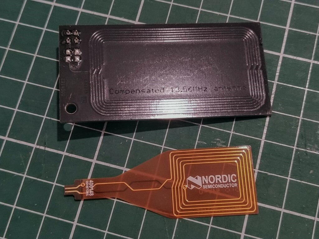

While the package itself was quite bare, it contained the necessities. The NFC antenna was especially a nice piece of hardware. All of the jumpers have been installed in the correct places according to the online manual, and there aren’t any loose pieces inside the box.

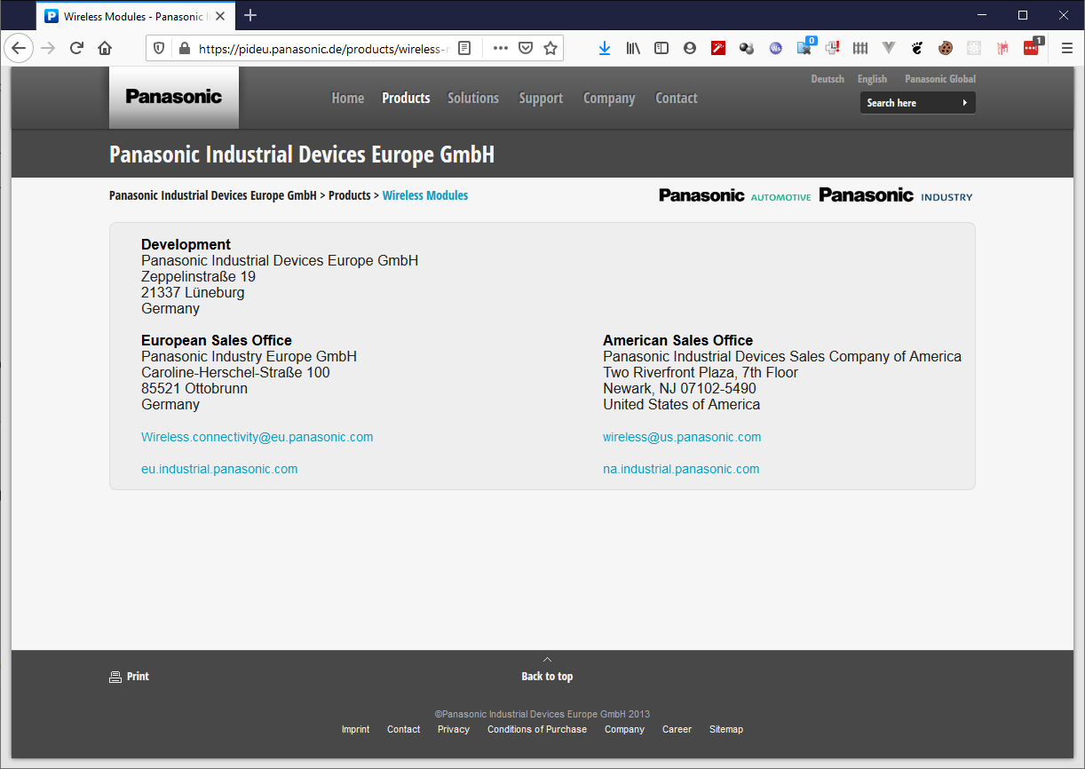

I was expecting the online resource at https://pideu.panasonic.de/products/wireless-modules.html (as printed on the QR code and the sticker) to link to the missing documentation and manuals, but found it as bare as the package I received. It took a moment to figure out that this page was just a gateway for the EU and the NA specific sites, and that the stuff I was looking for was in https://industry.panasonic.eu/devices/wireless-connectivity (that’s the EU link; the NA link goes to all of the offerings that Panasonic Industry has and it can take some time to drill down to the information specific to the PAN1780). It would have been nice to have the sticker print the QR Code and links specific to the evaluation kit, rather than to the marketing materials and have the user click through menus just to download datasheets.
If you’re following along, the page specific to the PAN1780 is at https://industry.panasonic.eu/devices/wireless-connectivity/bluetooth-low-energy-modules/pan1780-high-performance-and-long-range

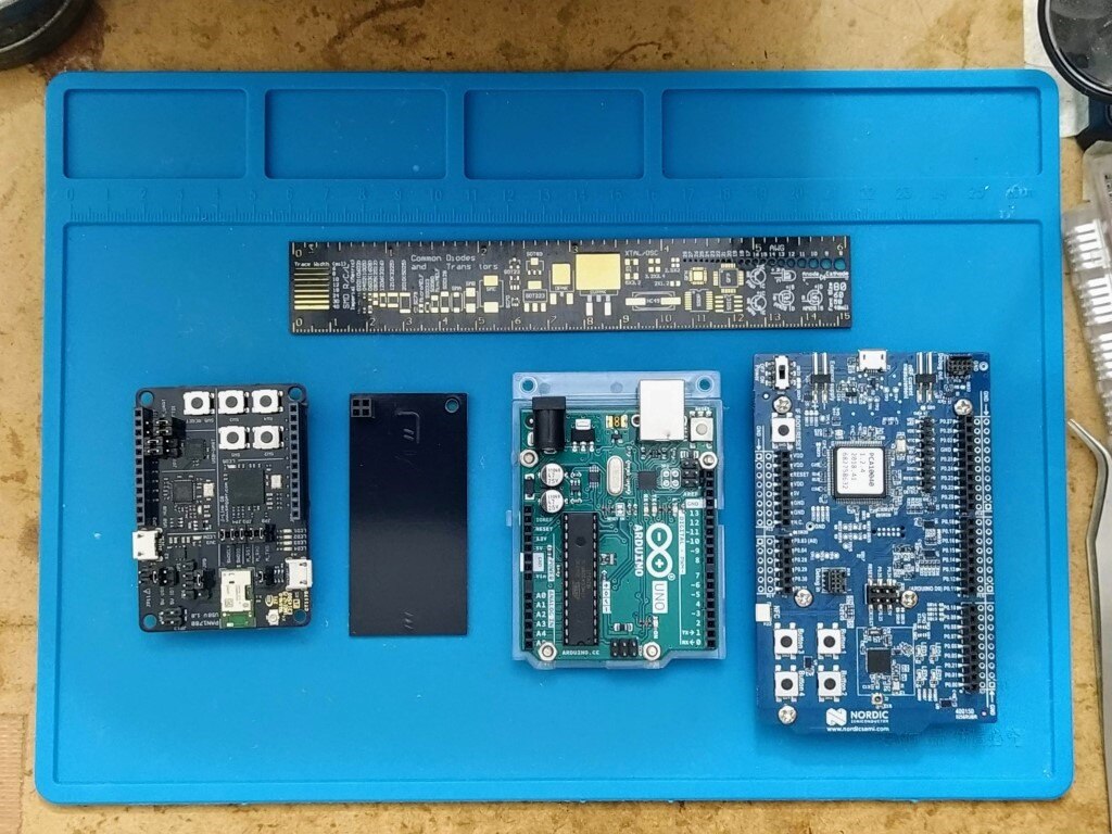

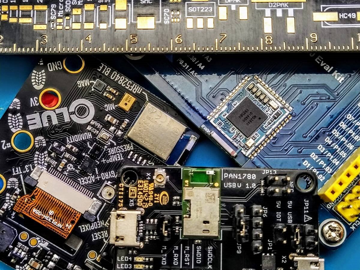

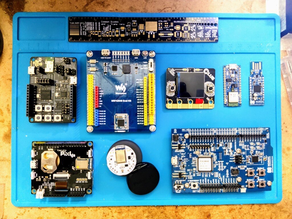

nRF52840 boards, from top left: PAN1780 eval kit, Waveshare nRF52840 eval kit, Adafruit Clue https://www.adafruit.com/product/4500 , Arduino Nano 33 BLE Sense Arduino Nano 33 BLE Sense , nRF52840 DonglenRF52840 Dongle
nRF52832 boards, from bottom left: Espruino Pixl.js https://shop.espruino.com/pixljs , Espruino Puck.js https://shop.espruino.com/puckjs , nRF52 DKnRF52 DK
Here's the PAN1780 eval kit and its NFC Antenna, together with the Arduino UNO and the nRF52 DK.

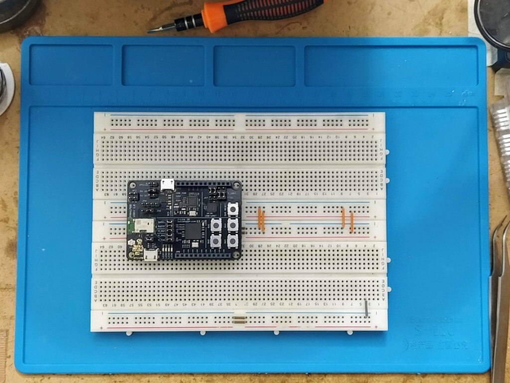

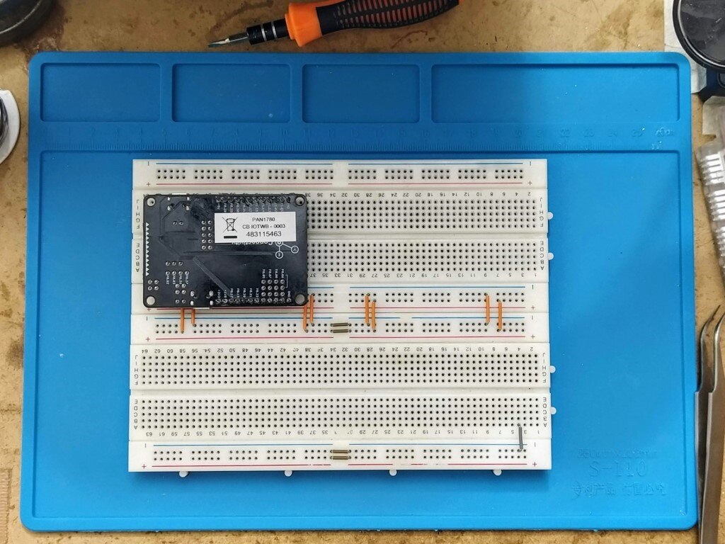

When I first saw pictures of the PAN1780 evaluation kit, I thought “oh they are using the Arduino Uno R3 form factor, I should be able to use the shields I have for the road test.” Disappointingly, it wasn’t the Arduino form factor even though the eval kit had a similar size.
It does have male pins extending towards the bottom, so I thought maybe this can be used for prototyping via breadboard. Again, disappointment reared its head as the pins were just too wide for the usual 5cm breadboards; I had to combine two breadboards and have the eval kit straddle the power rails for it to fit. They do call it a daughterboard in the documentation, so most likely it was designed to plug into some larger test bench.
Unfortunately, the board is just too wide to fit on a single breadboard.
You would need to join two breadboards together and have the eval kit straddle the two in order to have enough space. This might be an issue if (for some reason) you don't have enough breadboards.

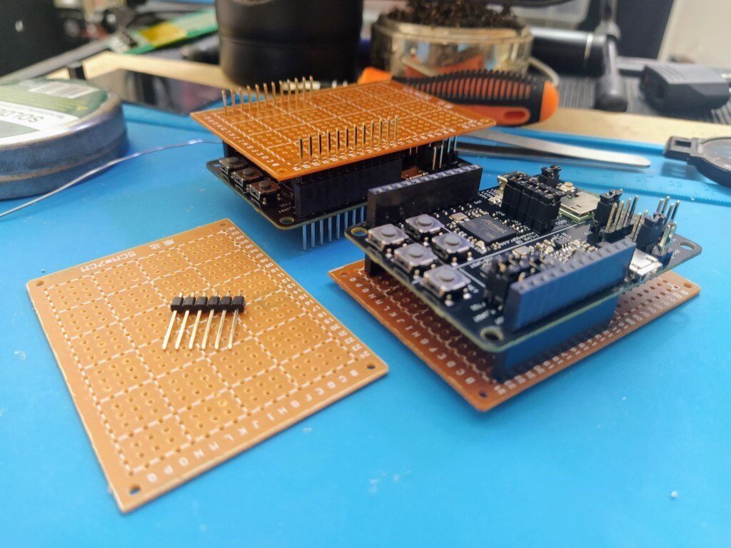

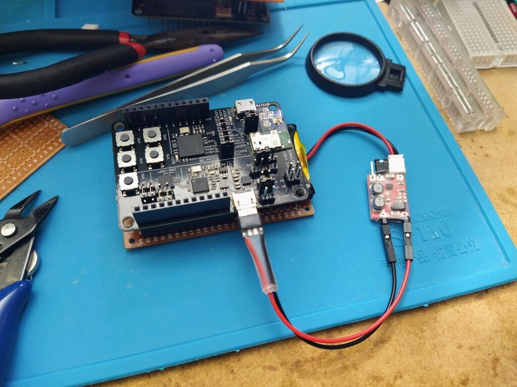

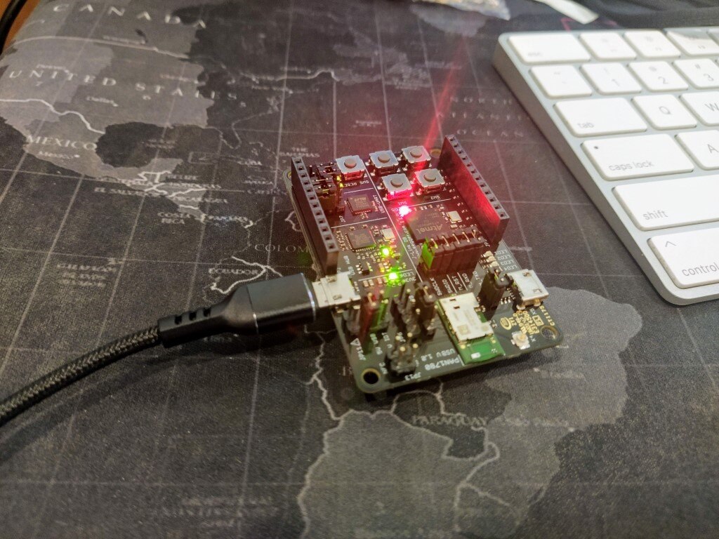

What I do have in quantity however, are those cheap single-sided 5x7cm protoboards. Fortunately, the pins of the eval kit are on a standard 0.1in spacing and I was easily able to make a base and a shield using some female headers and some long pin male headers, respectively. This seems to be how the evaluation kit was designed for when prototyping connectivity with sensors and other supporting peripherals.
Here's my attempt at trying out a baseboard, and a "shield" for the PAN1780 eval kit. While I took the pictures like this, I'll probably turn the boards around so as not overlap the "keep out" area of the module's chip antenna.
And here's one of the ideas I have with the bottom baseboard; aside from adding components directly connected to the gpio, it can also become a holder for a battery, making the whole kit portable.
I do feel that there was a missed opportunity here with regard to support for commercially available, pre-packaged add-ons. There are many available sensors prepackaged for the Arduino Uno R3 form factor, and if the Arduino form factor is a no-go due to the unconventional 0.05in spacing on one of the gpio rows, there is the Arduino MKR pin layout, or the Adafruit Featherwing pin layout (both of which have a considerable following).
Either of these two layouts have support for a large number of sensors and peripherals in their ecosystem, and have the advantage of being already widely and commercially available for an even quicker prototyping. That said, it's not that much of a big deal since, as I've shown, it's not that difficult to add your own baseboards or shields.

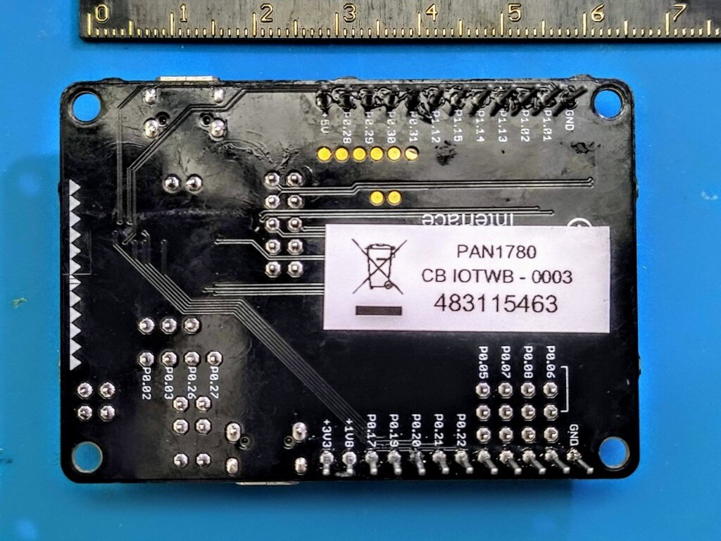

The nRF52840 has a total of 48 gpio, but the PAN1780 has pins 0.00, 0.01, 1.00, 1.03, 1.04, 1.05, 1.06, 1.07, 1.08, 1.10 and 1.11 not brought out, or not connected to a peripheral (or at least I couldn’t trace them to their connection on the schematic).
Another issue is the lack of male ground pins on the top side of the board. There are a number of peripherals like the j-link OB and the ftdi USB to Serial pins that would need a common ground with the interfacing module. Having a ground pin nearby (or at least a few of them in a cluster that's clearly marked) would have been more convenient.
Unlike the nRF52840DK the PAN1780 Eval kit does not have a built-in QSPI for additional flash storage. This might be something to consider when evaluating the platform as QSPI is one of the interfaces headlining the nRF52840.
There is also no 32kHz crystal connected, which means there is no low frequency clock source available and you’ll have to use a synthesized low frequency clock source for your applications. I also don’t see anything in the schematic that indicates the crystal pins are brought out if an external crystal is to be added.

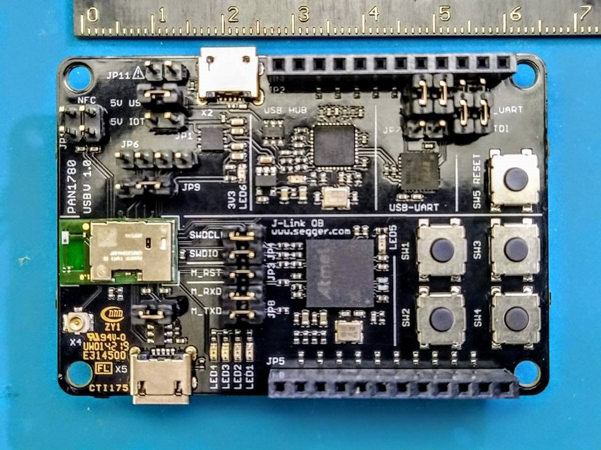

A jumper system is used to enable and disable certain connections. For example, the nRF52840 has two modes of powering: the normal voltage mode, and the high voltage mode, and there are jumpers that would link certain voltages to the corresponding input on the mcu.
One issue I've found though is that some of the jumpers (particularly JP7 as was installed by default) can be difficult to adjust as they are too close to the female headers, or to other pins. I needed to use some tweezers when I had to move JP7's jumpers for example.

Here's a picture from the top, showing the silkscreen labels.
And here's a picture from the bottom, again showing the silkscreen labels. I have moved the sticker that was covering the test points (they were unlabeled, and I'm not yet sure what they are).
This probably isn’t as much of a big deal as with the Nano, since we are unable to use the kit with a breadboard as efficiently anyway. It does however still cause minor annoyance, at least in the prototyping stage where you just want to plug in a sensor on top using some DuPont wires without bothering to design (and etch) a PCB.
I suppose that in a professional environment, where dozens of engineers will have access to the same eval kit as well as sensors adapted to this form factor, this problem is minimized. In a maker or hobbyist scenario though, it may increase the chances of mishaps when accidentally plugging into a power pin instead of a gpio.
Another issue (which is likely due to the density of the components on the board) is that while there are generally identifiers, the specific jumper pins to various external components aren’t labeled. For example, the pins for the USB to Serial functionality (JP7 and JP10) don’t mention which of the pins are TX, RX, CTS, and RTS. It also isn’t immediately obvious in the documentation to which pins of the nRF52840 TX, RX, CTS, and RTS are actually connected to; you’d have to ether consult the schematic for that, or look underneath the board for the silk screen (it’s P0.6, P0.8, P0.7, and P0.5 respectively in case you’re wondering).

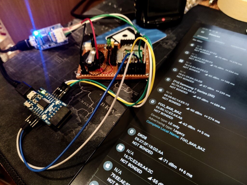

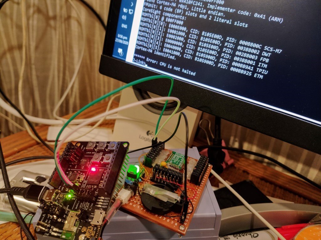

Here for example, is a bare module running the Mbed OS ble cli example app (see ARM Mbed OS on a Bare nRF52840 Chengdu Ebyte Custom Target  for the blog post about this). I had to use an external FTDI adapter to facilitate the serial communications; the PAN1780 wins in this regard because it already includes the FTDI chip.
Speaking of j-link, while there was no explicit mention of a debug out feature, the fact that the j-link and the swd pins of the nRF52840 are bridged together via jumpers mean you are able to use the onboard j-link device to program a chip other than the one on the board (and vice versa; you can use an external programmer to program the nRF52840 onboard).
Here for example is a bare nRF52840 chip being programmed via the SWD using the PAN1780 eval kit's j-link programmer. See more about the bare nRF52840 chip on my e14 blog posts about it: Trying Out the Chengdu ebyte nRF52840 Module You don't see it here, but the common ground is connected to the underside of the eval kit; as mentioned previouslt the top side doesn't have clearly marked ground pins that can be easily used for these tasks.
While using an eval kit's onboard programmer is frowned upon when programming chips in commercial quantities, if you are a hobbyist or a maker that would like to dip their toes in the ARM ecosystem, having access to a proper SWD programmer is a must. The cheapest j-link that Segger sells would be the j-link edu minij-link edu mini, which already costs about half of the eval kit and still isn’t allowed to be used for commercial purposes.
Oftentimes the advice for makers would be to get one of the Nordic development kits as that includes a j-link debug out capability (again only to be used for educational or personal purposes). The PAN1780 Evaluation Kit has this advantage as well, and the smaller form factor might also be an advantage (the Nordic development kits were notorious for being really large when all you wanted was to use its onboard programmer).

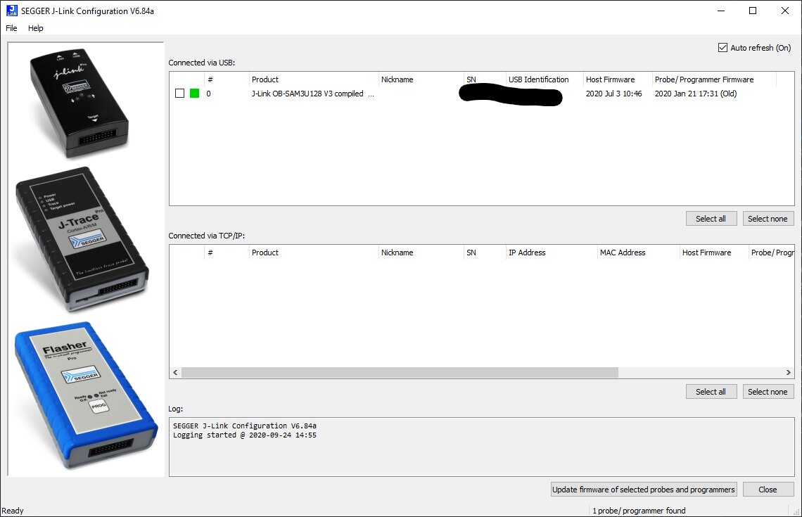

Here's a screenshot of the j-link configurator while upgrading the firmware on the j-link OB of the PAN1780 eval kit.

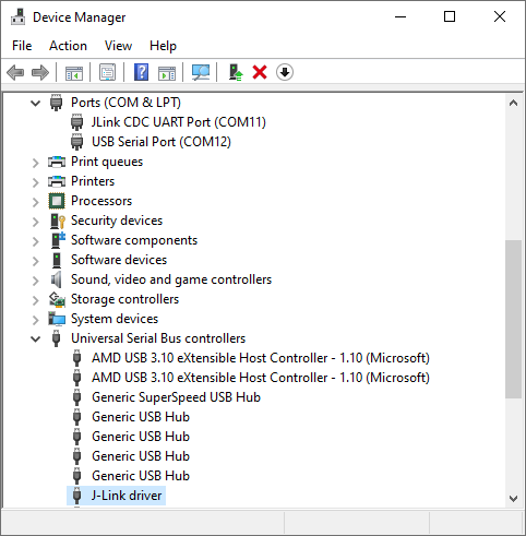

Note however that unlike the nRF52840 DK's j-link OB, the one in the PAN1780 eval kit does not create a disk drive that you can drag and drop hex files onto for flashing. This means that it's not immediately compatible with Mbed OS; you'd need a two step compile-upload procedure in that case.
On Windows 10, the j-link creates two COM ports (CDC and Serial) as well as a USB device with the "J-Link driver" label.
