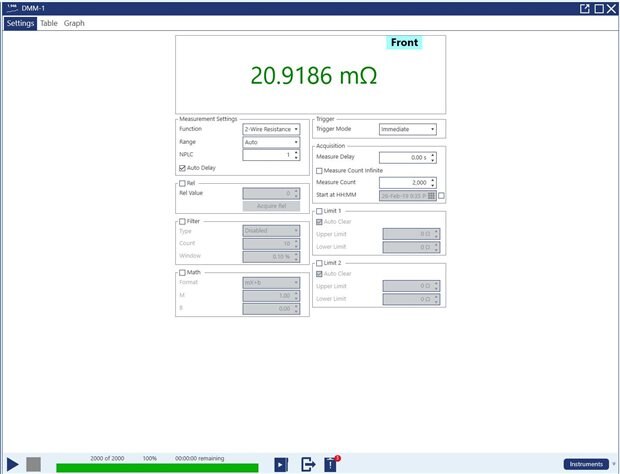

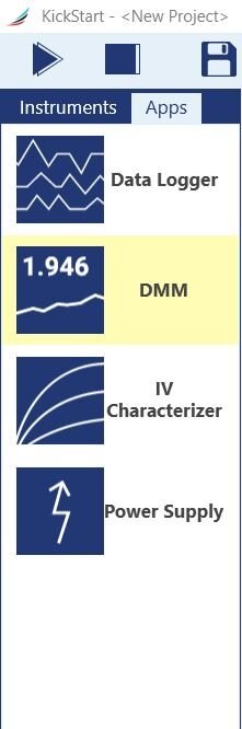

KickStart software is a freely available PC tool from Tektronix  for data visualizations. This tool supports multiple instruments simultaneously but currently I am only using one DMM 6500 for tests. The software also supports power supplies, source measure unit (SMU) instruments, and dataloggers. The tool supports instruments connected using GPIB, LAN, and USB interfaces. The tool does require a license which can be acquired by registering the device on the Tektronix website and generating a free license. The software is easy to install and get started with.
Fig: The App window in Kickstart
Automate measurements from DMM6500 using KickStart

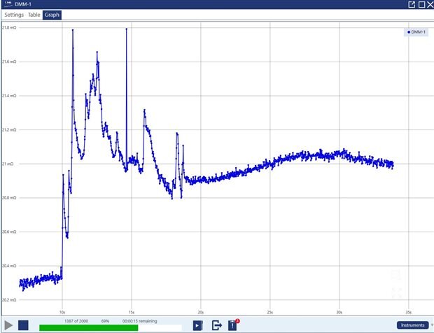

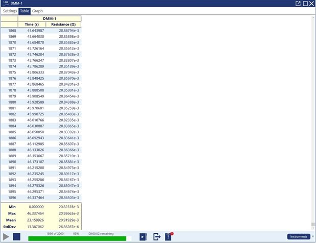

Below I did some measurements with the KickStart software for low resistance measurements (0.01ohm 50W resistor)
Fig: Plotting graphs with collected 2000 samples of data
