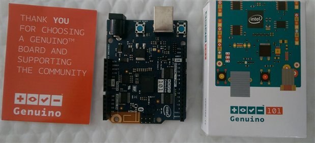

Here is the Genuino in all its newfangled glory. It arrives crisp and clean, just like the Arduino Uno and Yun did.
Notably missing when you open the box is the lovely stickers that came with the Arduino Uno model. It's rather insignificant but it always brought a bit of extra joy to opening these guys.

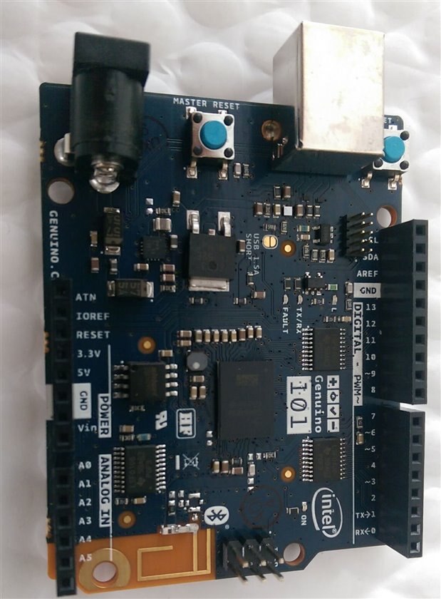

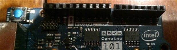

Let's take a look at the board itself! Honestly my first impressions on the layout were somewhat disappointing. Things I noticed:
  • Header pins on the digital side do not line up well. This could be a concern if your stacking shields onto this thing. This is slightly noticeable on the analog pin header side as well, but not as bad.
Here is another shot of the header alignment being off.

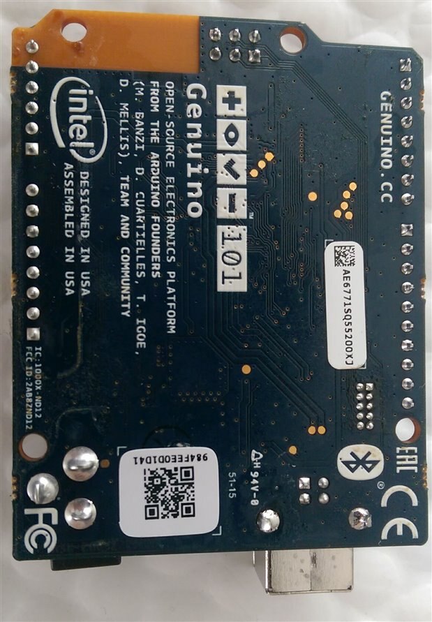

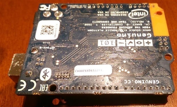

On the bottom side, I see a lot of leftover gunk on this board. I assume that most of these is not super hazardous material, but the board arrives quite frankly filthy.
Some more shots of the gunky board. Not sure what it is, leftover flux material? I never thought I'd be so pick with this (especially since I received the board for a review), but I think my hang-up with the cleanliness of these electronics is that they're now being marketed and popularized to younger and younger generations as they get into the maker space. If this is something we encourage, we should ensure a standard on cleanliness and manufacturing so we know contaminates are being left on the boards.

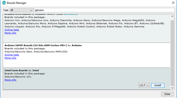

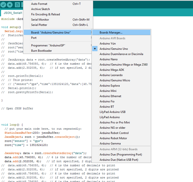

Step 1: Go into Arduino IDE, and select Board Manager.
Next step: Install Intel Curie Boards package.

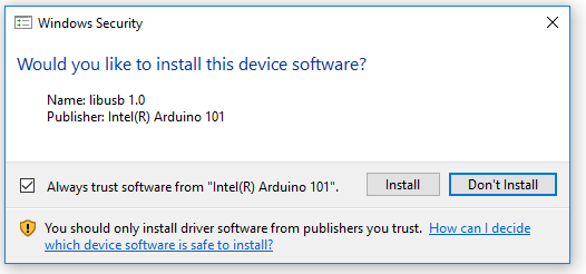

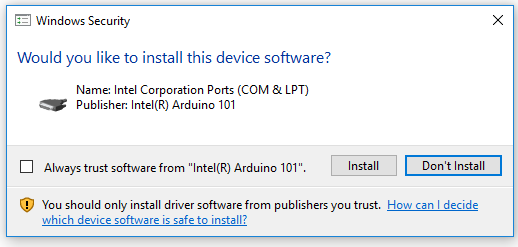

Next up, your machine prompts you to allow installation of your hardware.

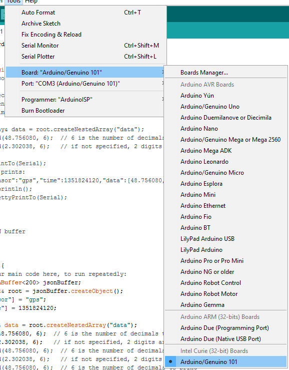

After this, you should see this as a proper device in Device Manager and as a Board entry in Arduino IDE. Looks like we're good to go!

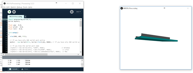

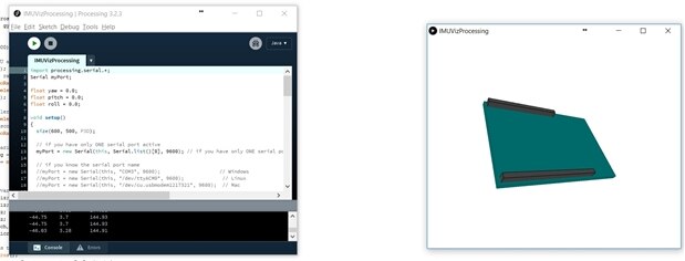

Firsts steps with this board are not too difficult because there is already a decent amount of tutorial documentation out there for this board. For a great first demo, I followed the orientation visualizer tutorial. This demo uses the data from the onboard accelerometer and gyroscope and performs some math (Madgwick filter algorithm, which was developed by Sebastian Madgwick during his PhD in 2010) to integrate this data and obtain quarternions which can represent the orientation of an object in free space. This is a pretty big deal mathematically because this is usually fairly hard to compute quickly and efficiently. With this algorithm, we can take velocity and acceleration data and integrate to obtain position data and represent this in real time. The tutorial makes it pretty easy for anyone to get started. You basically load up their Arduino script, ensure you install and include the Madgwick library, and then run some additional code in an open source software called Processing so that you can see the orientation data in real time.
The result is shown below in pictures.
I've also demonstrated the orientation visualizer in action in a video here. Note what I mention in the video is a drift in yaw orientation data. This is something that is generally unavoidable, because we are integrating acceleration data to obtain position and orientation data. The result is that when the device is in motion we really get more accurate readings. But if we keep the device essentially stationary, the double integration from acceleration to position will take the smallest noise measurements and misconstrue this into actual movement data, hence why my device is rotating in yaw axis over time. This error in integration accumulates overtime when we do dead reckoning using gyroscope.
I think this is amazing that we can so quickly get orientation visualization running on this device. This is a definite boon over something the Arduino Uno, even though it should not be so daunting to buy and connect 4 wires to an IMU to get some accelerometer and gyro data. The fact the IMU is built into the Genuino 101 enforces consistency and hence allows great example code and libraries to be put in our hands, allowing very quick learning. This makes this device a great candidate for someone who is new to microcontrollers, but quickly wants to use an Arduino type MCU for a robotics, wearables, or fashion project. No need for time to be wasted learning about, researching, and integrating an IMU if you have a school project or something to worry about. This is actually very similar to how I applied the Genuino 101 in my research, because I needed to quickly test out an IMU hypothesis for a medical device prototype I was designing, but didn't want to worry about buying an IMU and testing it out.

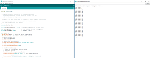

The step counter tutorial was also excellent because it could again help a novice user (like me) to very quickly get the footing required to design, test, and prototype a custom wearable device. I didn't end up needing step counting for my Master's thesis work so I didn't delve into this script in detail. It looks like the step detection is probably triggered by a movement exceeding a threshold g force and this could be configured by using a command like the below.
CurieIMU.setDetectionThreshold(CURIE_IMU_SHOCK, 1500);

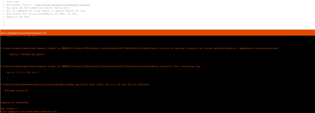

I'm completing a master's of engineering and wanted to try integrating this into some of my hardware prototyping in place of the standard Arduino Uno. The Genuino 101 functions like the Uno in most respects but I ran into some isues when trying to run some Arduino code I built to take readings from the Omron pyroelectric sensors.
Omron
Because of the sensors create so much data, the standard Wire.h buffer is apparently not big enough for reading the sensor data via I2C, so some people have taken the approach of using a custom version library called WireExt.h. However when I tried to compile my script that contained WireExt.h, the compile would crash because it was trying to include avr/io.h but it couldn't find anything. I guess this is because Genuino 101 is Intel Curie and ARC based instead of Atmel and AVR based. I didn't really have the intuition and know where to search for a solution, but I bet if I posted in the Arduino forums, someone would likely have a pretty easy work-around that I could attempt. That said, this was where I hit a roadblock in using the Genuino, and had to put it away for the time being and switch back to Arduino for my project.

    Nice review. I hadn't tried the accelerometer, so it might be a something for a quite night or a rainy day. The 'gunk' is poor flux removal. I've also seen it turn white with the ambient moisture. You…
