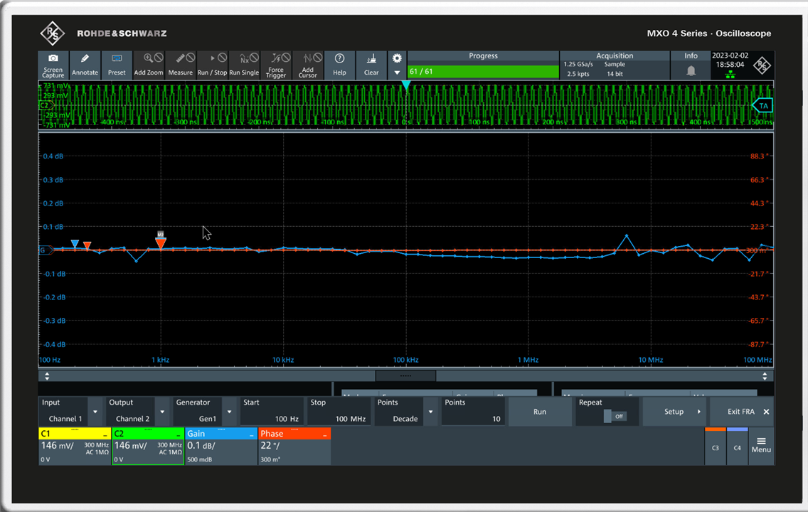

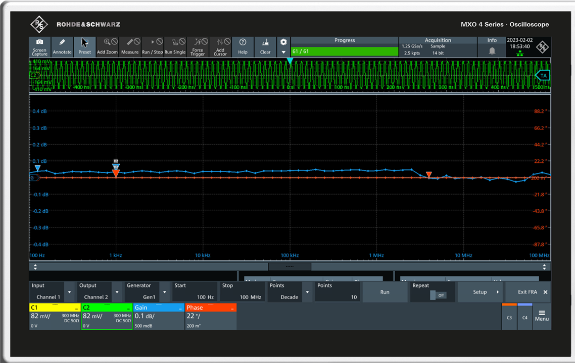

A Loopback Test of the FRA
First off I linked the generator output to a T connector via a short BNC cable and each arm of the T to C1 and C2 on the scope using the same length (about 30cm) BNC cable.
Symmetrical BNC cable loopback, 50R terminations
Symmetrical BNC cable loopback, 1M terminations
These are reasonable plots showing less than 0.05dB error in either case.

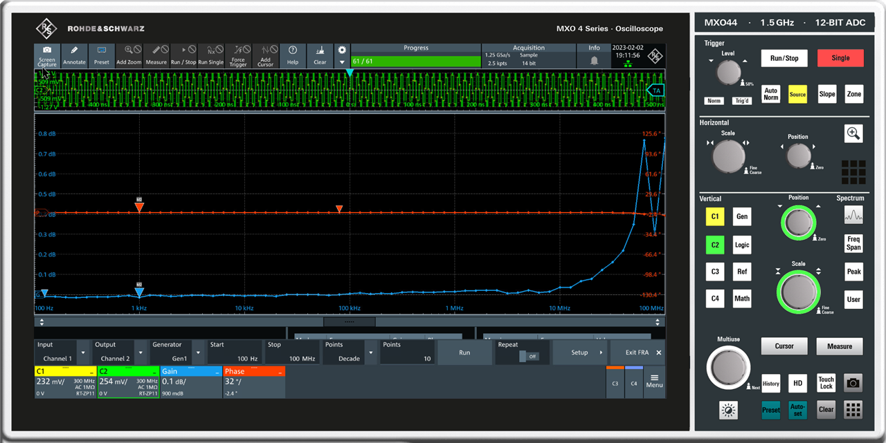

Then I connected the two measuring channels using the supplied R&S 500MHz 10:1 passive probes. They were connected to the generator using a short stub of co-ax cable:
The resulting plot was not so nice, the precise arrangement of the earth leads making a significant difference. I changed the design of the co-ax stub to improve its symmetry:
R&S probes with symmetrical co-ax stub:
The probing error is quite significant. As delivered the probes were adjusted to this level. I tried adjusting them (using the usual square wave cal procedure with the built in cal generator) and couldn’t get them back to this good a match without doing the pair simultaneously - a point to note!

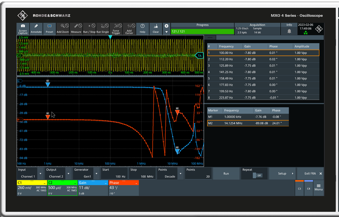

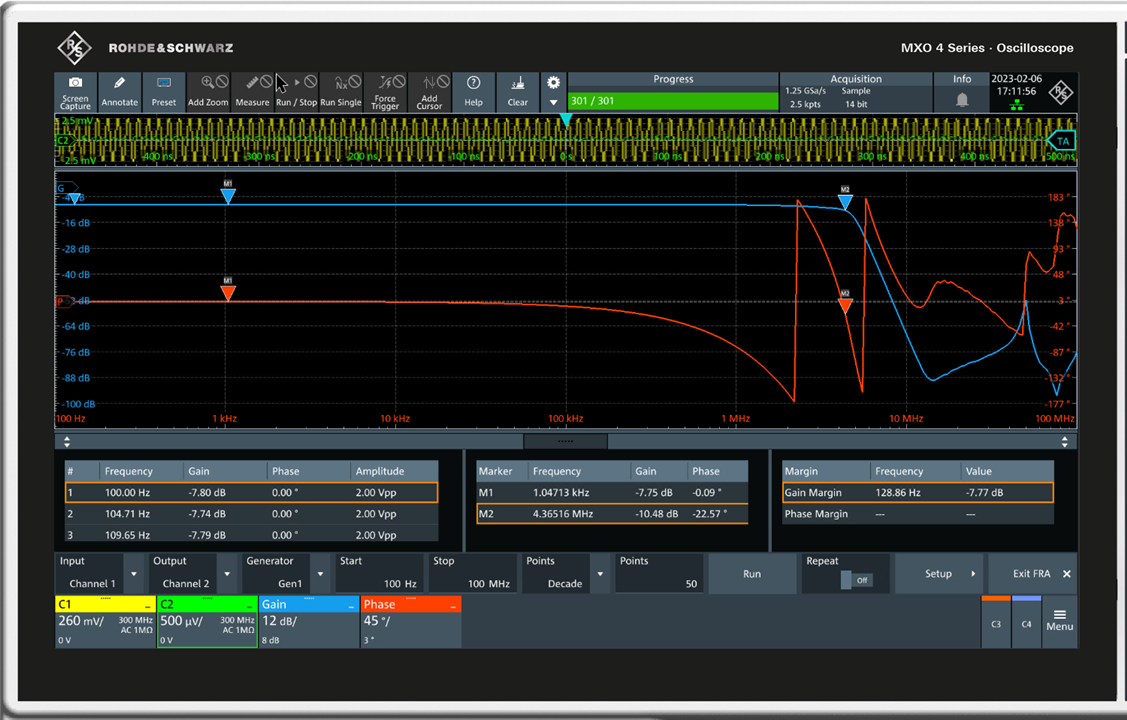

LC filter response

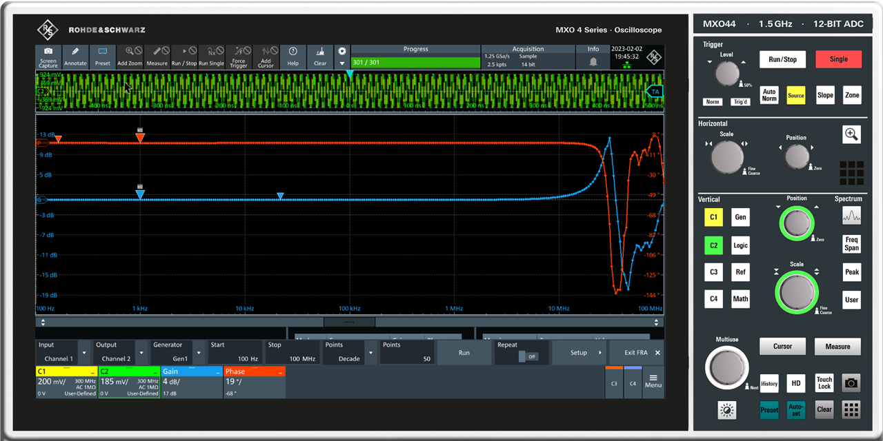

Loopbacks are all very well and the insights to probing quite interesting but what we really want is to measure a real filter. This is an anti-alias filter for a data acquisition system. Its designed as a 220R impedance to reduce internal power consumption so there is an insertion loss when it’s padded to 50R operation.
In this  plot I’m letting the MXO4 data show up and the markers have been set to sensible places.
It’s not a bad filter up to 20MHz or so but that nasty peak at about 80MHz needs work !
A bug ?
There is a bug in the FRA that affects the use of markers.
In many views on the MXO4 you can click on a box containing text like this one from the screen shot above:
And the multipurpose control will change colour to indicate that it can alter the selected item. The control knob lights up OK when you click on the marker box but it has no effect on the marker position. If you click on the actual marker in the graph with the mouse (or by finger touch) then the multipurpose control becomes operational.
This is a real nuisance because the markers can easily move to the extreme right or left of the graph window when you change a setting. When they are at an edge it is almost impossible to select them by mouse or touch because other things get selected instead

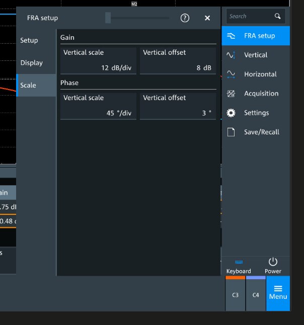

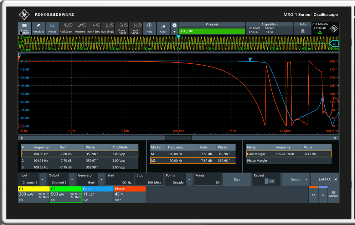

I didn’t like the scaling much and I certainly don’t like the phase zig zags . I tried to improve matters using the FRA set up controls.
The picture of this window in the manual (version3, latest known) is different:
I couldn’t find a scaling option for phase that I liked.
You can use the R&S “smart screen” to re-position the sub windows on the screen.

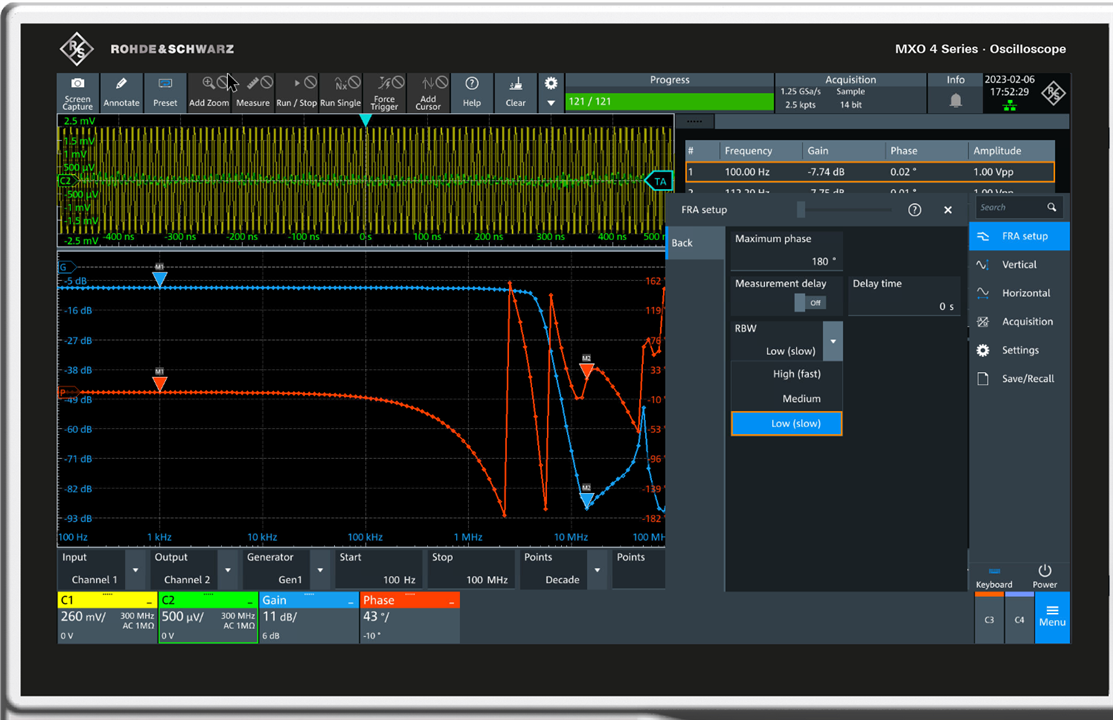

I’ve set the markers to allow me to measure the depth of the filter minimum. It would be nice to get a display of the difference between markers and/or to be able to set a marker as the amplitude reference point but there doesn’t seem to be a way of doing this.
I had another go at tweaking the phase display and found the RBW control. This sets the measurement bandwidth. The manual doesn’t say much:
RBW
Sets the resolution bandwidth.
Remote command:
FRANalysis:MEASurement:RBW on page 518
Well, at least it tells us what RBW stand for!
What it doesn’t say is what the bandwidth is actually set to, other than Low, Medium or High.

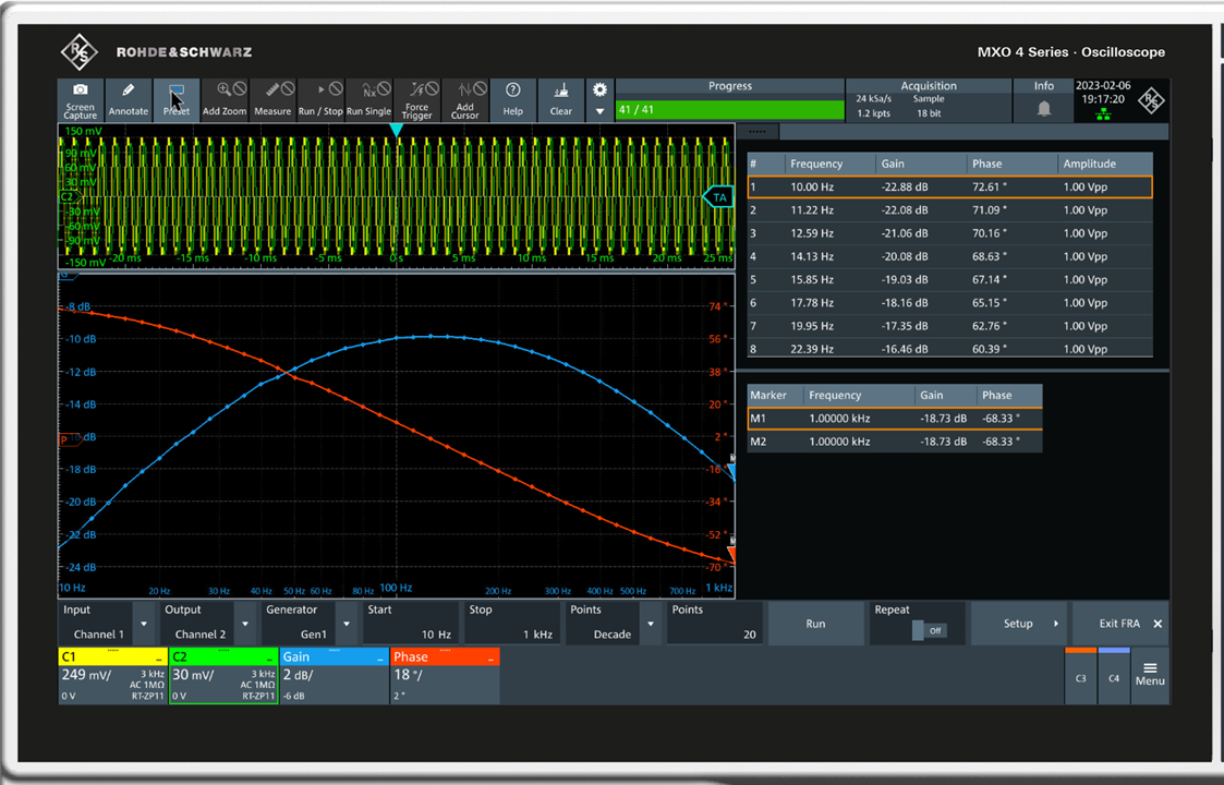

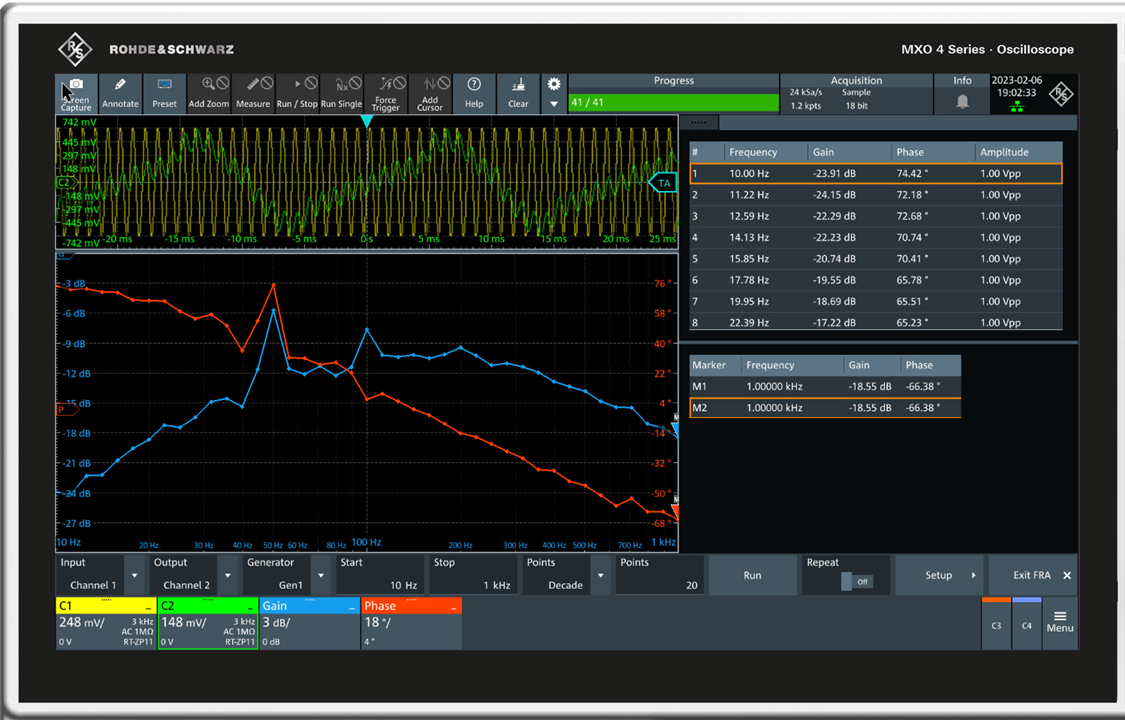

A Noisy Wein Bridge Filter
I’m interested in attempting to make a lower distortion replica of my HP654A signal generator. So I’ve been collecting multi gang air spaced rotary variable capacitors to make the required Wein bridge oscillator.
There’s plenty of stuff about them on the web if you want all the gory details.
The basic circuit is:
A standard multi gang variable capacitor has all the sections commoned on one side to ground. This is a pity because that means that the centre of my bridge (at ch2) is the chassis of the capacitor and it’s going to be very sensitive to picking up mains hum. The values on the diagram will oscillate at about 120Hz.
If a 10M scope probe is used at CH2 then R2 is omitted and the probe resistance forms part of the filter.
The built circuit looks like this:
The 10M resistor is just visible (attached to a green wire) at the far end of the capacitor.
We expect this to be noisy but hope that the filtering on the FRA will sort things out.
The shape of the filter is visible but it does look rather horrible.

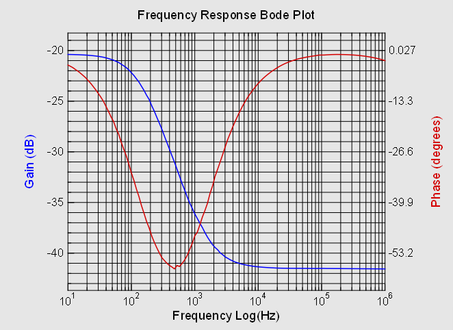

The basic response at ch2, S1 open is:
I would be happier not to see those 0.05dB quantised jumps – it’s not that they are wrong – just that they look like some internal numerical rounding not done quite right.

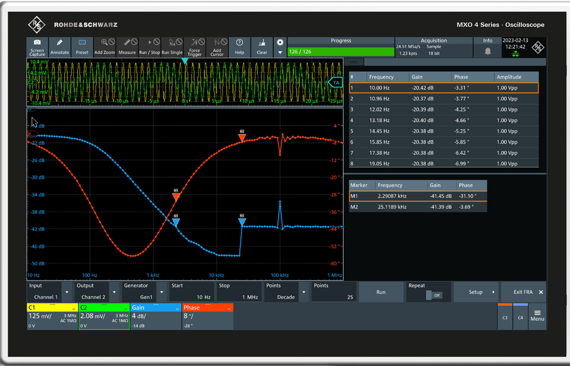

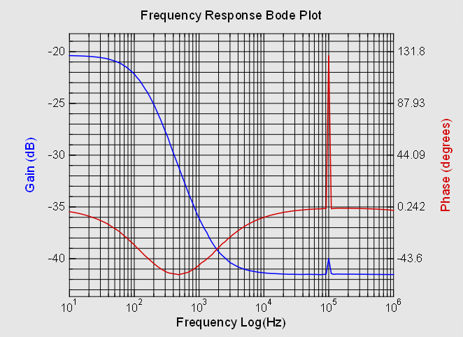

Next we inject 1Vpp of interference (same level as the scope generator signal) at 1kHz.
The error at the interfering frequency is inevitable and harmless – but why do we get 7dB of error at 1MHz ? This is with a the RBW set to low.

Ok, so now we know – the test box procedure is fine – its just that the MXO4 with FRA can’t cope with it, but three out of three other scopes with FRA options get it right.
Just to be absolutely sure I tried the MXO4 again:
Same as before – so as far as the FRA is concerned that’s a show stopping bug. For example, one of the applications promoted for in-scope FRAs is checking the closed loop characteristics of switching power supplies.

    I should think that the engineers at R&S will be able to find it very quickly from what Michael has given them. Let's hope it is something that can be fixed in the firmware.
    shabaz over 3 years ago in reply to jc2048
    Sorry, just saw this (forgot to turn on Comment Notifications). I assumed that was some change on the input during the test.
    Yes that is weird, I can't see how the amplitude could shift like that! It looks like an input gain setting changed or something : ) Almost as if they are using the amplitude in a coarse frequency bucket to adjust some input gain or offset, which makes no sense, since that shouldn't be frequency-dependent, and that unexpected amplitude is causing the error for a large chunk of the measurement. The shape of it might be correct, but shifted higher. Really bizarre.

    That's right - the spike and phase errors at the interfering frequency are expected and can't be avoided. The big problem is the large errors in amplitude which are spread over a wide and not very obvioulsy related frequency band. And completely absent on the other instruments, including the RTA4004.

    The interference signal that Michael is adding is phase incoherent with the oscilloscope's generator, so won't it be a bit random what the display shows for the amplitude and phase at the interference frequency? I think what he's concerned about is it getting the amplitude response of the filter wrong elsewhere when the interference is present.
