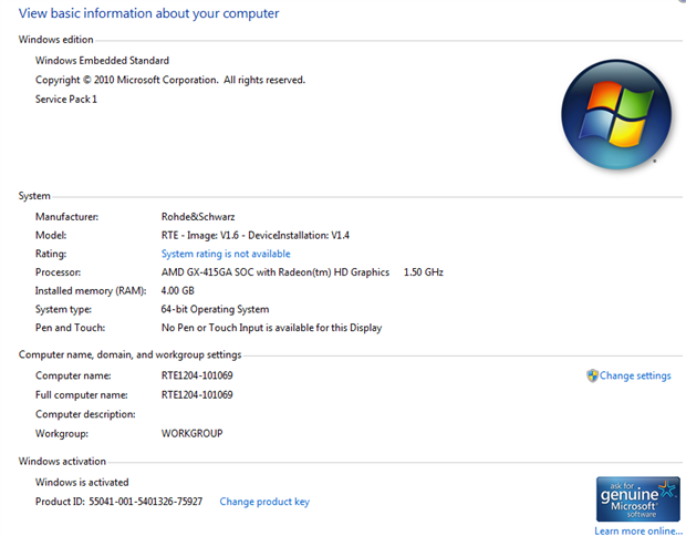

1.5 Computer
Because this is a scope with an embedded Windows interface, the computer running the OS also deserves some attention. The specifications are shown below in screenshot 2.
Screenshot 2. Computer specifications
While its not very powerful by most modern computer standards, it seemed to have more than enough power to chug through whatever I could throw at it without any signs of slowing down. The oscilloscope application does indeed eat up a lot of power when running many SmartGrid screens at once with measurements and especially FFTs and spectrograms. In video 13, I show a case where I am using a significant amount of processing power to display two simultaneous FFTs and spectrograms.
