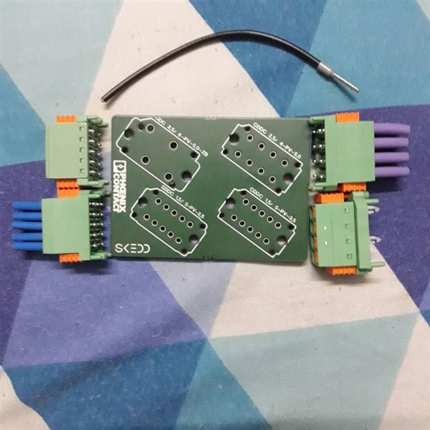

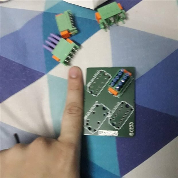

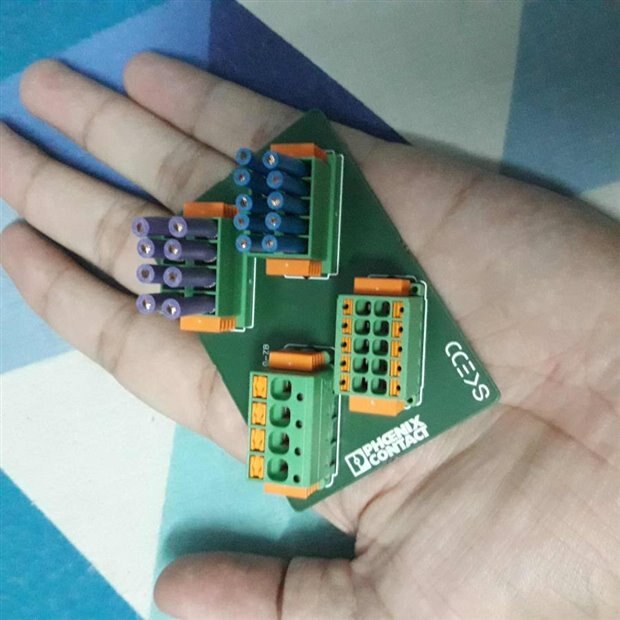

I received the Phoneix Skedd Connector Kit in a neat white box shown here and was really excited to test this out. I admit that this review comes quite late and I am really sorry for that. My university is putting too much pressure on us students in this online semester. Daily quizzes and assignments are killing the hobbyist inside me. Enough of the ranting. Let`s get to the review.
The connectors are essentially through hole wire to board connectors in various pin counts that can be push-fitted into a PCB hole.

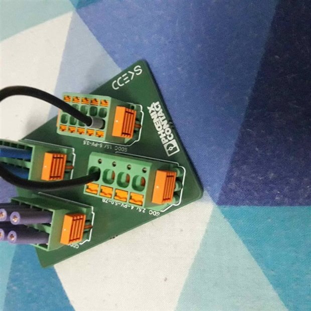

The orange insertion at the sides adds extra mechanical protection to the connector from being removed accidentally. The datasheet specifies the mechanical life as 25 insertions which seems to be much more given the sturdy design

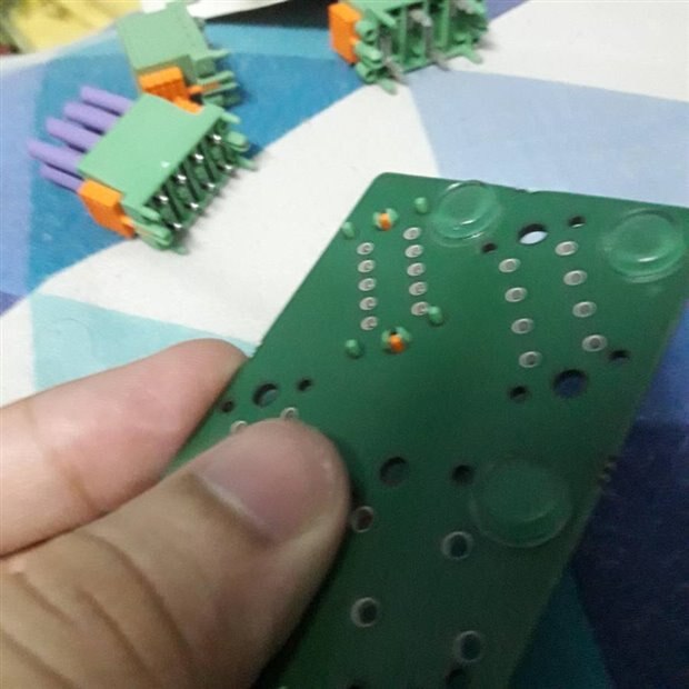

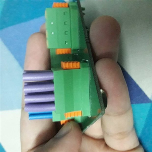

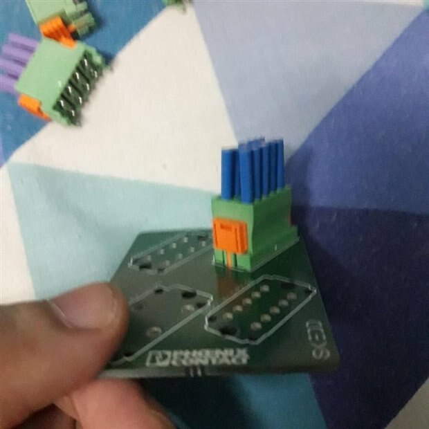

This gives a good bottom view of the connector while inserted in the PCB.
You may clearly see the mechanical attachments in the picture.

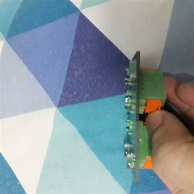

This is the side view of the connector inserted in the PCB.

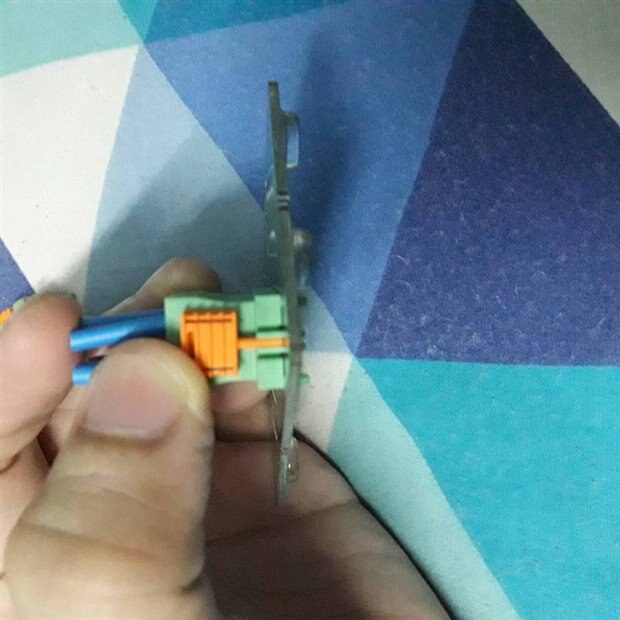

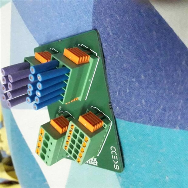

An oblique view showing the connectors inserted in the sample PCB

Holes are just too large to allow for the mechanical locking which wastes space on the PCB
