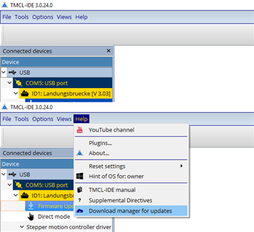

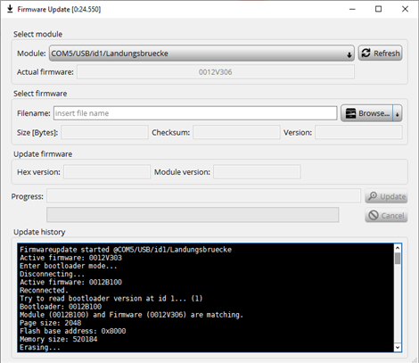

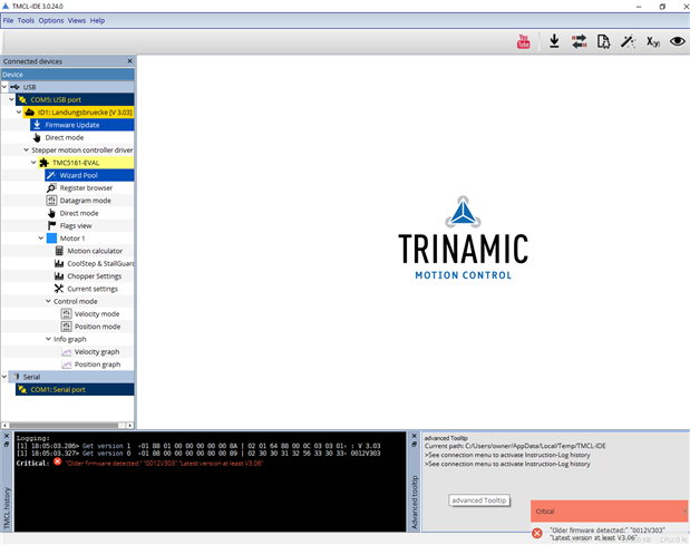

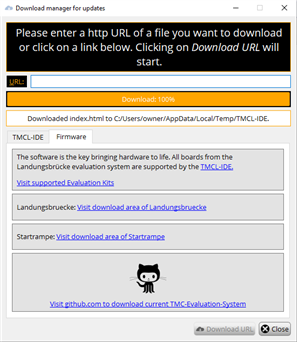

I fired up the IDE and it immediately reported the there was old firmware on the Eval board. I took the attitude of "what's the worst that can happen" and clicked on the Firmware update button. This asked me to select a file and I had a look around the installed folders but there was no firmware to install from there. Looking around the menus I found "Download Manager" so I selected that.
Clicking on the Firmware tab produced a list of URLs, so I followed the Landungsbrueke one and downloaded the latest firmware, "Landungsbruecke_v3.06_BL.hex" Then back to the update firmware to select the downloaded file.

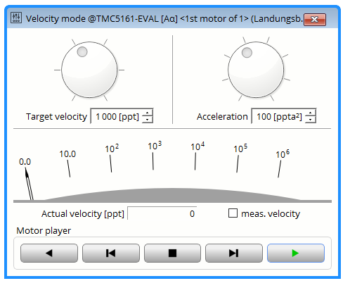

That installed fine so I headed to the velocity mode and tried to get the motor to move. Nothing happened to start with so I rebooted the board and tried again.  This time the motor did move.
I've not yet worked out what the velocity setting is measured in, perhaps steps per second? It seemed to be running ok so I dialled it up to 100,000 and got quite a lot of vibration from the motor. The powersupply seemed to be behaving erratically so I incremented the current limit to 1A. This didn't seem to help and I noticed that the voltage measurement had increased to 9.2v so the powersupply seemed to be fighting it constantly to regulate that.  Reducing the speed back down to 10,000 sorted things out. So for my testing I'll be running it at these lower speeds.
