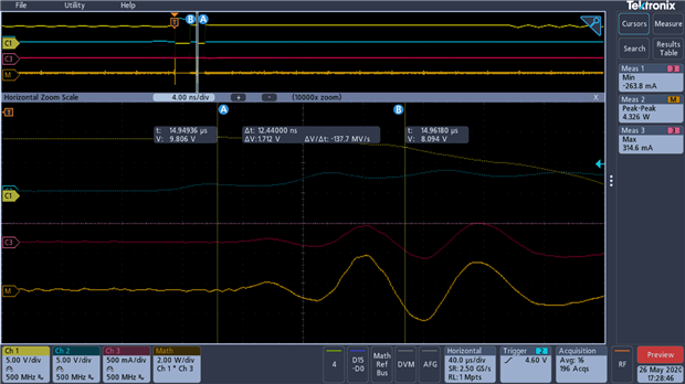

Timing characteristics were successfully measured for the MOSFETs. The 'on time' for the MOSFET is extracted from a measurement from the rising slope of the second pulse. The time differential is measured between 10% of the switching pulse ramp, which is 1.2 Volts in my case, to 90% of the Vds ramp, which is 8.1 Volts for my test. This is referred to as 'td(on)' within the standards and is identified in most of the data sheets I have for the MOSFETs I am testing.
In the two screen shots below, the traces are all measurements across the bottom MOSFET. Channel 1 is the drain-source voltage, Channel 2 is the gate pulse applied, Channel 3 is the current through the MOSFET, measured off a 1 Ohm resistor in series with the drain connection and the Maths Channel is the Voltage multiplied by the current.
The 'off time' is taken from the descending slope of the first pulse. The measurement point is taken between 90% of the switching pulse, 10.2 Volts, and 10% of the Vds voltage, which is 0.9 Volts for my test setup. This is referred to as td(off).

Based upon the data obtained the energy consumed during the switching process can be calculated using either the integration function on the oscilloscope or a manual calculation detailed in the Tektronix application note.
The other measurement made was the reverse current through the body diode of the first MOSFET as the electric field in the pulse transformer collapsed after the bottom MOSFET is switched off. This reading is captured with the voltage across the first MOSFET alongside the drain current measurement. The Tektronix application note carries this test out at a supply voltage of 20 Volts, but as may intention is to test the MOSFET performance in the insulation test output circuit, I kept to the 9 Volts supply I was using. As a result, the leakage currents are quite low and not so well defined in the oscilloscope traces.
