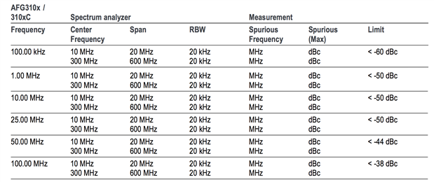

This test, also defined by Tektronix, looks at the spectrum analyser readings at three frequency points and is a basic test looking for any spike that are above a defined dBc limit. Five frequency points are utilised with a 1 Vpp sine wave. The spectrum analyser is set with a much higher bandwidth than the previous tests and whilst there is a test specification for the spikes, it is also interesting to look at the various screenshots from the spectrum analyser.
The table below shows the highest spike observed at each of the test frequencies. It looks like the majority of the instruments cannot perform to the higher specification of the AFG31052. There are several points, especially at the 100 kHz test that are not up to specification. Overall, the UTG962 seems to have the noisiest output.
