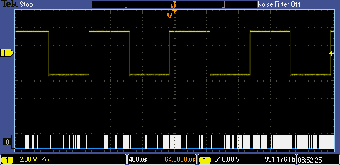

In my testing I also discovered a few other issues, one of them is that the scope attempts to auto detect your probes as they are hooked up.  I had all 4 probes attached and the logic analyzer probes hooked up,  probe one and the logic analyzer were both receiving a signal as shown below.
However, when you enter the About menu, it does not show them attached nor does it receive the signal that I was sending it.  This tells me that the firmware that is currently loaded on my scope is definitely not completed.  I do look forward to upgrading it in the future, when some of the features such as the test button have been implemented.
