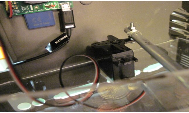

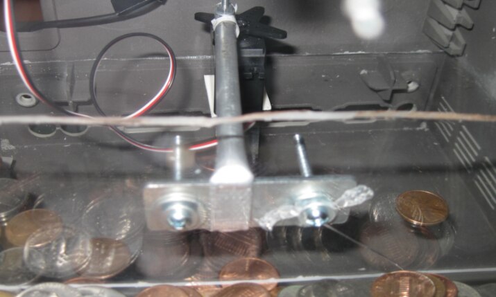

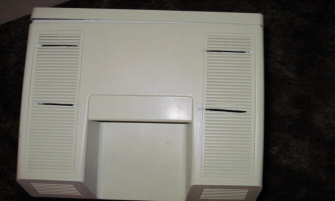

Project: The entire Pi Dozer in enclosed in a classic Macintosh Plus case. I had prevoiusly gutted out the contents of the mac. The Pi Dozer main brain is the Raspberry pi  which has a servo and LED connected to it. The servo is connected to a rod which attached to a piece of acrylic. The servo and Lever attached to the servo are on a sheet of acrylic which is 2 inches elevated from the bottom of the mac floor. The coins fall from a slot which is located on the top of the mac. As the motor pushes the coins near the edge as coins fall of the acrylic bottom they are captured underneath (shown below). There is also another slot on the face of the mac which allows coins to come out (WINNER, WINNER! Chicken dinner!).
Below is the Python code used to drive the servo with the Raspberry pi. It isn't the prettiest code but it gets the job done.
*NOTE: One thing to keep in mind when hooking motors up to your raspberry pi is that sometimes these motors produce back current so it is a good idea to put a diode on the connection so that the back-flow is prevented.
Code for the servo
Pi and Servo

The Lever Pushing some coins into the slot and trap under neath the slide.
The Pi mounted on the back, the lever servo coins on slide and coins underneath wear the are trapped and stored.

Top view these are the slots in which you can push coins through.
