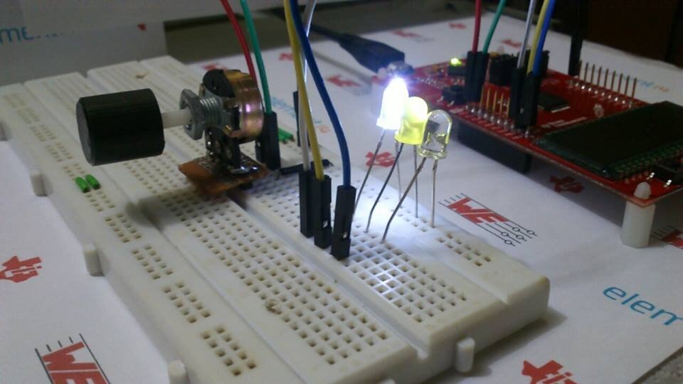

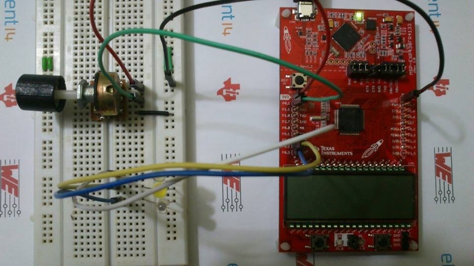

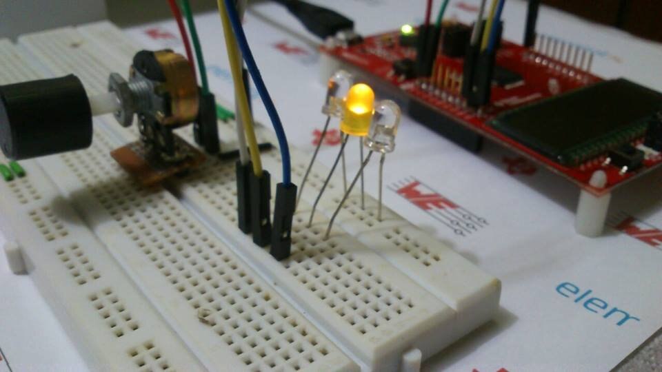

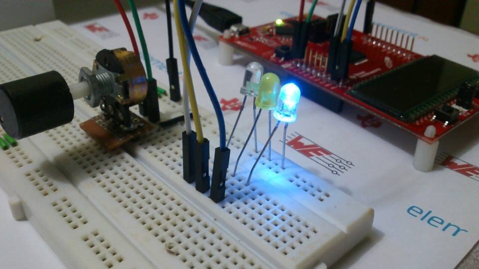

Before going to get started with my Roadtest idea I just wanted to test trial my idea with simple trial project which will be the miniature model of my big project, well for me it's BIG image
The idea is, using potentiometer to input various level of range voltage input to ADC channel and switch three LEDs accordingly on/off, which is exactly my Smart Vehicle Headlight idea.
My BAD maths of this project:
Potentiometer analog input = A (variable)
Voltage = V (3.3)
10 bit ADC resolution = R (1023 (0-1023))
The needed formula will be:
A×(V÷R)
Which will be:
A×(3.3÷1023)
If the analog input range is from 750 to 1015 which will be assumed as nearly dark atmosphere, then turn on white LED.
This will be 2.41V to 3.27V input ADC voltage range to turn on white LED.
If the analog input range is from 500 to 700 which will be assumed as medium light source environment, then turn on yellow LED.
This will be 1.61V to 2.25V input ADC voltage range to turn on yellow LED.
If the analog input range is from 100 to 450 which will be assumed as enough light source situation, then turn on blue LED.
This will be 0.3V to 1.45V input ADC voltage to turn on blue LED.
The trail project is successful as I am expected to be...
