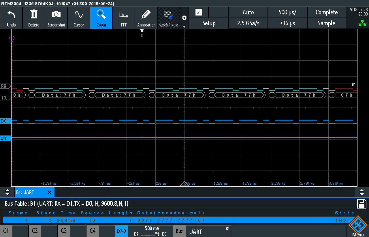

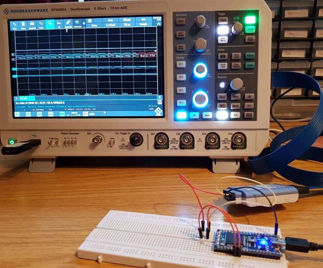

Testing the UART Protocol
A simple set up using the MBED board was used to measure the UART RX and TX as shown below.
Fig: Test Setup
Fig: Setting up and Measuring the UART TX and RX
Fig: UART Measurement Result

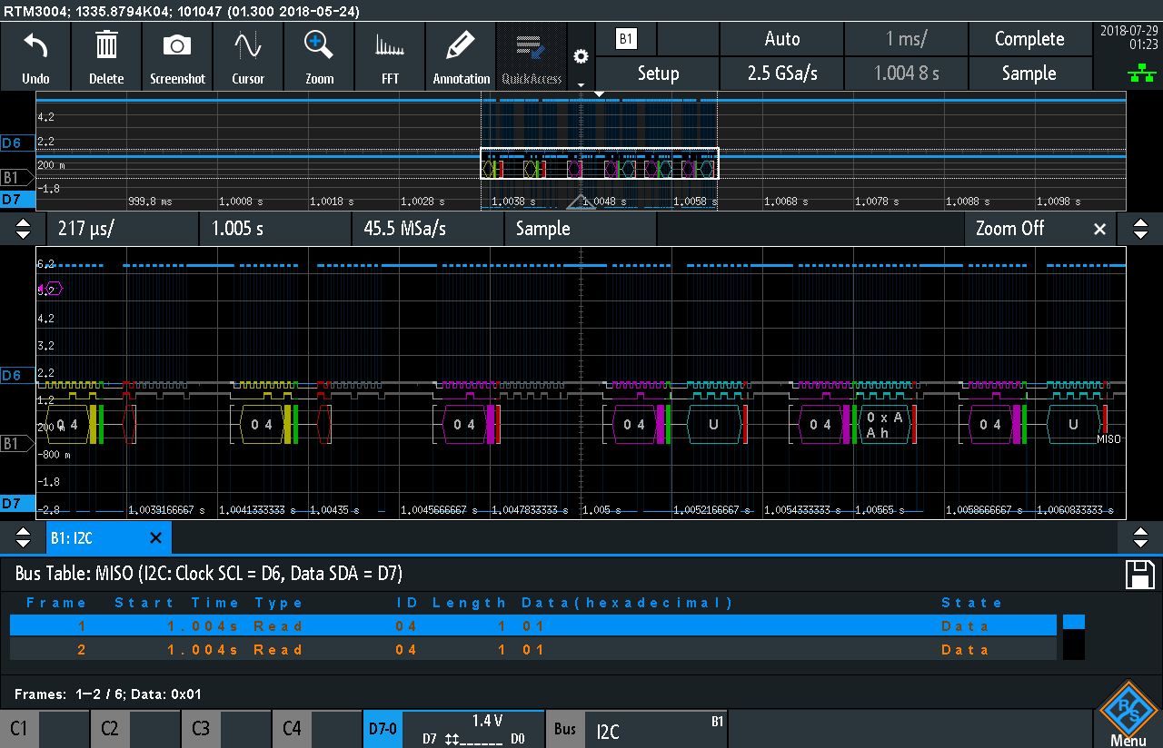

I2C Protocol Measurements
Using the same setup as above I2C protocol was activated and measured as shown below.
Fig: I2C Protocol Measurement Results

Clearly the RTM 3004 offers many digital bus decoding protocols; some of which have been presented here. This scope acts as powerful tool for digital designer engineers.
