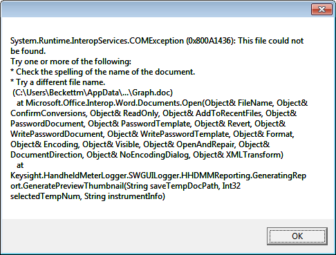

5.     I accidently clicked on the Reports tab and it provided some piccys then a windows error sound caught my attention (luckily the sound was on).
          This error dialogue was in the background.
          I didn't want a newer version so I clicked No .... guess it didn't like that because it responded with some more error boxes.
          and then it cried enough ... image
          So my foray into the world of KeysightHandheldMeterLogger_3_1_51130_01 ended and I'm not impressed!
