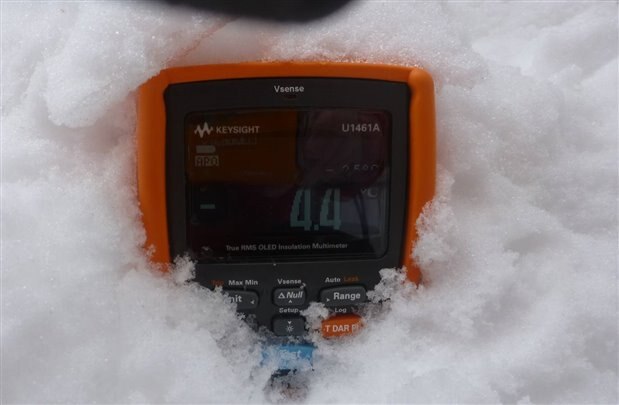

In the testing I left it in the snow drift for about 4 or more hours

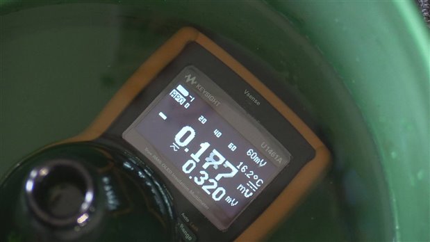

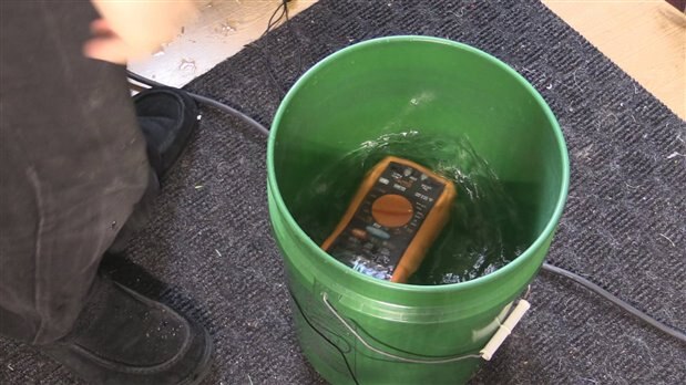

then brought it back into the house and dropped it into the bucket of warm waterimage
and a bit of water boarding, Honest, it didn't complain, if anything it was more of "Is that all you got pal...!", really, i can hold its breath for over an hour and still keep smiling, can you?

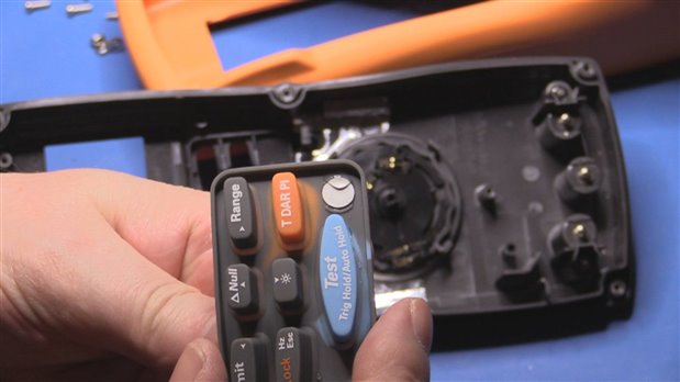

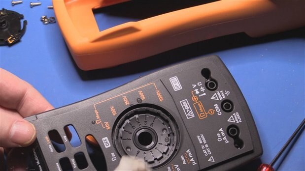

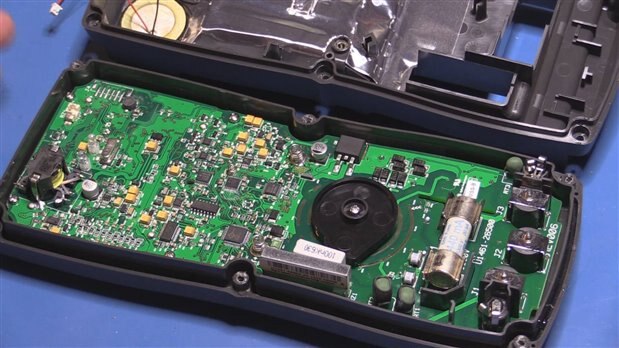

So of course in order to have the last laugh, I had to dissect it to see what made this all possible
Still it laughs in the face of the supposed torture, so what else was I to do but go further to see what made this thing so resilient to my tactics
Now I'm starting to learn its secret, its into Rubber, well Rubber is more in it to be correct, an abundant use of silicone rubber seals and gaskets sealing all possible points in ingress to the innards of the meter along with moulded in connectors (Banana Sockets) and more Silicone gaskets on the range dial sealed the deal. (Did you see what I did there... Did ya, "Sealed the deal ", no, ok, never mind image )
So, after hours and hours of being buried neck deep in snow in sub zero temperature, water boarding and attempted drowning the meter won out, I gave up, it passed all the tests I was willing to throw at it without assuring its ultimate demise (I have to finish the road test after all). It passed with flying colours and I was a happy camper
