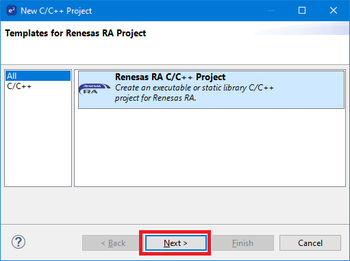

Creating e2studio FSP project

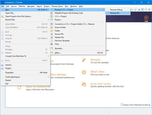

At startup you will see startpage. You can create new project by clicking File > New > Renesas C/C++ project > Renesas RA.
New dialog window will appear. Confirm first page by clicking Next.

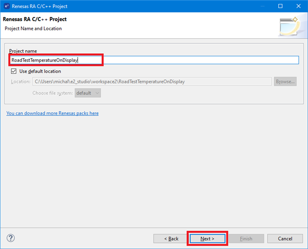

Enter some project name and confirm by Next.

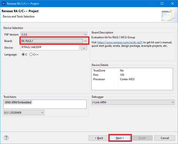

At next page you need to select used development board. Then you can confirm dialog by clicking Next.

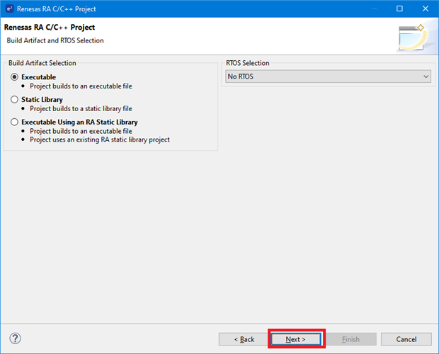

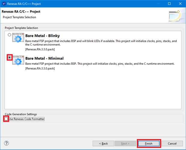

In this tutorial we will create standard executable application and we will not use any RTOS. So, just confirm dialog by clicking Next.
At next page select Bare Metal – Minimal as a template. I recommend unchecking Use Renesas Code Formatter every time when you want to use custom code formatting configuration instead of code formatting rules provided by Renesas. Finally, confirm dialog by clicking Finish.

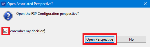

If you get asked about opening FSP Configuration perspective, confirm dialog by Open Perspective. You can also check Remember my decision if you are bored by this dialog.

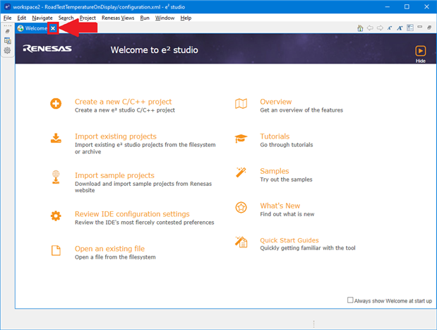

Now, close the start page.
Now you are seeing FSP configuration page. When you close this page, you can reopen it again by clicking configuration.xml in Project Explorer. This page is very important because It install selected drivers provided by Renesas to your project and generate lot of configuration structures for you. Before we start configuring this page, I also recommend doing some modifications in project setting.

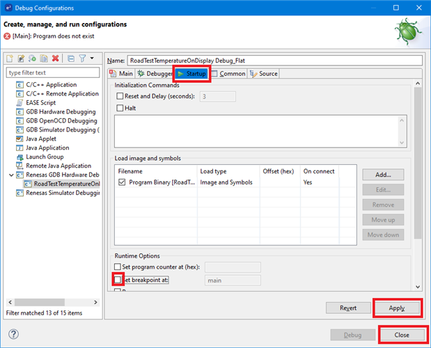

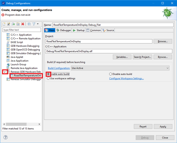

The first thing which I like to reconfigure is debugging configuration. The default configuration does not compile code on pressing debug button. It also always set breakpoint at both reset handler and main function. Finally, the last thing which I recommend reconfiguring is optimalization level. By default, project compiles code with optimalizations -O2 which makes debugging hard, so I recommend reconfiguring it to -O0 or -Og. All of these modifications are optional and you can use default settings if you like it.

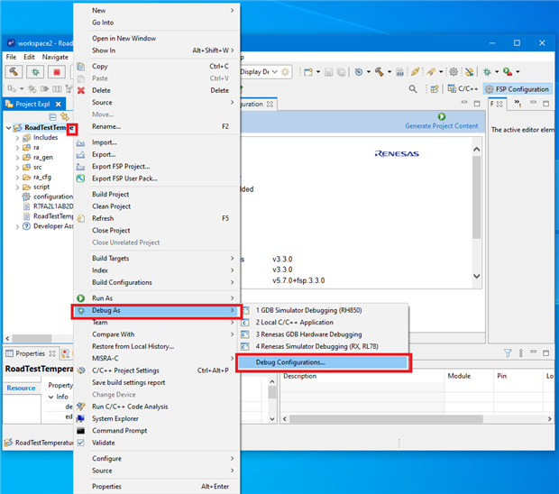

Right click the project in the Project Explorer and click Debug As > Debug configurations …
Select configuration with the same name as project name in Renesas GDB Hardware Debugging section. Click Enable auto build on main page of this configuration.
Then go to Startup tab and uncheck Set breakpoint at main. Finally confirm dialog by clicking Apply and Close.

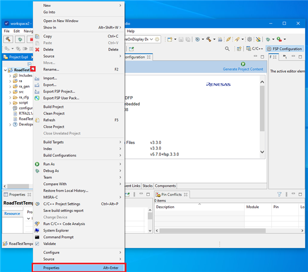

The right click project again and click Properties.

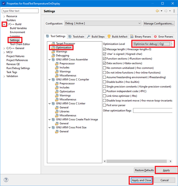

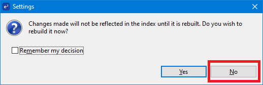

Expand C/C++ Build section, click Settings section, switch to Optimization section in pane content and change Optimization level to Optimize for debug (-Og). Then confirm dialog by clicking Apply and Apply and Close.
When you pressed apply button you most probably received message that you need to rebuild project. You can click Yer or No. It does not matter now.

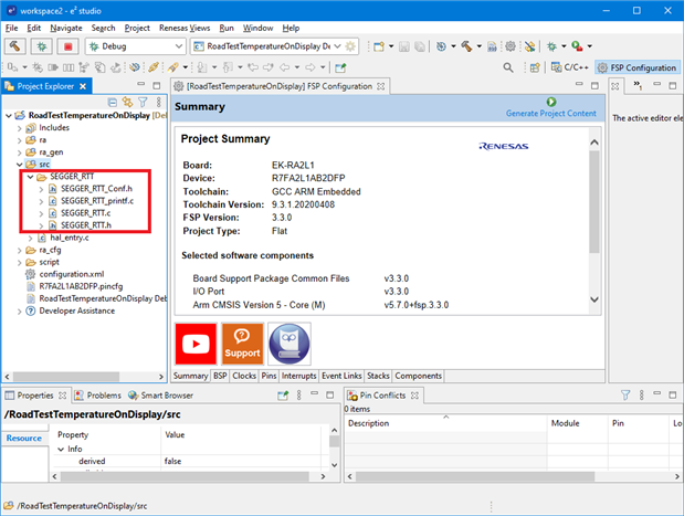

Integrating SEGGER RTT

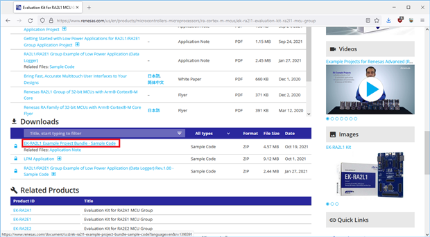

Before we start writing any code, I recommend integrate SEGGER RTT “library” to the project. SEGGER RTT is used for printing debugging messages in a more performant way than using UART. We can use this feature because EK-RA2L1 board has onboard SEGGER J-Link debugger which supports this kind of transports. e2studio do not include required library in projects created by template which we have used. You need to go to the EK-RA2L1 main page and download EK-RA2L1 Example Project Bundle - Sample Code. Downloading this file requires registration at Renesas website.
Then you need to unpack downloaded ZIP and open src folder of any available example. For example, open ek_ra2l1\iic_slave\iic_slave_ek_ra2l1_ep\e2studio\src. Then you need to copy whole SEGGER_RTT folder to src folder of your project in Project Explorer in e2studio. You should see following new 4 files in Project Explorer.

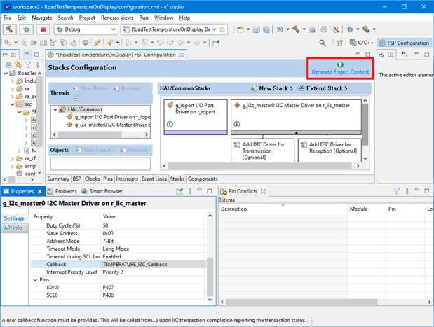

Adding and Configuring I2C Driver

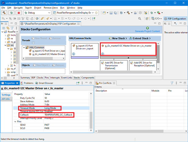

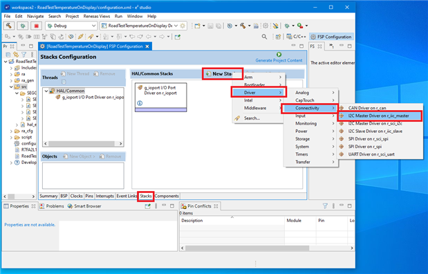

The first feature which I will implement is communication with I2C Temperature sensor. The first task which we need to do is adding I2C driver to the project. At FSP Configuration page go to Stacks page, click New Stack, then select Driver > Connectivity > I2C Master Driver on r_iic_master.
The new stack will appear. Go to Properties window and change Timeout Mode of the newly created stack to Long Mode and Callback to the TEMPERATURE_I2C_Callback. Callback is name of the function which we will create later and is used for passing events from driver to your code.
Now we have included and configured driver. Now you can press green Generate Project Content button.

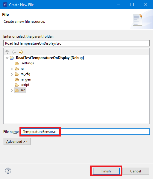

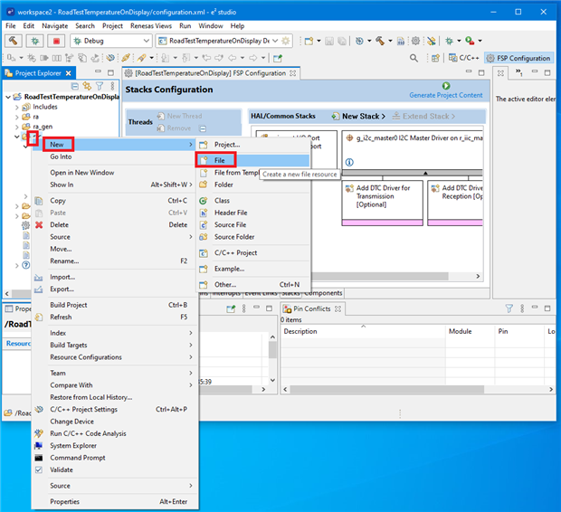

Next step is creating source files for our code. Let’s create TemperatureSensor.c and TemperatureSensor.h files in our src folder. Right click the src folder in Project Explorer, select New and then click File.
Set File name to TemperatureSensor.c and confirm by Finish.

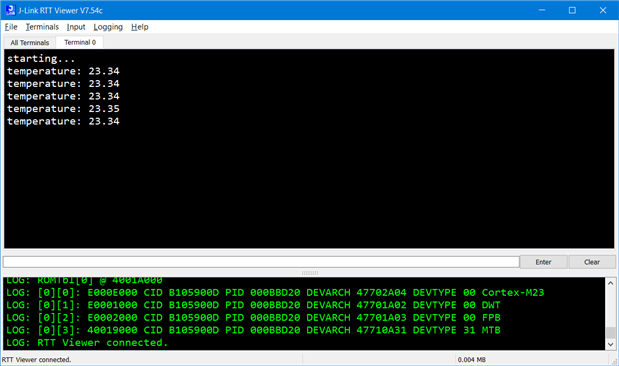

and finally in inifinite loop we can read temperatures and print them to debugging output. SEGGER_RTT_printf function has no support floats so we need to use a little trick for receiving part before and after decimal dot.
while (1) {
    float temperature;
    status = TEMPERATURE_ReadTemperature(&temperature);
    if (status != FSP_SUCCESS) {
        SEGGER_RTT_WriteString(0, "Error while reading temperature\r\n");
    } else {
        int temperature100 = (int)(temperature * 100);
        SEGGER_RTT_printf(0, "temperature: %2d.%d\r\n", temperature100 / 100, temperature100 % 100);
This is all. You can press debug button. Open J-Link RTT Viewer (which you can download from SEGGER website), connect to the target and see outputs from your application. You should see something like following screenshot. In second part of this tutorial, I will implement driver and small library for controlling display and make final project showing temperature on display instead of showing it in debugging output only.
