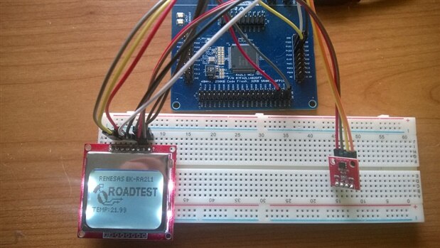

Writing Nokia 5510 SPI Display Driver
In the next section we will create second driver. I will show implementing double buffered display driver. I will allow user to draw bitmaps and texts to the display buffer. When the user finish screen, driver will switch buffers and transmit previously filled buffer to the display. I will transfer buffer to the display on background using DMA (It is referred as a Data Transfer Controller (DTC) on the RA2L1 platform). This means that at the time of transferring buffer to the display user can run its own code. For example, user can read temperature from HTU21DHTU21D sensor and/or fill second buffer with next screen while transfer is in progress. This is reason why we need two buffers – one available to user and second which do not change while transfer is in progress.
Nokia 5510 display is connected using unidirectional SPI bus with added D/C signal which identifies commands from pixel data. MISO wire is not used because display do not produce any output. We will manipulate D/C signal manually. Similarly, we will manipulate reset signal of display manually.

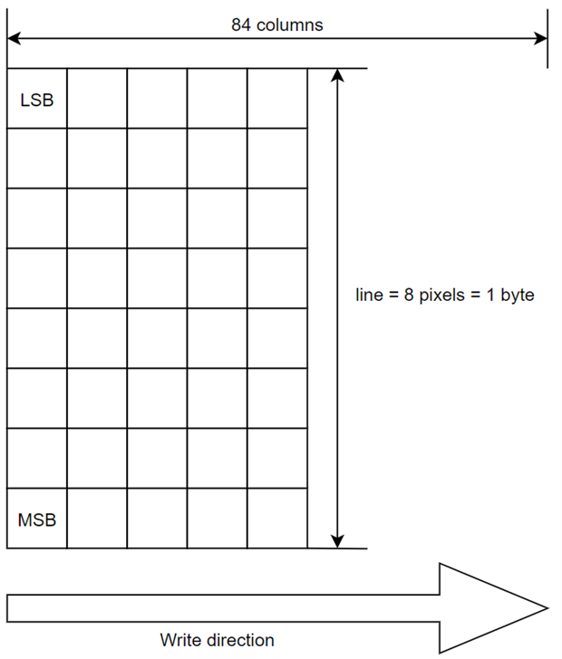

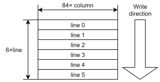

Display is structured to the lines. There are 6 lines. Each line has 8 vertical pixels in a column. So, display has 6 × 8 = 48 pixels in column. Display width is 84 pixels. Totally there are 48 × 84 = 4032 pixels. Because every pixel is encoded using single bit (display is black and white only), so we need buffer of size 4032 / 8 = 504 bytes. It is small display but still very useful and frequently used in many hobby projects. Display structure looks as follows:
Display holds row and column counter. When transferring data to the display we need transfer first line first, then we can send second line and so on. The structure of the single line is following:
The pixels are transmitted in columns. The first transferred byte describes content of first column in active row. So, data are not transferred row by row, but they are transferred as (8 pixels) columns of active line. This can look scared at the first time, but it is useful when drawing texts because texts are usually drawn per line. I will also draw bitmap in this tutorial. I must take this structure in account when encoding bitmaps. The minimum transfer unit is 1 byte, so you always need to transfer whole column of one line. The display holds line and column pointer. Every time when you do transfer it increments column pointer. If column pointer overflows the columns, then pointers are adjusted to the next line.

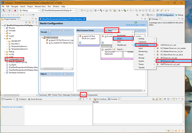

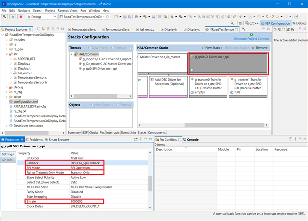

Adding SPI Driver to the project

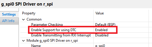

Open configuration.xml file. Go to Stacks tab, then click New Stack and select Driver > Connectivity > SPI Driver on r_spi in the menu.
Then click the newly created stack, go to Properties window, change Callback to DISPLAY_SpiCallback, SPI Mode to SPI Operation, Full or Transmit Only Mode to Transmit Only Mode and reduce Bitrate from 16 MHz to 2 MHz (2000000).
That is all. Now we can start code our double buffered driver.

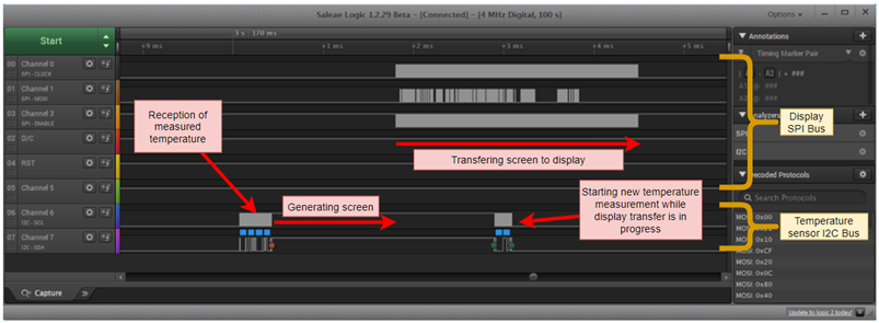

And now we must start DMA transfer. DMA Transfer will transfer specified buffer to the SPI peripheral at background. Starting DMA Transfer is done very simple using R_SPI_Write. In fact, we already used DMA transfers in DISPLAY_Command function. In this function we have called R_SPI_Write function for transferring (one) byte to the display. This function started DMA transfer at the background, and we have waited to the completion of transfer in the while loop after the call. This time we will do it differently. We start DMA transfer using R_SPI_Write and then we will not wait until it completes. We will let DMA transfer running at background and we will continue running our code. We must handle state that second transfer is triggered while previous one is in progress. We will resolve that in a way that we will wait before (not after) R_SPI_Write call until previous DMA transfer completes. Note that we must also prevent calling DISPLAY_Command while transaction is in progress because DISPLAY_Command internally starts another transfer.
So, next step is wait to completion of previous transfer. You need add following snippet before first DISPLAY_Command(0, 0x80); which you have written as a second step of DISPLAY_Commit function.
while (isTransferComplete == 0) {
      R_BSP_SoftwareDelay(1, BSP_DELAY_UNITS_MICROSECONDS);
Then we can go back at the end and start new transfer. We need to reset complete flag from previous run, calculate address of correct buffer to transfer and then transfer it.
isTransferComplete = 0;
uint8_t* buff = displayBuffers + transmitBuffer * DISPLAY_BUFFER_SIZE;
status = R_SPI_Write(&g_spi0_ctrl, buff, DISPLAY_BUFFER_SIZE, SPI_BIT_WIDTH_8_BITS);
if (status) {
      SEGGER_RTT_printf(0, "R_SPI_Write failed.\r\n");
      return status;
After issuing this command we can return success.
return FSP_SUCCESS;
This is all. You may think that you have not seen any DMA transfer yet. It is because DMA transfer (on RA2L1 platform is referred as a DTC instead of DMA) are hidden inside library. It works out of box. This feature is enabled in default and it is very useful. If you for some reason need SPI Driver to do not use DMA transfers at background, you can disable it in properties windows of SPI Driver stack.

Results
You can press debug button, connect display and sensor to pins defined in configuration.xml and you should see something like this on display:
Verifying DMA Transfers
Last thing which I want to show is that DMA transfer really works. I am showing it because from the code it was not clear that any DMA is used. I looked what is happening on the buses using logic analyser and I have seen following data. I added some notes to clarify what is going on, but you can see that at some point there are two bus operations (SPI managed by DTC and I2C managed by user code) at the same time, so DMA transfer really work.
