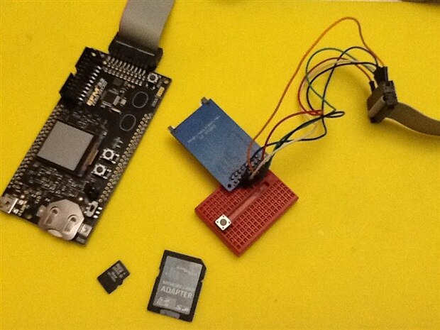

After I finished my RoadTest review of the Zero Gecko starter kit, I still had some functionality that I want to try out. One of them is SPI support.
I have an SD card breakout board in my toolbox. That's what I'm connecting to the starter kit.
Simplicity Studio comes with an application note that explains interfacing Gecko to SD Cards. That AN0030 comes with an example for several kits, but not for the Zero Gecko.
I'm porting that example to my starter kit.
My first naive attempt was to start from the application note and try to change that to the Zero Gecko. I haven't succeeded to create a source case that compiles from that exercise.
So I decided to take a different approach. I Created a new project based on the ZG Blinky example. I knew that one compiles without issues image.
Then I morphed that into a working SPI example by taking the Serial Peripheral Interface (SPI) Example from eewiki.net.

I was pleasantly surprised that this simple trick already resulted in a 2-way communication with the SD Card:
Then I moved the SILabs AN0030 main file's code over to that example, and worked on getting the right pins addressed.
Step by step I removed non-applicable code, added header and include files, made small mods, resolving one build error after the other.
The code that I removed was related to development kit specific (BSP) calls. The remaining tasks were to find additional .c and .h files in the Simplicity Studio install folders and add them to the project.
The toughest one to resolve was a 'region RAM overflowed with stack' error. There was a solution documented for the Tiny Gecko on the SILabs forum. This solution works for the Zero Gecko too.
I had to alter line 17 in the ffconf.h file in the reptile/fatfs/inc folder:
#define
_FS_TINY 1 /* 0:Normal or 1:Tiny */
/* When _FS_TINY is set to 1, FatFs uses the sector buffer in the file system
/  object instead of the sector buffer in the individual file object for file
/  data transfer. This reduces memory consumption 512 bytes each file object. */
All is well that end well. My example compiles and I have successful communication with the SD card. Here's the capture of the SPI communication:
and the SPI protocal analysis:
The project is available in the archive attached to this post.
