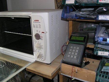

  • KennyMillar
    KennyMillar over 16 years ago in reply to e14 Contributor
    I successfully use a toaster oven for small numbers of hand made boards, and use hot air for re-work.
    I find hot air for assembling boards to take longer and be more error-prone - especially with fine pitch components, but I guess it depends which tools you are using - everyone's experiences will be different.
    PCB-Pool is a good place for getting boards made, they are always excellent quality and for the time being pool orders come with a free SMT stencil, but there's no guarantee how long that offer will last. However they are a bit on the expensive side, and their VAT rate is 21% and you need to pay in euros so my bank charges me an 'oversees' fee and a conversion commission on each payment too. I wish they would open a UK office-even if it was just for billing and payments.
    e14 Contributor over 16 years ago in reply to e14 Contributor
    Hi Robert,
    Toaster oven reflow is also a possibility indeed. But in my opinion an oven is required only if you start to do production batches so for prototyping a handheld hot air is enough. If you want to do multiple boards at the same time an oven is a must (unless you have no time constraints).
    Tricky parts are of course connectors like for microSD cards as they have plastics so you have to adjust the temperature to lower setting usually.'
    Elias

    I finally built myself a small reflow oven using a toaster oven controlled by a Freescale MCF51AC256ACLKEMCF51AC256ACLKE processor and some triacs to switch the heating elements and a thermocouple to measure the temperature. The total material cost was around 170 euros (depending on the toaster oven), plus some work ...
    At www.pcb-pool.com you can order prototype PCBs for ca 50 euros with a free solder stencil included.
    It was really worth it, because then one switches to using all surface mount parts and the assembly is much easier and more reliable.
    Best regards
    Robert
