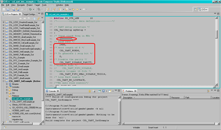

Then, I tried to run the LED blinker project but I got some errors on the compilation process. It turned out that I needed to set some paths in order to “help” the IDE find some additional files (headers and libraries).

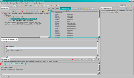

The LED blinker was the first project to be run onto this board. I have started a debugging session for the real target and also for the functional simulator
Debugging with the real target
The debugger is built around a FTDI chip (FT2232D) and its speed is limited to only 12Mbps. This makes it a little bit slow in the debugging/program loading process. More on the debugger later…
The total execution time for the project was around ~35seconds (having the PLL set at 100MHz by the GEL file)

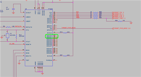

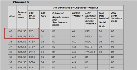

-         One of the things I would have liked to see was the USB signals tied at the expansion connecter. This would have offered some broader portfolio of possible application with the 5505 DSP
-         The expansion connector is not a standard one. The pair connector is: SAMTEC - MEC1-130-02-S-D-NP-A

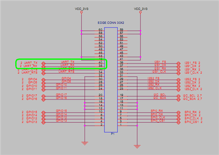

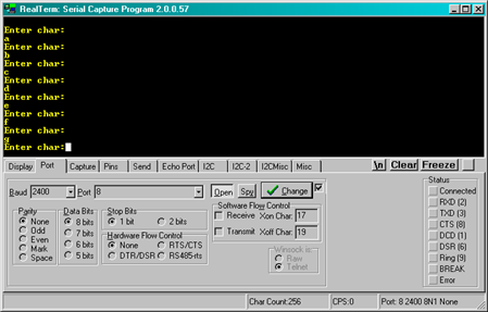

-         USB-UART converter not used

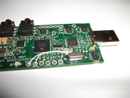

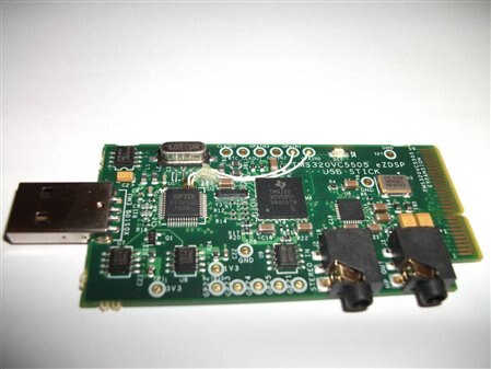

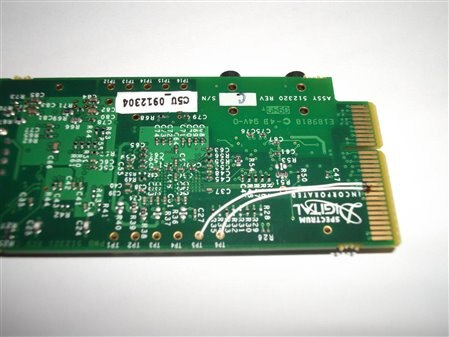

o       The UART pins are not tied with the Rx/Tx into the FTDI chip. This would have offered support for USB-serial port. I will try to connect the Rx/Tx UART pins from the spare FTDI channel B adapter to the UART pins of the DSP onto the expansion connector

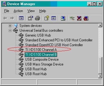

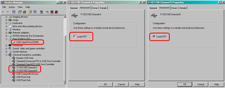

The debugger is built around an FTDI device (FT2232D). This chip is a composite device and it presents 2 interfaces. One of the interfaces is used as a USB-serial port, while the remaining interface is used as an USB-JTAG adapter. Both of the interfaces are using 2 bulk endpoints each. This is important to know because the available USB full-speed bandwidth is split between the JTAG “interface” and the USB-serial port.
Channel A is used as JTAG, while channel B is used as USB-serial port emulator. When clicking on any of the devices there’s a choice of designating any of the channels as either USB-serial port or USB-JTAG interface.

    The new Rev D has the UART pins (Tx, Rx, RTS and CTS) connected to the right pins on the FTDI chip, so you don't need to solder additional wires as I did on my Rev C board. image

    Since my previous post, I was able to create a framework for audio signal processing. I've used the CSL (Chip Support Library, provided by TI) to setup the audio codec and exchange 16-bit samples using DMA mechanisms in order to offload the DSP on the audio samples processing.
    The framework offers a simple interface for audio signal processing projects, so it can be used as a starting point.
