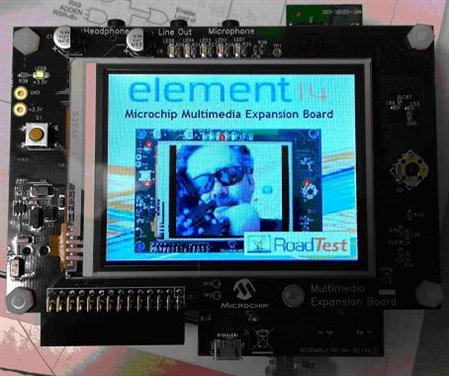

The QVGA (Quarter-VGA … resolution is 320 x 240 pixels) touch screen display looks quite good (once you remove the protective plastic ;-) ).  I used the Microsoft Paint program to crop & resize my test image to exactly 320 x 240 before I added it to my test project. (See image P.1)
I was able to load the pre-compiled demos without a hitch (which were pretty impressive).  Once I was done playing with the demos, I was ready to try out some of my own ideas.  First, I experimented with modifying some of the demo code (simple things such as, modifying colors & text).  Next, I tried to use the MPLAB project wizard to start from scratch … also; I tried the Graphics Display Designer plug-in for MPALB.  This is a quick way to ‘draw’ your interface and have the software generate the code (at least the bulk of it).  I was able to add buttons and text quite easily; however, when I attempted to load a custom image I ran into some problems.  (Again, I was trying to run before learning to walk.)  After reading the documentation more carefully, I was able to overcome the obstacles before me.  It would be helpful to have a pre-flight checklist similar to the one in Lucio De Jasio’s excellent book:  Programming 32-bit Micrcontrollers in C: Exploring The Pic32 .
