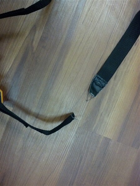

While examining the noise in the electrical system of my 2007 Toyota Highlander (with and without filtering capacitor) The Supplied neck-strap broke and the device fell 3 feet...there is some minor scuffing, however the rubberized case absorbed the impact well. I was rather dissatisfied that a $3000 piece of equipment was shipped with such a cheap strap; in addition to being physically weak (poorly designed seam between strips of fabric) it feels cheap compared to the actual handheld unit. On another note: I would have loved to see neoprene used to make the strap more comfortable, in an un-collared shirt it can chafe a good bit around the neck…while on the subject of straps the hand strap, when adjusted to accept a larger hand, does not have sufficient strength. On multiple occasions the velcro has released and thus i nearly drop the device.

    bodgy over 14 years ago
    A very thorough review, some photo shots of the strap that caused you problems would have been nice and other photos which of course didn't compromise confidentiality .
