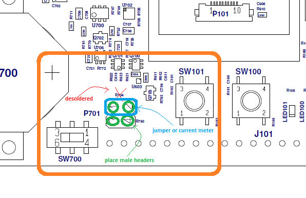

I've checked the different energy modes.
Road Test 2: measure power consumption during various modes
The starter kit comes with several energy mode examples. I've tested two of them.
The energy example: this project switches between clock frequencies (7, 11, 14 and 21 MHz) every few seconds. It displays the voltage and currency stats of the USB supply on the LCD. The power monitor works exclusively when the PWR selection switch is in DEBUG position.
The emode example: this one prompt for the desired energy mode and keeps running in that mode once selected. This exercise is handy when you want to do measurements in a stable state. These options are available:

    I monitor the current with the Energy Profiler and with a µCurrent. To be able to measure current, I desoldered R704 and populated P701 with male print headers.
    When not measuring, I bridge pin 1 and 2. When measuring, I put a current meter between pin 1 and 2.
