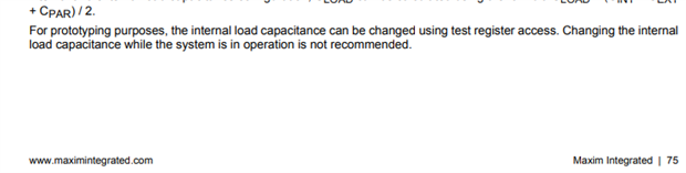

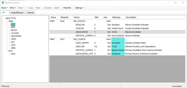

I am currently having an issue reviewing the MAX77714 EVK where the 32k XO isn't running. Its not really a hardware issue as I can get the XO to run just with the capacitance of 2 10x scope probes. The issue has to do with configuring the PMIC to enable its on die load capacitors for the 32k oscillator.

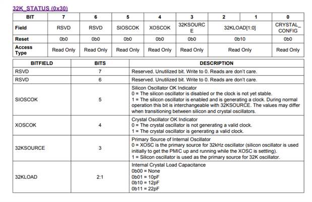

I can't even try to enable the load capacitors because the evaluation software doesn't have the correct register map for the PMIC. The evaluation tool locates the 32KLOAD bitfield in register 0x31:
When actually the bitfield is in register 0x30 (from the datasheet: https://datasheets.maximintegrated.com/en/ds/MAX77714.pdf ):
Actually as I write this, even if the 32KLoad register was addressed correctly in the evaluation software it is readonly so I still wouldn't be able to change it. So why isn't it booting with a value of 0b00 instead of 0b10? Wrong OTP config?

    No worries. Maxim missed it too!
