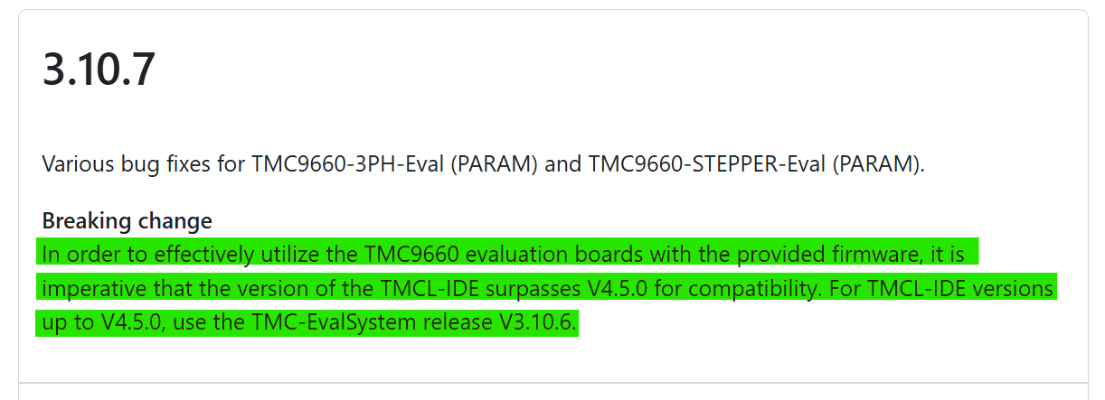

    I have updated the firmware with LandungsbrueckeV3_v3.10.5_BL.hex but it is still not working. But it is not showing any error.
  • beacon_dave
    beacon_dave over 1 year ago in reply to manojroy123
    Support for TMC9660-3PH-Eval only appears to have been added in V 3.10.5
    You need to update the firmware.

  • beacon_dave
    https://www.analog.com/en/resources/evaluation-hardware-and-software/evaluation-boards-kits/tmc9660-3ph-evkit.html#eb-gettingstarted
    https://github.com/analogdevicesinc/TMC-EvalSystem/releases?page=1
    Looks like you may have old firmware on the Landungsbruecke board that does not support the current TMC9660-3PH-EVAL board
    as it only appears to have been included since the v3.10.5 firmware
    How can I update the firmware of a Trinamic product?
    https://ez.analog.com/motor-control-hardware-platforms2/w/documents/18637/how-can-i-update-the-firmware-of-a-trinamic-product

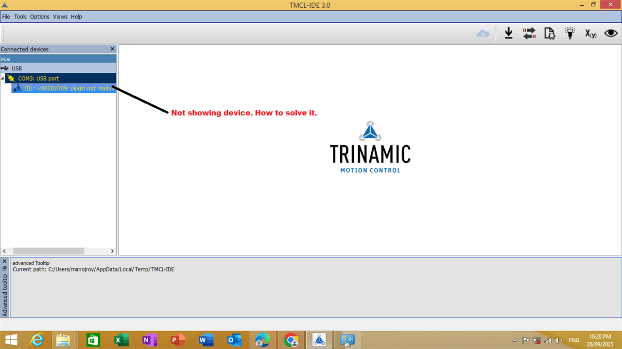

    Do you want to share the full error message? It looks like it's cropped out on the right hand side there.

    manojroy123 over 1 year ago
    How to solve the error in red label.
