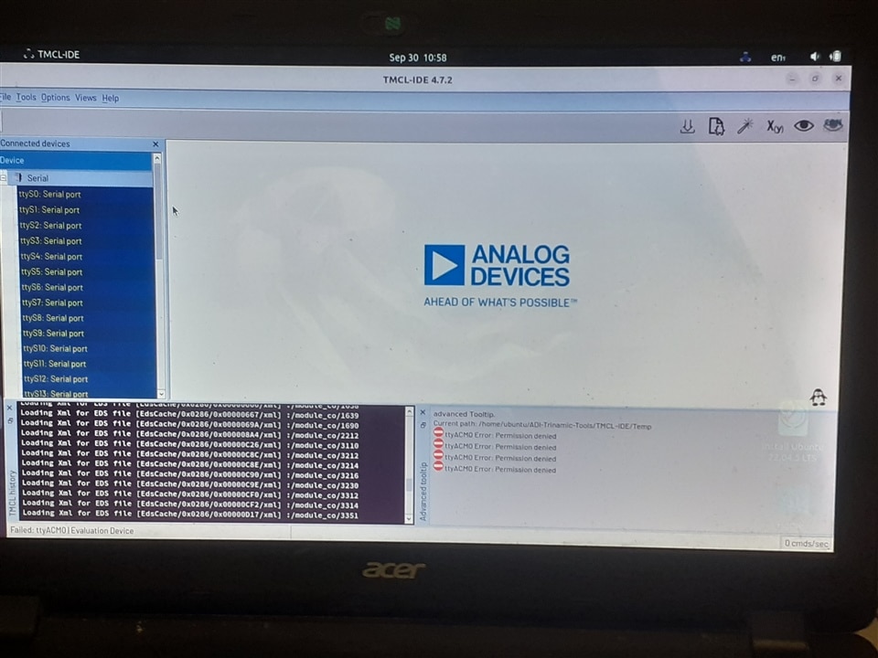

I am trying to install TMCL-IDE for windows. I am getting this error. Please help me in solving it.

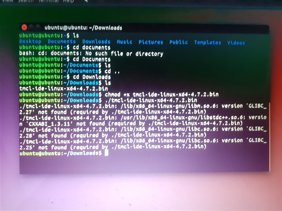

    How to solve the above error for TMCL-IDE 4.x in ubuntu 16.04

    cstanton 1 month ago in reply to manojroy123
    That looks like the driver is installed, otherwise it would have an ! next to it (exclamation mark). So communication with the serial chip is working, but going by the other comments, it's the communication beyond the serial chip.

    obones 1 month ago in reply to manojroy123
    It would have been so much nicer to select the text and paste it here.
    Anyway, this is telling you that it needs GLIBC 2.25 which is quite old.
    I mean, on two systems I have here, it's 2.35 and 2.42  and you can see the time line there: https://sourceware.org/glibc/wiki/Glibc%20Timeline
    The 2.25 version was released in 2017, so there is no surprise here that you don't have it on a recent system.
    They should really release the sources for the tool so that you could recompile it with your version of GLIBC even if I doubt this would work "out of the box" anyway

  • manojroy123
    manojroy123 1 month ago
    How to solve the above error. I have connected the board to the PC.
    dougw 1 month ago in reply to manojroy123
    I'm not sure if this is relevant, but when I was using the software it was very picky about which characters I could use in file names and directory paths. Maybe try eliminating spaces and punctuation from the path.
