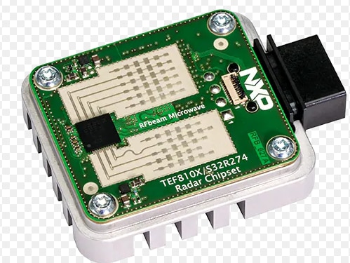

  • scottiebabe
    scottiebabe 1 month ago
    https://content.redpitaya.com/blog/how-to-build-a-diy-fmcw-radar-with-red-pitaya-complete-student-guide
    • Vote Up +5 Vote Down
  • robogary
    robogary 1 month ago in reply to scottiebabe
    I'd like to strap one of those on my bumper and watch the cops go nuts.
  • JWx
    JWx 1 month ago in reply to robogary
    typical sport exhaust...
  • scottiebabe
    scottiebabe 1 month ago in reply to robogary
    Looks farm more exciting than the current modules...
