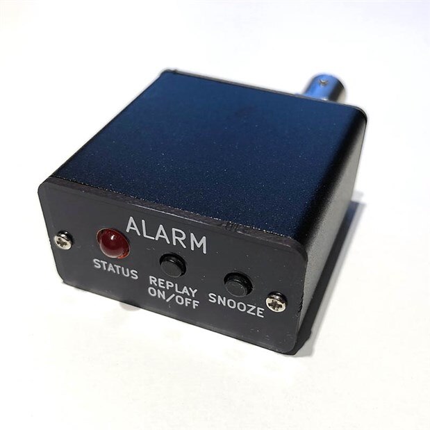

    fmilburn over 7 years ago
    A bit of extra care with the enclosure and user interface can give a finished and professional look to a project.  In the example below a PCB was designed and used as a faceplate.

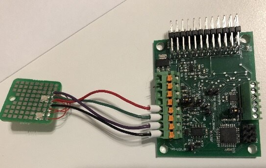

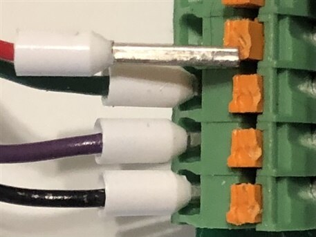

    genebren over 7 years ago
    Clean connections into terminal blocks.
    To keep wire ends from fraying and bending, I like to use wire crimp ferrules (like:  https://www.newark.com/weidmuller/0462900000/terminal-ferrule-18wg-crimp-white/dp/17M8275?st=Connector%20ferrule ) to provide quick and clean connections into terminal blocks.  This allows me to quickly setup a test of my boards against an environment that simulates the customers setup.  These ferrules crimp to the wire ends to make insertion simple.
