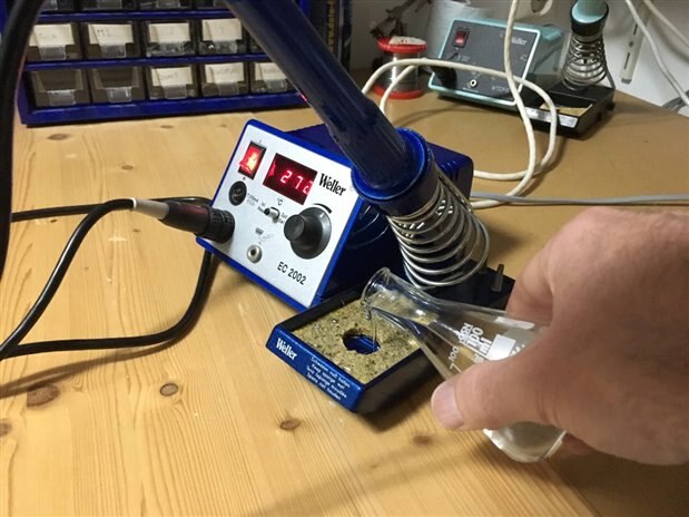

    gpolder over 7 years ago in reply to littleben1
    fully agree, and connected to that, if you are far from a water tap, keep a small bottle with water close by, for watering the sponge.

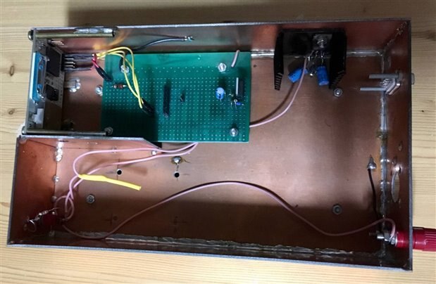

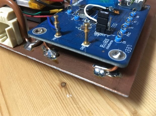

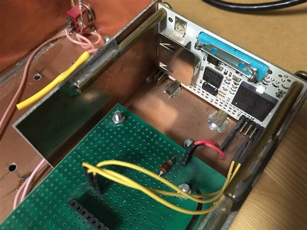

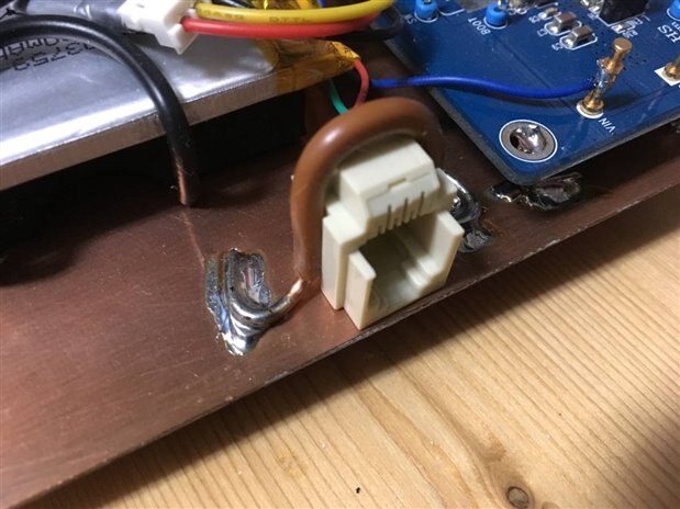

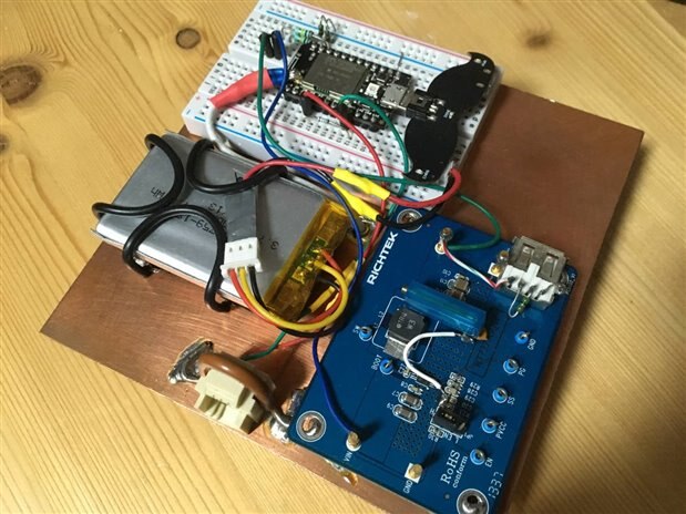

    Prototyping:
    For prototypes, copper-coated laminate board (base material of PCBs) is indispensable. You can easily solder parts or other plates, it is easy to drill or saw, you can make housings, even front plates. Moreover, it gives a good ground plane and or shielding for RF experiments.

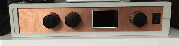

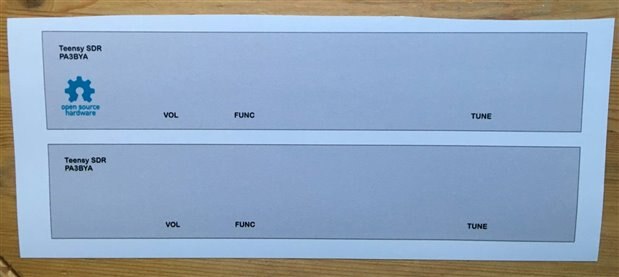

  • gpolder
    gpolder over 7 years ago in reply to gpolder
    Regarding the copper clad front plates mentioned above, They don't look nice, therefore I make a drawing of the front-plate, and let it print on vinyl stickers which I glue over the copper clad.

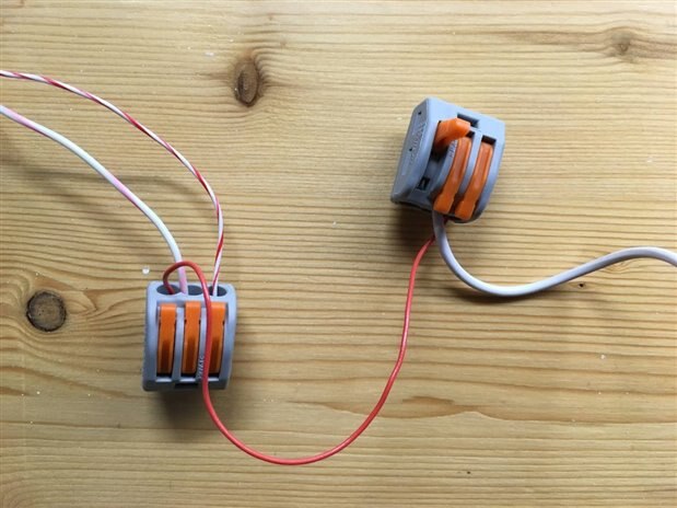

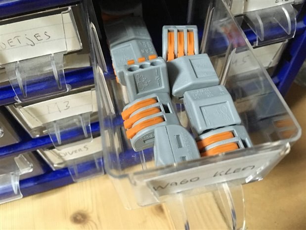

    Connections:
    For making temporary connections WAGO clamps (Product LinkProduct Link) are indispensable:

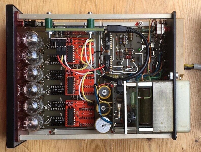

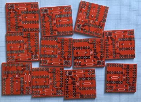

    PCB making:
    If your circuit has identical sections, it's much cheaper to make small PCB's of these sections in stead of putting it all on one PCB.
    An example of three I/O extenders spread over three small boards can be found in my up cycled Nixie display project. ([Upcycle It] Nixie Display #7 - Interface PCBs )

    mcb1 over 7 years ago in reply to gpolder
    At work we use one of those one time use water bottles....(you know the ones that people buy from a shop because they don't think our beautiful tap water is worth drinking.)
    However wet sponges is a good way to destroy tips, and I have changed to the brass type dish scrubbers from your local supermarket or other retailer.
    They are a dollar or so each and IMO do just as good a job.

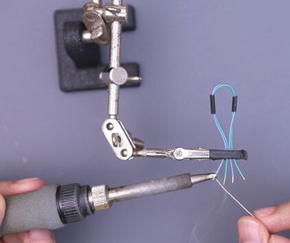

    luislabmo over 7 years ago in reply to dougw
    Nice tip Doug!. Another one is to add heat-shrink tubing to third hands, this improves their grip and reduces the chances of getting permanent marks on some objects, like when grabbing wire.
