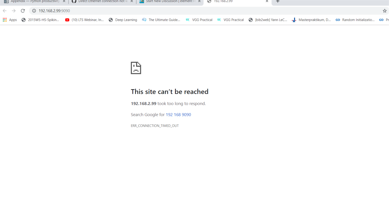

Everything was working fine, I could access the notebook on 192.168.2.99 as mentioned in the getting started.
Then this happened:
1) I connected my board to a router for internet access - changed my mind and disconnected it from the router and connected it to my laptop's ethernet port (my laptop already has a static IP as described in the getting started)
2) I simply removed the power, without turning OFF the power button on the Pynq and plugged it back in. Pynq booted, lights flashed.
3) Cannot connect anymore to 192.168.2.99
What did I break? Please help me how to fix this.

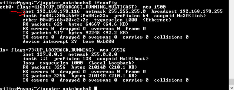

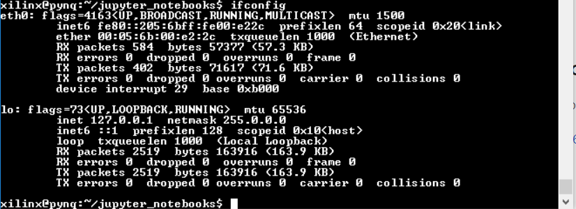

    I connected a serial terminal and this is what I see:
    This is strange - the inet (ipv4) IP does not appear at all for eth0 in this case.
    Now, look at this:
    Here we can see the IP : 192.168.178.116 assigned for ipv4, instead of the promised fallback address of 192.168.2.99 for the jupyter notebook.
    However, even this address does not work!!!!

    Okay, I don't know what was the problem, but flashing a new image to the SD card fixed it
