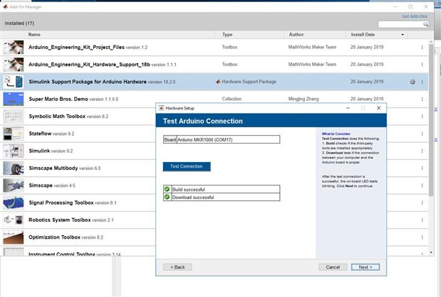

  • Hi shabaz,
    MATLAB Add-Ons is the default folder generated. And not a folder I chose. I also had a thought that it is a space problem but removing the space manually does not work.
    If it is a bug then its a relief because I have been working on it for last 2 weeks like crazy without much success. I am not sure about it so I have raised the issue in the Matlab arduino forum also

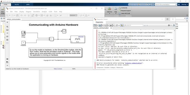

  • Hi Anurag,
    The error is still present, so somewhere some file still believes the folder name is unchanged, see this snippet:
    -IC:/Users/anurag/AppData/Roaming/MathWorks/MATLAB Add-Ons -
    (As you can see, there are no speech-marks, and there is a space between MATLAB and Add-Ons).
    Was MATLAB Add-Ons a folder name that you chose, or was it a folder name that the software installation defaulted to?
    If the latter, then it is a bug that needs to be raised. Otherwise if it is the former, then a reinstall of at least part if not all of the environment is needed, and delete the folders manually too, if they are not deleted as part of the uninstall.

  • Hi Anurag,
    With gcc the best way to troubleshoot these things is to examine it line-by-line, but from bottom-up, and also top-down, until you see the error source. In this case, it seems that the problems are stemming from some folder called MATLAB Add-Ons because bottom-up reveals an error relating to Add-Ons. Although Windows allows folders with spaces, this is not advisable when using some scripts/Makefiles/code that may be multi-platform. In this case, the Makefile (or whatever Arduino or MATLAB uses) is not placing the folder name in speech-marks, so gcc will get confused because it is seeing more command-line parameters than expected.
    The solution is to not have such a folder, e.g. rename it to matlab_addons. You may need to reinstall stuff if you selected this folder name during an install, in case the path is now hard-coded in some files.
  • But I still also have issues with arduino_communication
    And I see the below error
    C:/ProgramData/MATLAB/SupportPackages/R2018b/3P.instrset/arduinoide.instrset/arduino-1.8.1/hardware/tools/avr/bin/avr-g++ -std=gnu++11 -fpermissive -fno-exceptions -fno-threadsafe-statics -c -g -w -ffunction-sections -fdata-sections -MMD -DARDUINO=10801 -MMD -MP -MF"MW_arduino_digitalio.dep" -MT"MW_arduino_digitalio.o" -Os -mmcu=atmega2560 -DF_CPU=16000000L -DARDUINO_AVR_MEGA2560 -DARDUINO_ARCH_AVR -D_RUNONTARGETHARDWARE_BUILD_ -D_ROTH_MEGA2560_ -DMODEL=arduino_communication -DNUMST=1 -DNCSTATES=0 -DHAVESTDIO -DMODEL_HAS_DYNAMICALLY_LOADED_SFCNS=0 -DON_TARGET_WAIT_FOR_START=1 -DCLASSIC_INTERFACE=0 -DALLOCATIONFCN=0 -DTID01EQ=0 -DEXT_MODE=1 -DONESTEPFCN=1 -DTERMFCN=1 -DMULTI_INSTANCE_CODE=0 -DINTEGER_CODE=0 -DMT=0 -DEXIT_FAILURE=1 -DEXTMODE_DISABLEPRINTF -DEXTMODE_DISABLETESTING -DEXTMODE_DISABLE_ARGS_PROCESSING=1 -DSTACK_SIZE=64 -D__MW_TARGET_USE_HARDWARE_RESOURCES_H__ -DRT -D_MW_ARDUINO_LOOP_=1 -DMW_ARDUINO_STEP_SIZE=100000 -DMW_ARDUINO_MICROS -D_RTT_BAUDRATE_SERIAL0_=9600 -D_RTT_BAUDRATE_SERIAL1_=9600 -D_RTT_BAUDRATE_SERIAL2_=9600 -D_RTT_BAUDRATE_SERIAL3_=9600 -D_RTT_ANALOG_REF_=0 -DCLASSIC_INTERFACE=0 -DALLOCATIONFCN=0 -DEXT_MODE=1 -DONESTEPFCN=1 -DTERMFCN=1 -DMULTI_INSTANCE_CODE=0 -DINTEGER_CODE=0 -DMT=0 -DTID01EQ=0 -DON_TARGET_WAIT_FOR_START=1 -DEXIT_FAILURE=1 -DEXTMODE_DISABLEPRINTF -DEXTMODE_DISABLETESTING -DEXTMODE_DISABLE_ARGS_PROCESSING=1 -DSTACK_SIZE=64 -DRT -DMODEL=arduino_communication -DNUMST=1 -DNCSTATES=0 -DHAVESTDIO -DMODEL_HAS_DYNAMICALLY_LOADED_SFCNS=0 -IC:/Users/anurag/AppData/Roaming/MathWorks/MATLAB Add-Ons -IC:/PROGRA~3/MATLAB/SupportPackages/R2018b/toolbox/target/supportpackages/arduinobase/include -IC:/Users/anurag/AppData/Roaming/MathWorks/MATLAB Add-Ons/arduino_communication_ert_rtw -IC:/PROGRA~3/MATLAB/SupportPackages/R2018b/toolbox/target/supportpackages/arduinotarget/arduinotargetdemos -IC:/PROGRA~1/MATLAB/R2018b/extern/include -IC:/PROGRA~1/MATLAB/R2018b/simulink/include -IC:/PROGRA~1/MATLAB/R2018b/rtw/c/src -IC:/PROGRA~1/MATLAB/R2018b/rtw/c/src/ext_mode/common -IC:/PROGRA~1/MATLAB/R2018b/rtw/c/ert -IC:/PROGRA~1/MATLAB/R2018b/toolbox/coder/rtiostream/src/utils -IC:/ProgramData/MATLAB/SupportPackages/R2018b/3P.instrset/arduinoide.instrset/arduino-1.8.1/hardware/arduino/avr/cores/arduino -IC:/ProgramData/MATLAB/SupportPackages/R2018b/3P.instrset/arduinoide.instrset/arduino-1.8.1/hardware/arduino/avr/variants/mega -IC:/PROGRA~3/MATLAB/SupportPackages/R2018b/toolbox/target/supportpackages/arduinotarget/include -IC:/PROGRA~3/MATLAB/SupportPackages/R2018b/toolbox/target/supportpackages/arduinotarget/scheduler/include -IC:/ProgramData/MATLAB/SupportPackages/R2018b/3P.instrset/arduinoide.instrset/arduino-1.8.1/hardware/tools/avr/avr/include/avr -IC:/PROGRA~3/MATLAB/SupportPackages/R2018b/toolbox/target/shared/externalmode_daemon/include -o MW_arduino_digitalio.o C:/ProgramData/MATLAB/SupportPackages/R2018b/toolbox/target/supportpackages/arduinobase/src/MW_arduino_digitalio.cpp
    avr-g++: error: Add-Ons: No such file or directory
    avr-g++: error: Add-Ons/arduino_communication_ert_rtw: No such file or directory
    gmake: *** [MW_arduino_digitalio.o] Error 1
    The make command returned an error of 2
    'An_error_occurred_during_the_call_to_make' is not recognized as an internal or external command,
    operable program or batch file.
    ### Build procedure for model: 'arduino_communication' aborted due to an error.
    Error(s) encountered while building "arduino_communication":
    ### Failed to generate all binary outputs.
    Component:Simulink | Category:Model error
