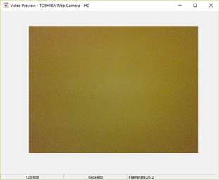

  • Road Testers - I thought everyone would enjoy seeing the help I was getting on the Mobile Rover exercise 5.5 from one of my engineering assistants.
    A webcam mounted in the ceiling is taking photos of the Rover in various positions and importing into MATLAB.
  • Can you try a different browser? This seems to be a browser related issue.

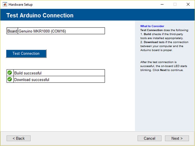

  • Hi Madhu - Sorry, it seems every bit of progress comes with alot of difficulty and new issues for me.
    1) I'm working the Simulink Tutorial 2.3, progressing to adding the motor encoder feedback to the simulink model. When I try to run the model, it errors on a bad encoder definition.
    MATLAB keeps erroring out that the encoder property inside MKR1000 is different than defined by MATLAB. I dont see anyway to change the property to satisfy the error message.
    The 'getOutputDataTypeImpl' method of the System object 'motorcarrier.blocks.mkrmotorcarrier_Encoder' for 'myDCMotorControl/Encoder' returned the data type of output port 1 as 'double'. However, the data type inferred from the MATLAB code defined in the System object is 'int32'. These data types must be the same.
    I checked and reloaded HW setup from Simulink ADD ON.
    NOTICE THIS BOARD SAYS GENUINO MKR1000 now, but when I first loaded a couple weeks ago, the BOARD read ARDUINIO MKR1000.
    I've reloaded setups multiple times, ( each try can take 3 hours to be successful!)
    Is the tool hinting a useful message when it says GENUINO MKR1000 instead of Arduino MKR1000 ?
    Is this possibly relevant at all to the SIMULINK ENCODER MODEL ERROR MESSAGE ?
    What else can be done to satisfy the encoder feedback error message ?

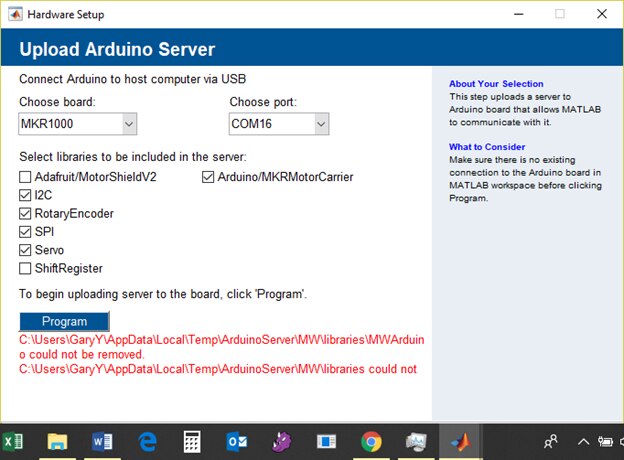

    2) I keep trying to reload the MKR1000 MATLAB interface server to confirm a remedy after performing the SIMULINK ADD ON ARDUINO comm test..
    I've tried combinations of settings and crazy things (just like I had done in the past month), but stiill continue to get the red error message that directories cant be erased. I just keep retrying for days until something aligns in the universe so it happens.
    Do these messages actually affect the server SW load to MKR1000 , or are the red messages just informational  ?
    trying via the command window:
    >> a=arduino
    Updating server code on board MKR1000 (COM16). This may take a few minutes.
    C:\Users\GaryY\AppData\Local\Temp\ArduinoServer\MW\libraries\MWArduino could not be removed.
    C:\Users\GaryY\AppData\Local\Temp\ArduinoServer\MW\libraries could not be removed.
    C:\Users\GaryY\AppData\Local\Temp\ArduinoServer\MW could not be removed.
    Please advise
