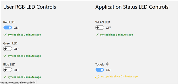

  • Hi Roger thanks for the update. I’m glad we figured out your issue.
  • Hi Brian,
    You were correct, I had the label appLED instead of appLed (force of habit) and this now all works.  I have finished the course, thanks to your help, and even won my certificate, but only scored 85.71% (even though I thought I had answered everything correctly)!
    Thanks again for a well constructed and delivered set of videos.
    Kindest regards,
    Roger

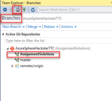

  • Hi Roger,
    The only other code change that you don't list is in main.c, I added the line below.  I suspect you have that in your project or you would have seen a linker error.  The other code changes you list look perfect.
    in main.c
    int appLedFd = -1;
    When you add the toggle control to the IoT Central Settings tab, the device twin "desired" item "appLed" is added automatically.  Can you confirm that the settings for the toggle is using the correct key value of appLed?  Case counts and make sure you don't have any leading or trailing whitespaces.
    I'm pretty sure your code changes are good, but there is a solutions branch in the gitHub project called AssignmentSolutions if you want to try that.  But I suspect that your IoT Central setting is the issue.

  • Hi Brian,
    I'm missing something here.  I have included below a screenshot of my Settings tab which shows that I am able to switch on the Red LED, but that my command to the Toggle times out.  I have implemented the code in VS which to my mind are just the 3 lines
    bool appLedIsOn = false;
    extern int appLedFd;
    {.twinKey = "appLed",.twinVar = &appLedIsOn,.twinFd = &appLedFd,.twinGPIO = AVT_LED_APP,.twinType = TYPE_BOOL,.active_high = false},
    So the missing piece seems to me to be the device twin json that you demonstrate being manually changed about 9 minutes in to the Lesson 4 video.  Should this have been updated automatically when the Toggle was added, or do I need to manually edit the json?  If so, where can I find the json?  When I look at my Azure Central webpage then I have nothing at all defined and get the friendly message "No resources to display".
    Thanks,
    Roger
  • Hi Roger,
    It's great to hear that you were able to load the IoT Central template!
    Regarding the appLed question.  In lab 4 you created an IoT Hub which you connected your device to.  It sounds like you played with the device twin for your device, awesome!  In lab 5 we create the IoT Central Application, under the covers somewhere in Azure (not visible to us), IoT Central uses an IoT Hub.  However the IoT Central IoT Hub and the IoT Hub you created in lab 4 are separate IoT Hub instances.  So if you added the {"appLed" : true | false } desired property on your lab 4 IoT Hub it will not be present in the lab 5 IoT Central IoT Hub, because they are different IoT Hub instances.
    But don't fret, it's easy to add new desired properties in IoT Central.  The way it's accomplished is by added a new item to your IoT Central Settings Tab.  If you look at the "Modify the IoT Central Application" section in the lab 5 document you'll find the instructions to add the appLed control to your new IoT Central application.
    Let me know if you have any more questions.  It looks like you're going a good job getting through the Azure Sphere Course.  I welcome your feedback on the course, good / bad / or ugly.
    Brian
  • Thanks Brian,
    this fixed the issue with the template.  I tried to do the exercise and got the code to compile, but realised quickly that it did not work because appLed was not included in the device twin JSON.  When I went back to Azure IoT Central to update this I could fine nothing.  This is unimportant, but am I looking in the wrong place or did the cleanup at the end of Lab 4 remove the device twin JSON?
    Roger
