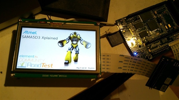

    e14 Contributor
    I got bored of looking at a blank screen while playing with my Xplained so I peeled myself away from working on my XGPIO python library while I think about the best way to implement a pin watcher and made a splash screen that comes up once the operating system has booted.
    I just saved a small bash script into /etc/rc4.d remember to name it starting with S## where ## is a number. Files in rc4.d are started in sequence so I named mine S95splashscript.sh to make sure it started after everything else, it's probably possible to move it down in order, but you need to make sure the framebuffer has initialised first. I cant find anyway of directly flipping or rotating the framebuffer display, so I had to send it a flipped picture. This is in 24bit mode, I did try in 32 bit mode but the color values seem to be out of order, you can see the image just in wrong colors? It might be a good idea to make a small script that strips the picture and feeds it backwards into the framebuffer.
    After a bit of research, it should be possible to memory map the frame buffer in python and give a greater range of control than just sending whole images across so once I'm finished with a basic XGPIO, I'm going to do some further work getting into the frame buffer image
